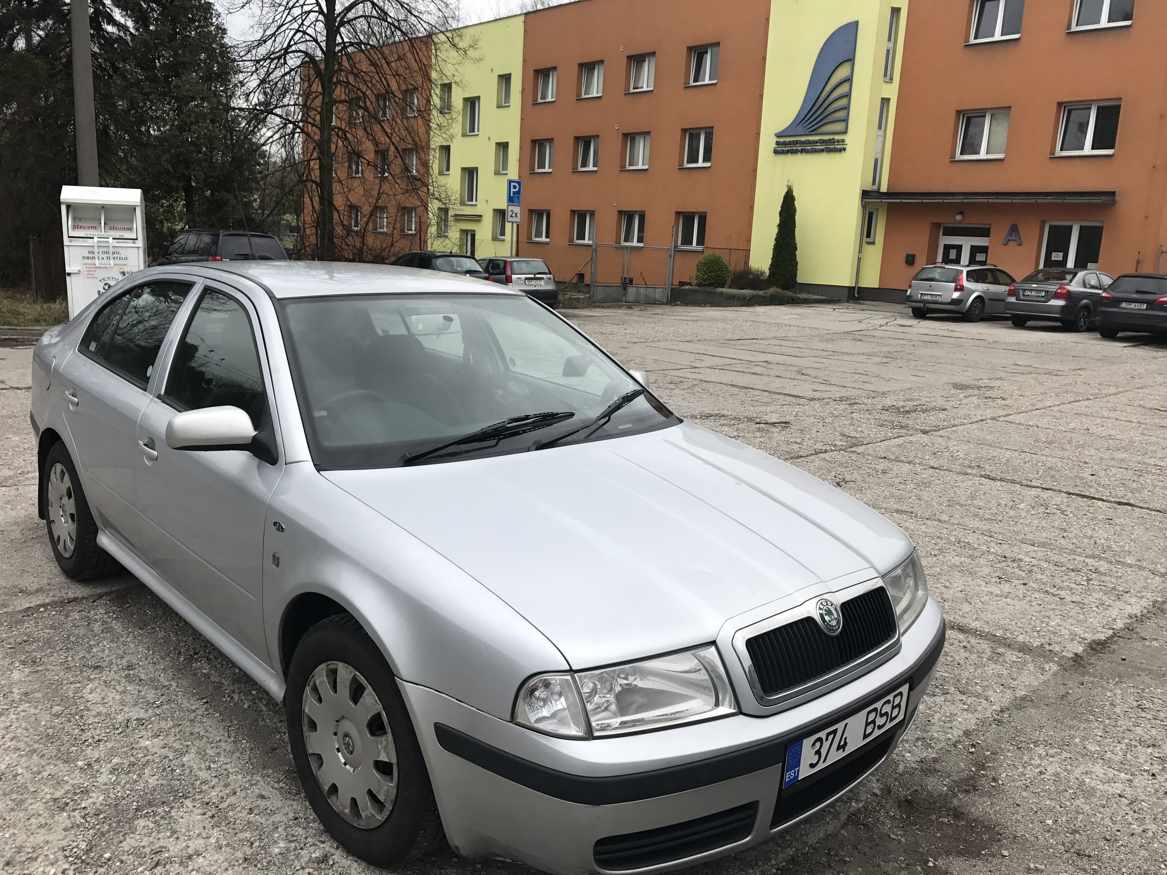

Nope, Could only find a 2008 AXR Classic, pictured below in it's native home of Czech Republic. I actually plan on buying a fully specced out 130BHP version from UK very soon, waiting for a deal to pay off before hand.
