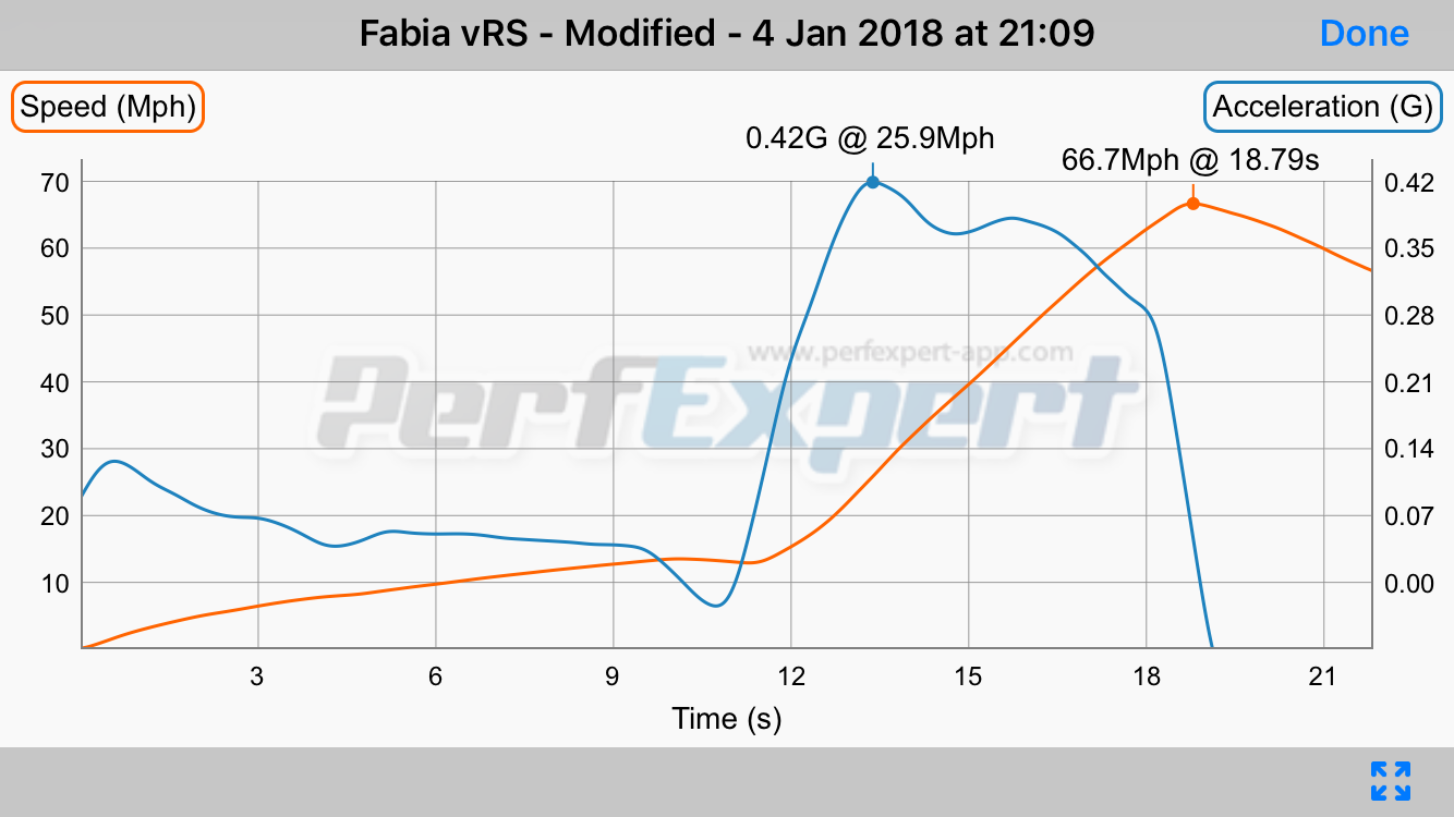

I have found the most reliable way to measure acceleration is with an accelerometer app like PerfExpert. Don't bother with dyno mode, a timed run in 3rd or 4th gear pull will produce a nice repeatable graph which will closely mirror your torque and boost curve.

It's possible yeah, but to be honest they are so unreliable it's not worth bothering. Like I said, logging the actual acceleration g through a gear won't give you a torque figure, but it will give you a graph you can compare to other runs and gauge relative performance.

No problem, if you do a 3rd gear timed run pull post it here so we can see how our cars compare. As you can see from my graph the peak torque is from the supercharger, then there is a dip while the supercharger disengages and the turbo is still spooling.
