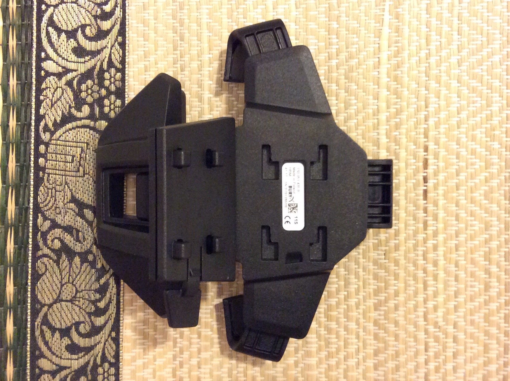

Hi does anybody no how to split the adjustable section from base. There is a lever but it does not work on my mount.

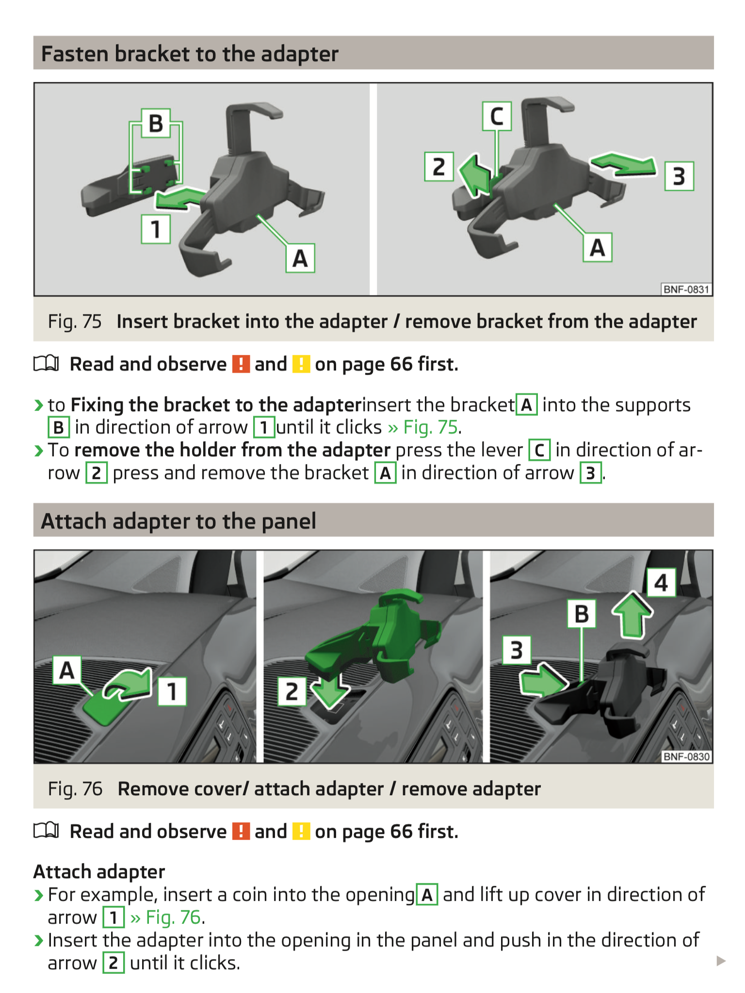

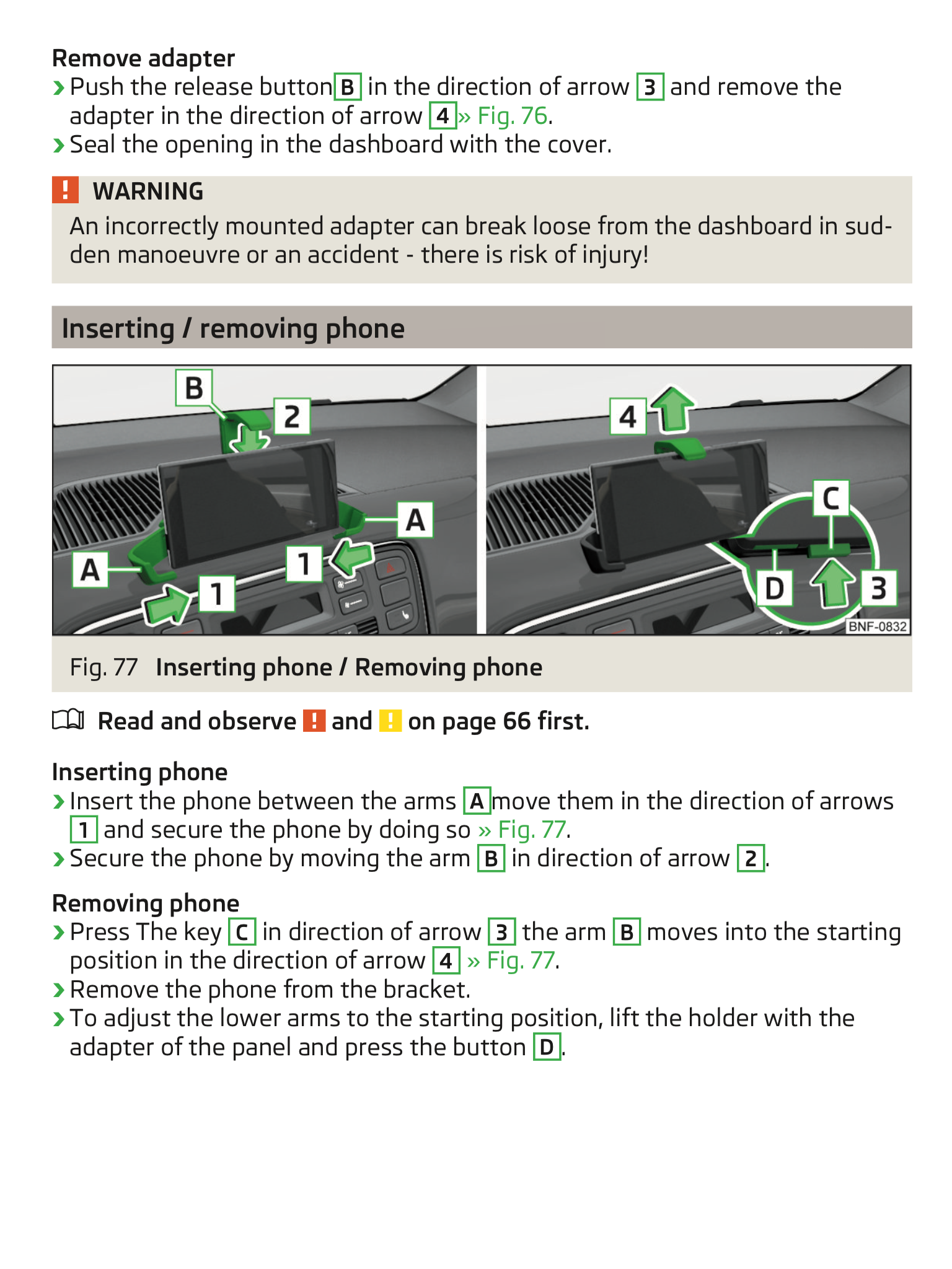

Hi,you have to press that lever and slide bracket right way until it’s move and than separate.It’s not going easy so you have to put a bit of strength.
See more details on attached screen shots from owners manual and unlocked bracket ;)
