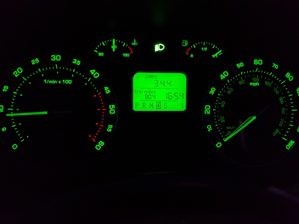

I get 25-27 Mpg on city running without heavy traffic being on the road. If i take it out on the motorway, I get max 35 Mpg. I have got this figure after 3 full tanks of running & not based on the dash information.

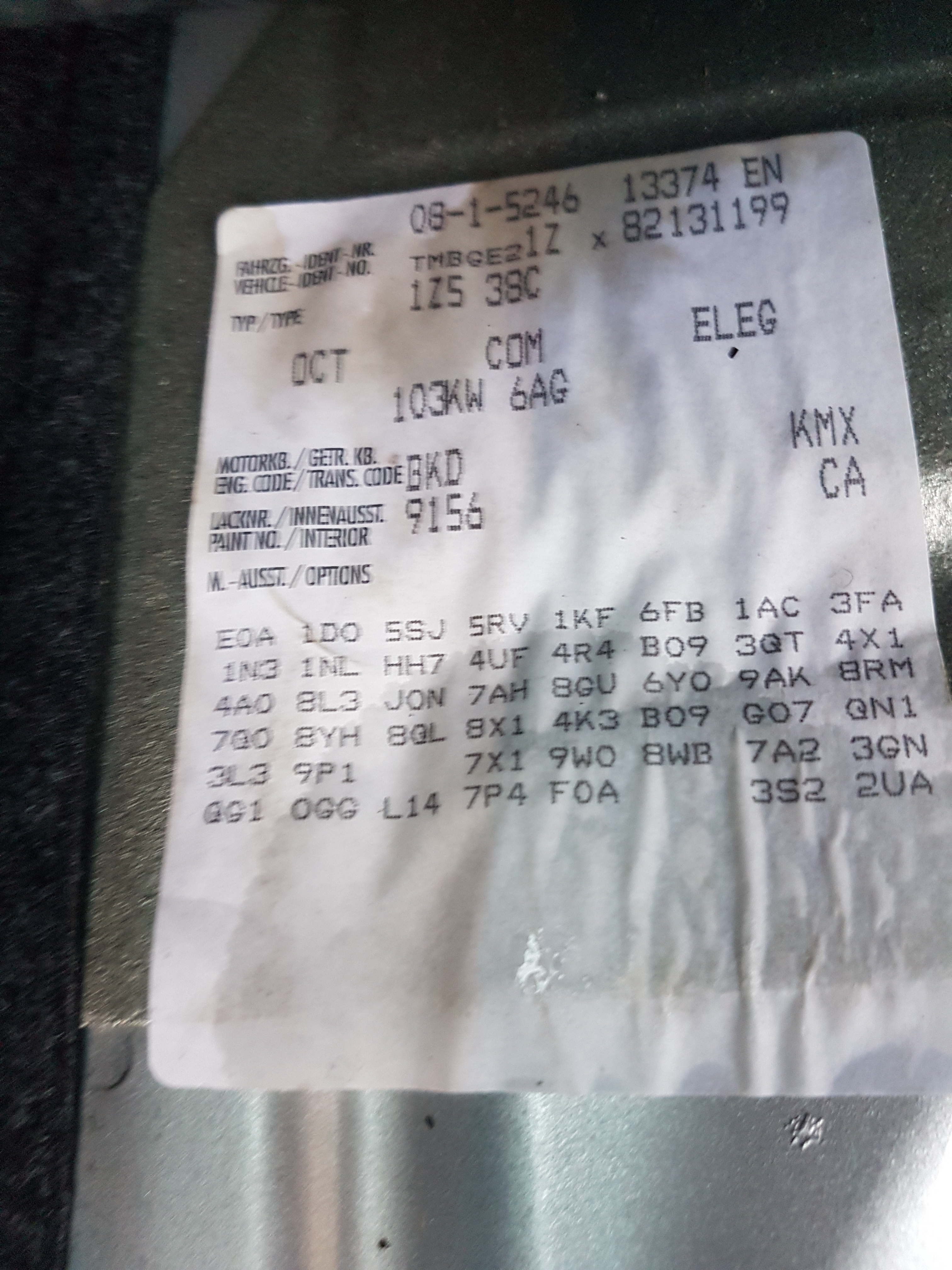

I have attached a picture of the car tag inside the boot which gives most info.

A simple search on the interweb brings up plenty of discussion threads on the BKD engine suffering from poor MPG and pretty same figures as yours. Most have had issues with Thermostat whereby the engine taking time warming up. Few have pointed out issues with the injectors being faulty and also dual mass flywheel.
If I was you, I'd get the injectors checked first to make sure they are working to their full capacity.
Edit: Also I think yours is a 2.0 TDI engine (103 KW -> 140 Bhp) as there is no BKD 1.9TDI that came in 140Bhp form. IIRC they came in 90, 105, 130, 150 Bhps.

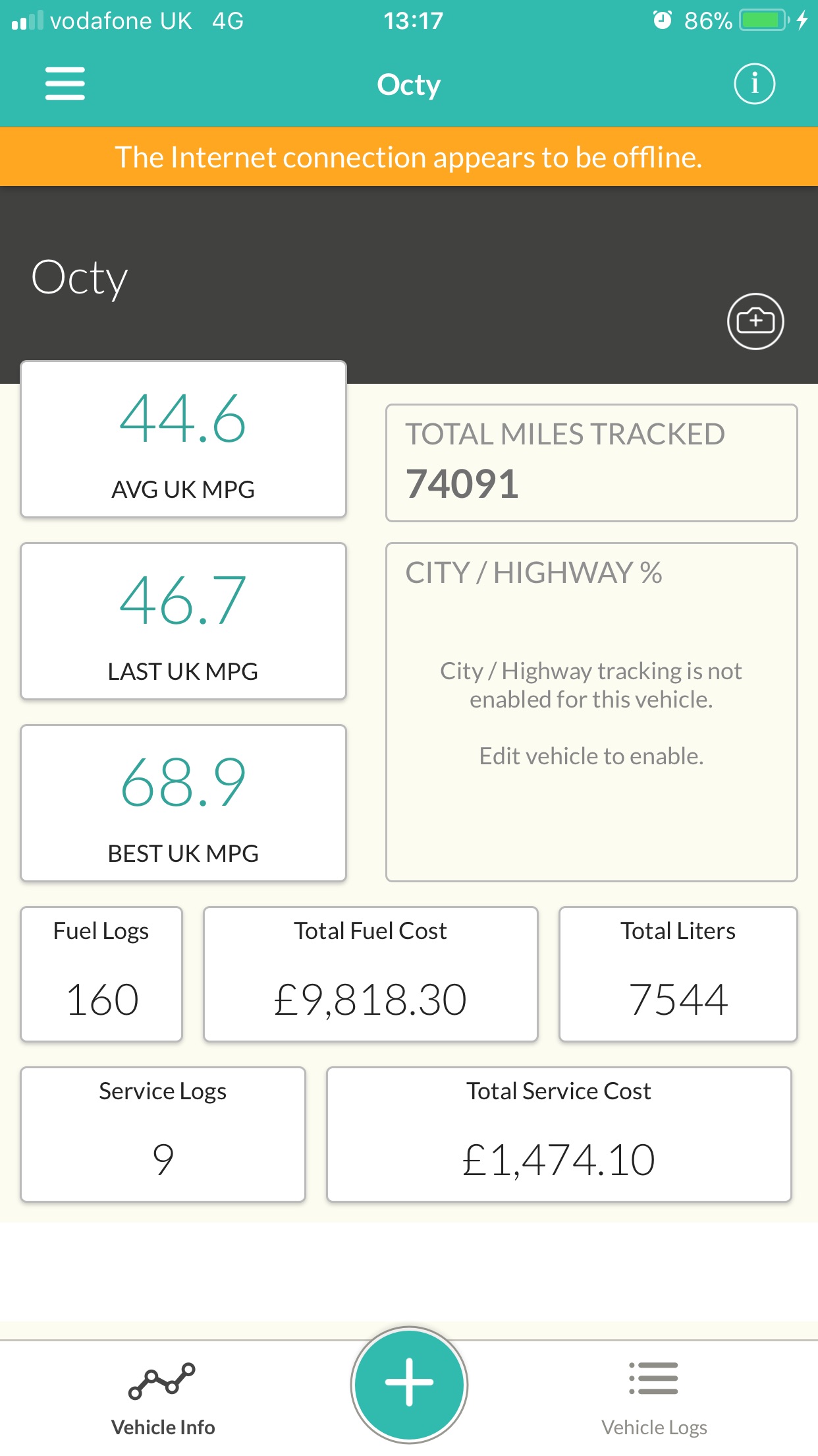

What app is this you use? Looks very handy.
Are the MPG figures calculated by actual liters used or those displayed?
