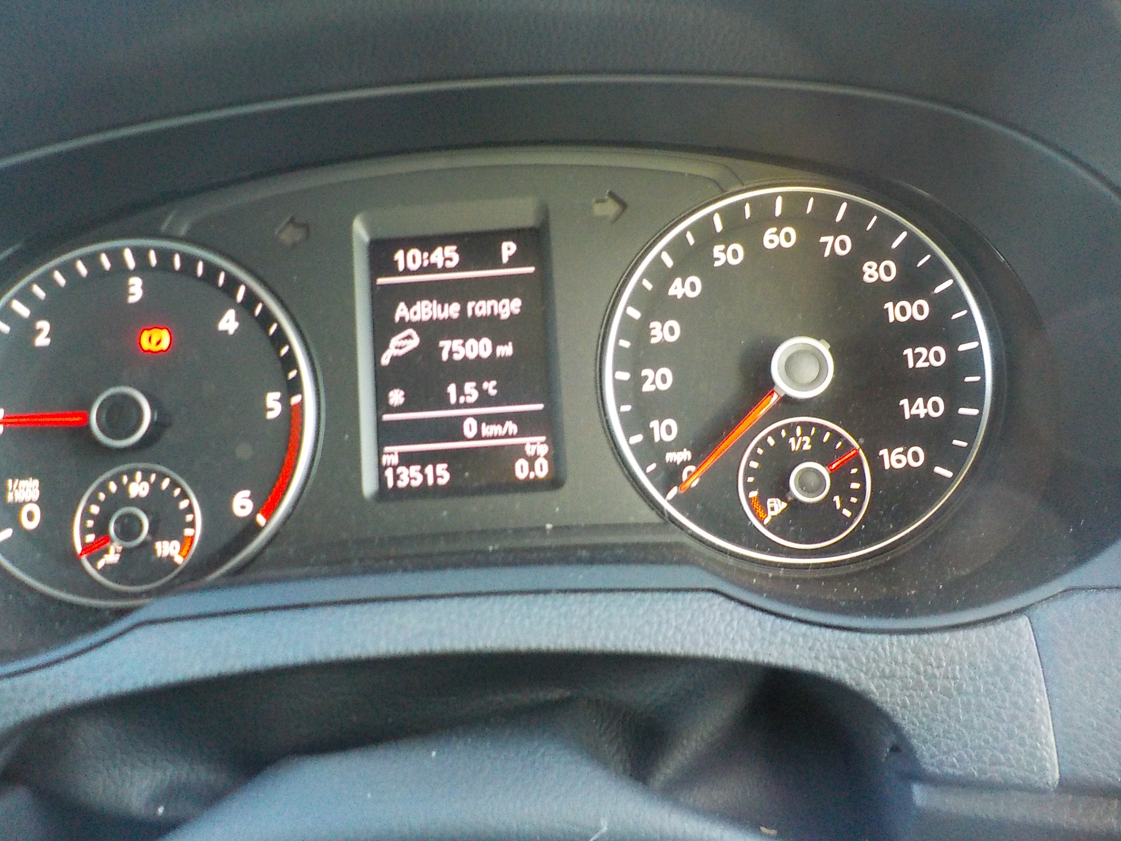

I have had the same issue several times now with my 14 month old 2.0 TDI 150ps SCR / DSG Alhambra this winter.
18,000 miles (29,000 km)
Never happened last winter when new.
The battery is just about doing the job.
I need to switch the lights off to DRL's. the radio and heated screen and mirrors cross fingers and on the 3rd or 4th try it fires.
Now i have a Jump Start Pack on board and Jump leads.
Doing it at -4*oC even, pathetic.
Ad-blue should not be freezing even though the temp has been to about -8*oC.
Diesel is not Waxing.

Braverhanne,
Handy when posting and someone reads the first post if it showed you were in Sweden.
When cold and staying cold it can be less of an issue, as there is Winter Diesel and Ad-blue should not be freezing.
I checked my battery and as is as should be.
Does not change the fact that after 3 attempts to get the engine to fire it sounds as though not enough to turn the engine one more time,
but luckily does.
That is why the power pack is in the car now, because i am places that there might be nobody to give a jump start and no RAC/ AA / Greenflag coming to within a couple of hours.
In the likes of the UK
there can be temps up above freezing day time and the night time freezes.
You still get moisture / condensation in fuel tanks, so good to keep them full as you can when parked up.
Then you still get H2o in Fuel Filters, and that can freeze, you can have moisture in Air Intakes, Air Boxes and Air Filters, that freezes,
then there can just be Sensor & ECU Brain Farts.
I suspect a bit there is a SCR issue at times,
Also a foot on the brake when turning the ignition issue when there is ice on discs, calipers etc.
I decided when i got a Diesel & a SCR that both the Ad-Blue Tank & the Diesel tank is as well to be full when the car is being parked up for a few days or more.
Just as was the practice with Petrol cars for decades now.
