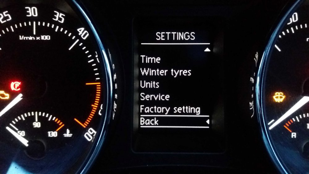

I am sure it must be staring me in the face but I can't find it in the book, on here or anywhere else for that matter. Those methods I have found online don't seem to relate to my car. 2013 facelift elegance. I have "Service Due" on the maxidot when I start up. If I go into service there is no option to reset it, just gives me the miles "0" now overdue 1 day.

Thank you. I've seen this one. I don't seem to have "setup" on my display. I have "service" but that only gives me the option of it's current status or "back" no reset or any other options

Yes, ignition on, engine off. This is what I get. I've checked guide after guide and still can't find a way to reset it. I did find one thread on here that seemed to suggest it may need vcds to reset it.

Thank you. but yet again it seems I have already tried this. In the service menu I have no option to reset it. The only thing I have not tried yet is the trip reset and the article seems a little confusing on that score. I'll take a look at that in the morning, I do feel a little less of a numpty though as it seems I tried all the usual methods and routes before posting for help.

Hold down the odometer trip. turn on ignition. "Reset service, are you sure" select with thumbwheel and ok.
