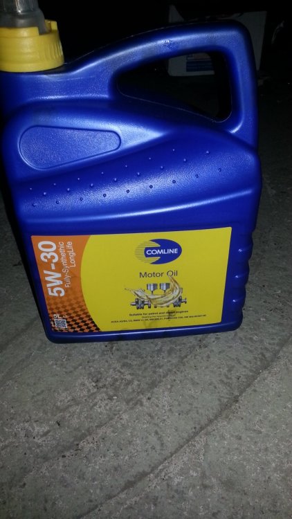

Hi, I have just serviced my octavia 2.0 TDI with the 5w-30 fully synthetic comline engine oil.
On comline's website, it says that the oil will last 30,000 miles (on diesel engines)
Does anyone know if this is correct? Its a long life engine oil but doesnt 30,000 miles sound like a bit too much?
How long do you reckon it'll last?
Any advice would be appreciated.
Thanks

If it says it meets vw spec 507 then it meets the requirements of skoda variable service regime dependent on the on board oil monitoring and service indicator being set to variable interval,  but only if your car/engine supports it.
Read up about variable interval service intervals. The computer will decide when the next oil change is due which could be anything from 9000 miles/1 year to 18600 miles/2 year max dependent on your usage and oil condition as measured by a built in sensor.
To go beyond 10k/1 year between oil changes is generally thought to be unwise.
If you cant find spec 507 listed on the tin then the above does not apply and it cant be used as longlife.
If it only says 505 then its the wrong oil for your car, get it changed straight away.
If it says 505.01 then its suitable but only for 10k/1 yr max.
Edited by xman
It does say 507 on the tin.....
