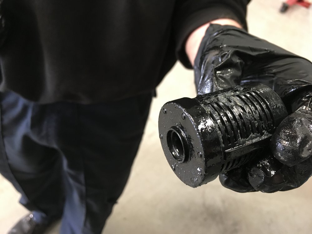

Haldex 4 Filter from my 2010 140pd Scout. 8 years old, 33k miles. Fluid changed by dealer at 4 years old.
unfortunately they managed damage a seal so il have to wait till Monday to pick it up.
That doesn't look good!
I thought that as you have a 2010 scout you'd have the filter that can't be removed, just cleaned... Mine's going back to the garage on Tuesday for them to have a go at cleaning the filter.
