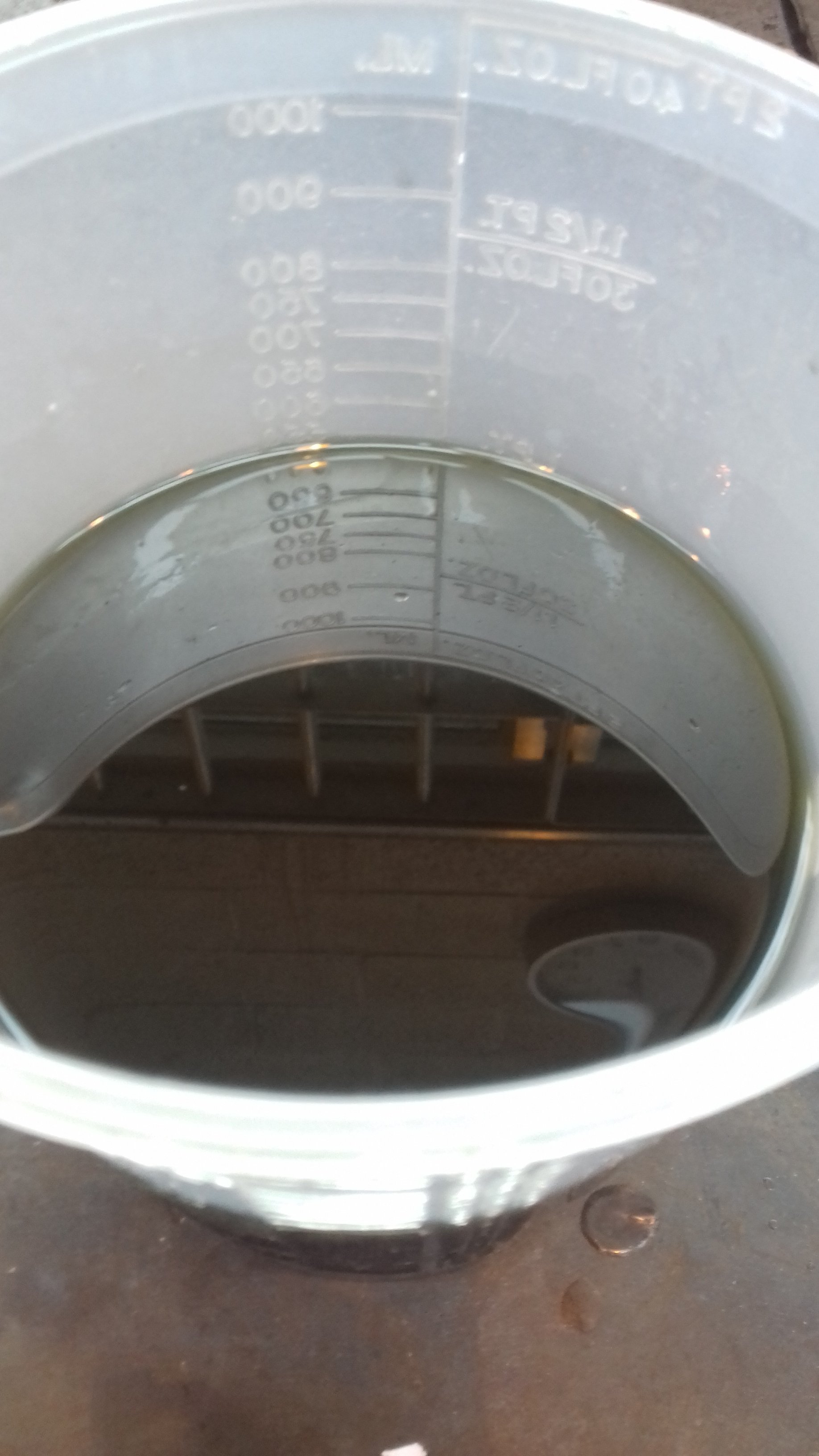

Well, I had the Haldex oil replaced, it seems there isn't a filter (or not an accessible one) on my car. Apparently the oil that came out was clean and looked much the same as the new oil going in!

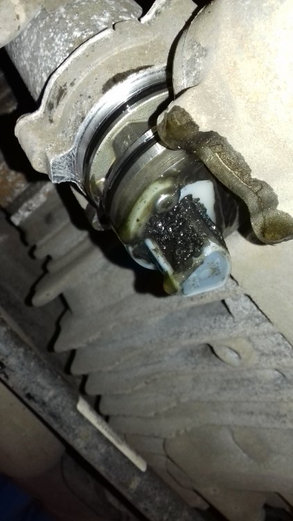

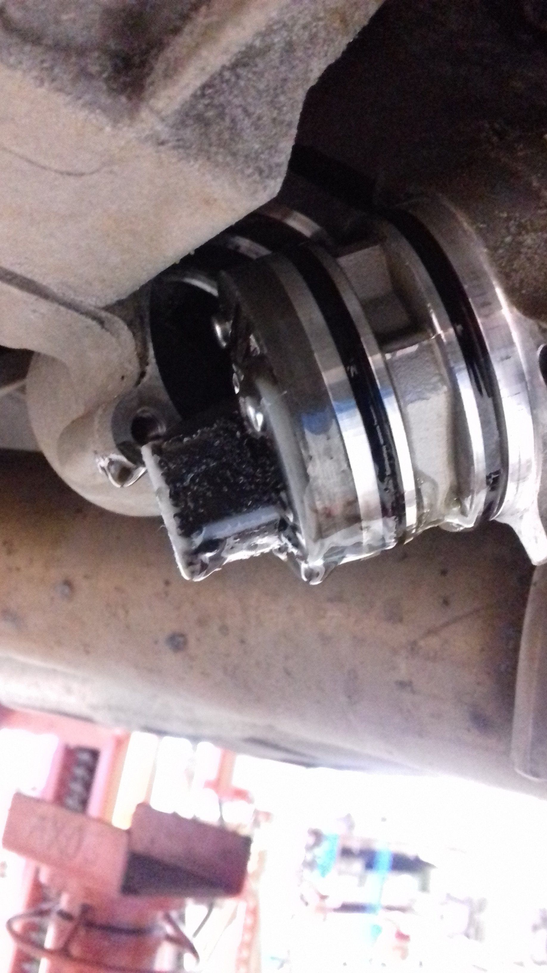

Id double check thats the correct oil & kit as my mk7 Golf R doesnt have a filter that is replaced like the older haldex,there is a small filter on the end of the haldex pump that blocks up (see my pictures). This was mine at 26,000 miles & 3 years old.

I did wonder if that maybe the case,just with the op saying no filter could be found,VW wont even sell the filter on its own on mine,you have to buy the pump complete! they wont even remove the pump & clean the filter as part of the oil change..madness as the pumps are failing due to the filter blocking up & the pump burning out.

I didnt on mine but mine looks to be a newer version of haldex but with mine once id cleaned the filter & re fitted the pump & filled up with oil i took the car for a run then checked the oil level again & found it needed another 100ml of oil(you do loose some oil from the pump when removing it & the filter so a run gets oil back into the pump & it working).I wasnt having any problems though,mine was just a routine oil change & filter clean to avoid any potential issues.
