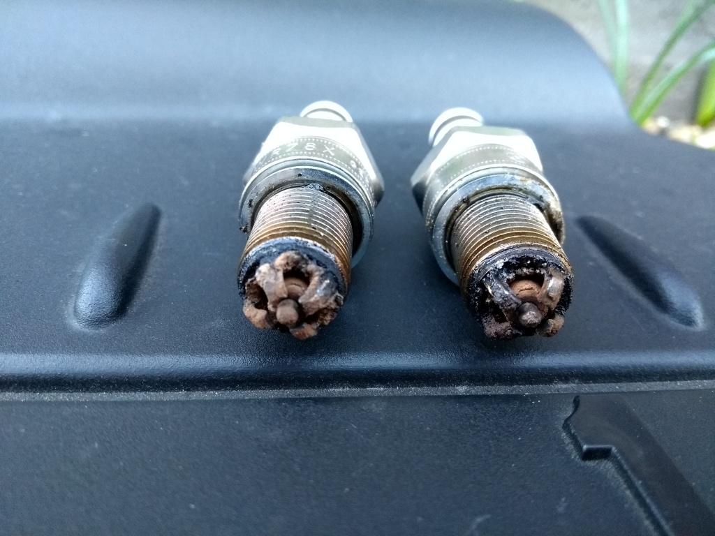

From your description and by the look of the spark plugs I'd say it is a clear case of incomplete combustion from bad ignition timing.
What type of spark plugs (make/code) are you using?
Hi Ricardo - cheers for that.   The plugs are Bosch WR78X.    I've got a new Bosch coil pack on order - do you think this is likely to resolve the issue?   Also do you think the pinking is likely to be related to the coil pack problem?
Thanks
@mexmeister - From the photo alone I'd agree with @RicardoM about the poor combustion caused by bad timing.
A new coil pack will give you a healthy voltage at the plugs, but it won't cure pre-ignition (pinking) in every case. The root cause of this is always the mixture starting to burn too early in the compression stroke of the engine.

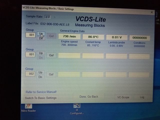

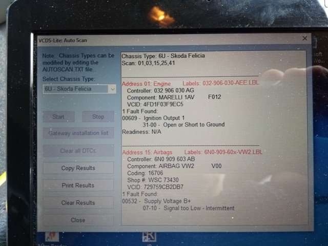

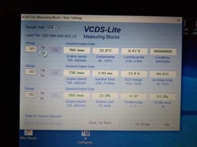

I've been able to access the pickup using VCDS-Lite and I noticed that the value for coolant temperature seems to drop by 50 degree a few seconds after being accessed (see photo).   I guess this means a faulty temp sensor?   The heater seems to be pretty good (wife likes it!).  Just ran a check with engine running whilst stationary and when the temp gauge needle starts to move off bottom stop, only front/top hose is getting warm.  The hose then takes a while to get quite hot and then the thermostat appears to open and the other hose gets hot.   Would the incorrect temp reading cause a problem (i.e. faulty ECU responce)
VCDS now seems to be showing two fault codes - the one for the ignition and another one for the Airbag. (see photo)
Cheers
@mexmeister - OK, the VCDS and observations seem to indicate that the thermostat is OK, so the most likely issue is the coolant Temperature Sensor.
Ref the airbag, is the warning light coming on and staying on rather than illuminating as a BITE? If not, then that is non-urgent.

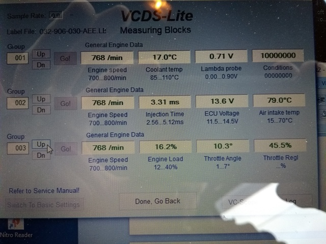

I know you have changed the coolant temp sensor but check its output according to diagram below. Check also that the thermostat stays closed up to 82C by feeling the thick hose that goes to radiator. If it stays cold up to 82C then warms up, you're good. It is very probable that if you changed only the thermostat without  its housing, there is a gap that allows coolant to flow all the time in the long cooling circuit. If both CTS and thermostat are OK, the temp gauge is faulty.
For an engine idling, the ignition coil error reported by the ECU is very strange because the engine shouldn't run or run like a tractor. I mean, if the error is permanent.
What puzzles me is the air intake temp indication of 79C...

Er, is it possible when the recentish work was done on the cooling system, that somehow the wiring to the coolant temp sensor and air intake temp sensor got cross-connected, leading to those weird readings of coolant 17.6c, and intake air 79c???
Richard.
Richard, very interesting observation. Might be a coincidence but the air temperature sensor goes to pin 43 of ECU, while coolant temperature sensor goes to pin 42 of ECU... which makes you wonder...
Interesting indeed.   However, I fitted the new thermostat housing myself and I know I've have never touched the air temp sensor.  I guess it's possible something happened before I purchased the car - or could it have happened during the head gasket repair?  However, what's also is interesting is there's a forum post from 2011 where there's someone with similar flipped readings for air and coolant temperatures showing in VCDS-Lite.  There's a comment about VCDS-light not always having the correct measuring block labels.   All being well I'll be fitting a new coolant temp sender and coil pack tomorrow.  If I've got time I'll also investigate the airbag wiring etc.

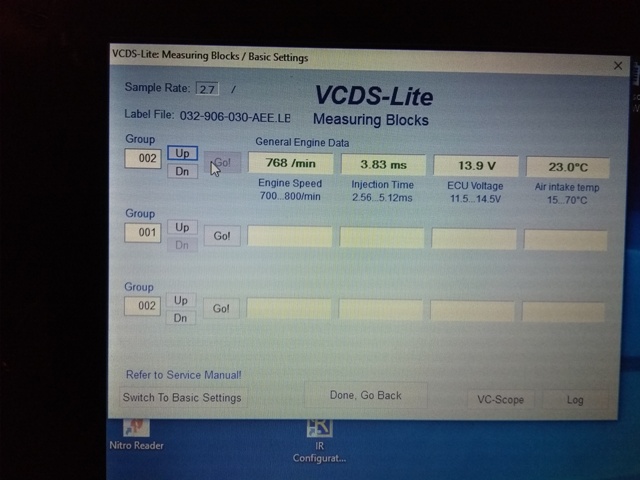

I changed the Coil pack, complete thermostat and housing (inc coolant sensor) today and the ignition fault no longer appear in VCDS.  What was interesting was that following the comments about the low coolant temp and high air temp readings in VCDS, I examined things a bit more closely and it appears to be a glitch in VCDS.  (see attached pics)  as can be seen, when viewing groups 1, 2 and 3 together, as was noted before, the coolant temp in very low and the air temp very high (appear transposed).  However, if each group is viewed individually, the readings are suddenly correct.   The cooling system seems to be working OK.  Using VCDS I monitored the temp value whilst feeling the cooling hoses/rad.  The thermostat opened at about 86 degrees and the fan then kicked in at 96 degrees.  However, when the engine was warming up, the the top hose near the thermostat still got quite warm before the thermostat opened.   Hopefully the new Coil pack will sort out the high emission problem.  I'll get it tested at the end of the week.   I also cleared the airbag fault and it hasn't reappeared.

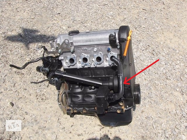

One thing I did find was that there there appears to be a dodgy hose at the rear L/H top of the engine.  The hose appears to be cracking up and the previous owner has wrapped some insulation tape round it.  However, the hose is collapsing in on itself and is therefore almost blocked .  I've arrowed the hose in question in the attached photo.  Can anyone identify what hose it is, (ideally with a part number), as I would like to replace it - although it looks like it may be fun getting to the bottom fixing.
Thanks
That is a hose for the crankcase ventilation. Part number 032103493K.
About emissions part: hopefully you cleaned very well the spark plugs. Do a trip on a highway with 60-80 mph, return, leave the engine to cool off then look at spark plugs again. Monitor the temp. gauge too.
