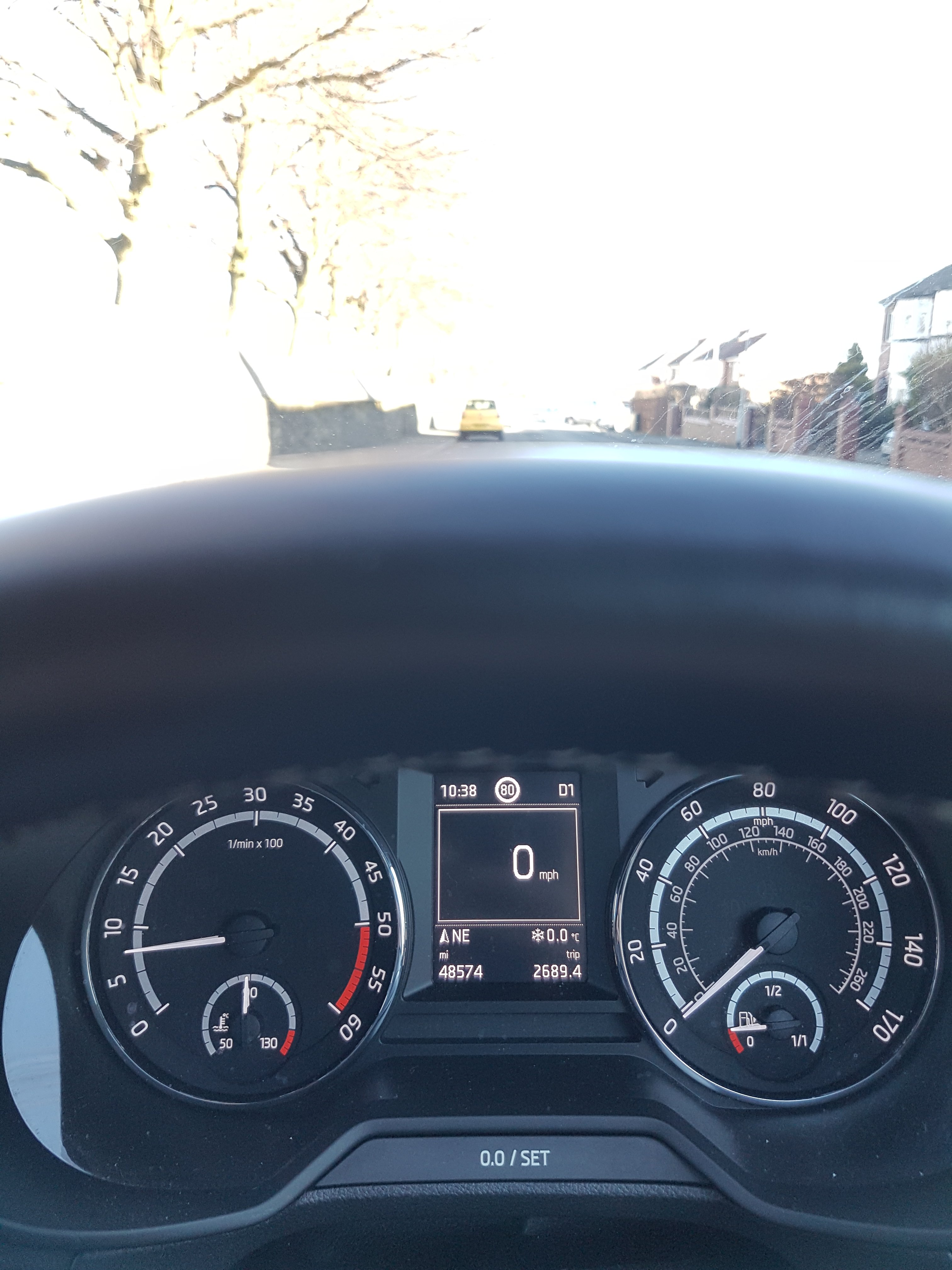

TSR abnormalities
Not convinced with this :biggrin: Showing 80mph coming off a 40 road onto a 30! Sat nav screen on the Amundsen also shows 80.
TSR overrides map data. I had the same issue with a 50 sign which consistently read as 90. Think they have since cleaned the sign and it correctly reads now.
