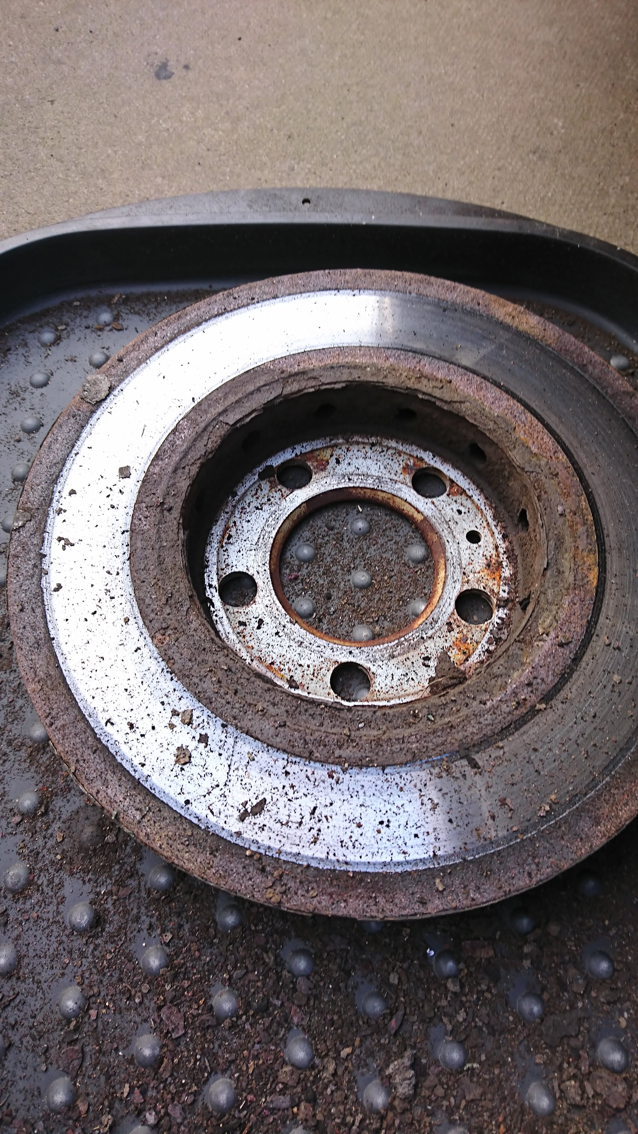

We have just bought a 2010 1.6 crtdi 90 and I was shocked at how at national speed limits you struggle to slow down, yes it will stop but you have to remember that you need more room to brake... Maybe it's because it has drums on rear instead of discs?

Its likely the discs are in poor condition, the inner side is not visible and you may be shocked if you saw its condition. Often the caliper will stick due to lack of maintenance - dealers don't touch them unless you pay them to. A badly sticking caliper can reduce braking effort to 50% straight away. If there is corrosion and ridges you lose even more.
Strip clean and replace discs and pads if necessary. £235 at dealers, ~£70 if you do it yourself.

It's just passed mot, but I suspect discs as pads are showing plenty of meat, but when I run finger on inside it's very rough... I think it's time for new ones

I will change them anyway, can't do any harm as they look poor, I'm sure I will see when I remove them

I've tried a few hard brake applications and I've found the brakes at front now judder as if warped, so I definitely will be changing them

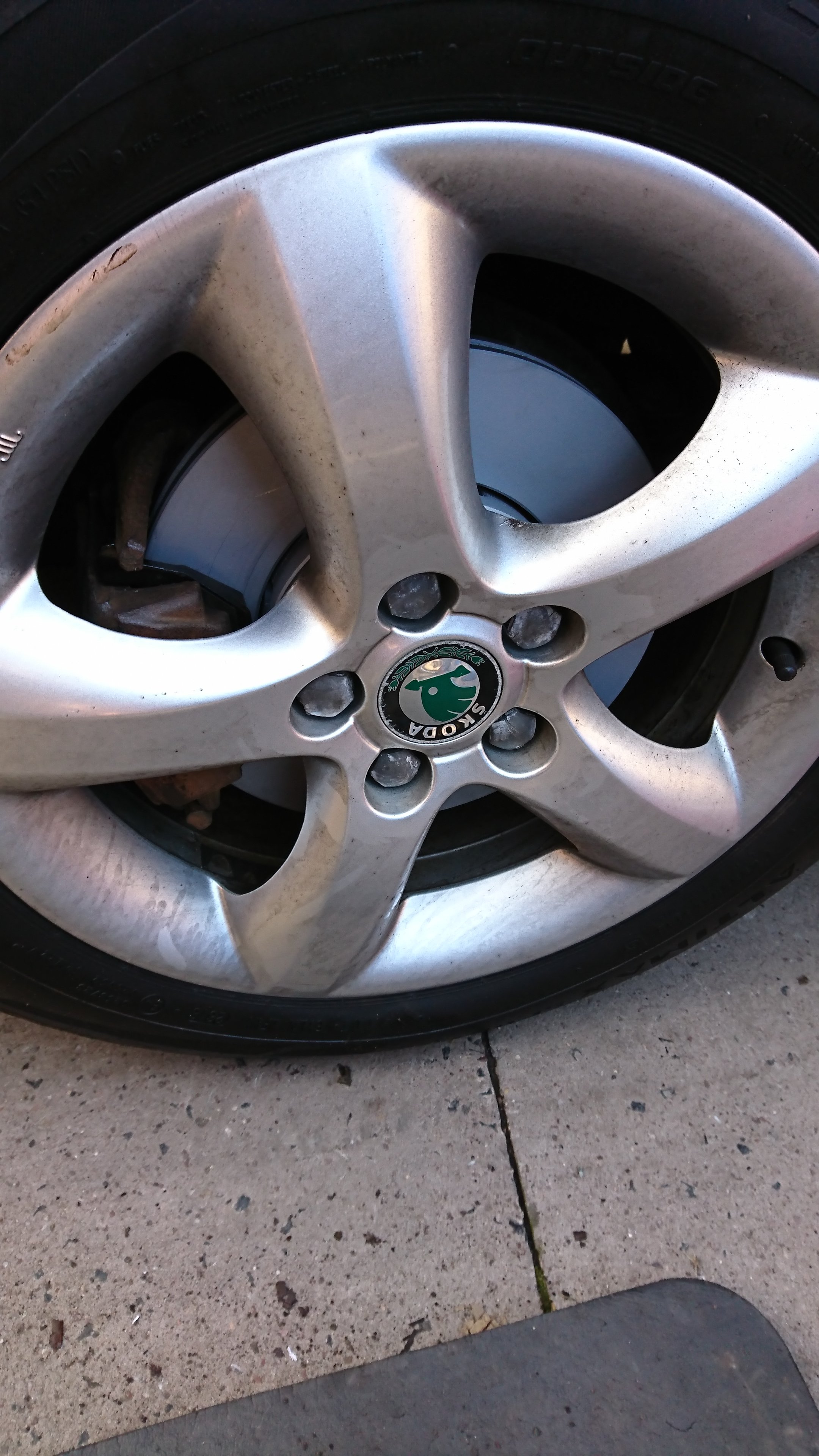

So went to tps and bought a set of discs and pads, this was the inside of the discs
All done, it's definitely better but I will be having a look at the drums next

Edit:- looking at that scaly old disc reminds me of how satisfying I used to think it was to chip all that scale/scab away - passed an hour of two when in reality the smart money would have been on replacing them with new ones!
