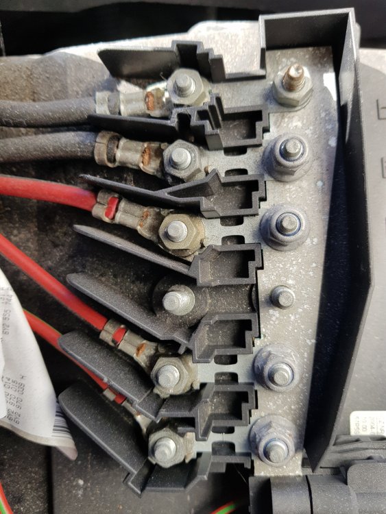

For ABS light check the strip fuses in the fuseholder on top of the battery as a first step. Often a quick/easy fix, and very common failure.

Strip fuse No. 6 (right hand one as you look from the front of the car) is the one for the ABS in your car. Have a close look at it, because they crack rather than melt, due to mechanical vibration I think, so it can be hard to see.

Is it cracked?
  • Sponsor
Looks like it.
Part number is N10424902, should be available at any VAG-group dealership, or TPS.
Motor factors shops may have something equivalent. It's 40 Amp rated.
A few on ebay at not too ridiculous prices, if you're not in too much of a hurry; https://www.ebay.co.uk/sch/i.html?_osacat=0&_odkw=N+10424902&_from=R40&_from=R40&_trksid=p2334524.m570.l1313.TR0.TRC0.H0.XN10424902.TRS0&_nkw=N10424902&_sacat=0

Aright mate, went Halfords replaced the cracked wire fuse, turned car on and was still showing faults as listed; did a battery reset, took the Positive off the battery for bout 30 seconds, turned car on same issue.
