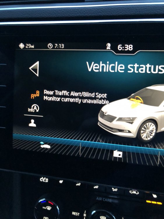

Mine too is playing up since the cold weather a few weeks ago, I’ve got it booked into the dealers in a couple of weeks time. Weirdly it is fine when at running road speeds but as soon as I’m crawling in traffic or just manoeuvring – Bong – “Rear Traffic Alert/Blind Spot Monitor currently unavail.” on the MaxiDot. Only a couple of times has it refused to re-engage on the tick box, at which point the main Vehicle Status screen showed a problem, otherwise this screen says there are no problems.
Ivan.

Took three months and somehow came good. Actually got worse before it got better. At one stage it was unavailable full stop giving me the same message as Ivan’s photo above. I’m convinced it was some sort of a bug with the parking assist system of sensors rather than any personalisation settings issue.
