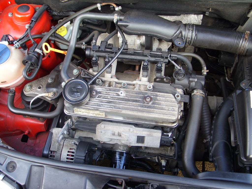

Hi Luke,
There is no bayonet fit cap. The Felicia one is push fit. If it's very loose it means the rubber seal needs renewing. The seal is part number 047103487
The oil cap is part number  047103485A (sometimes comes minus rubber seal).
This was mine....
Edited by TMB
1 hour ago, toot said:
@luckylukeWelcome.
Why can you not just ditch the plastic engine cover?
On the 1.4 mpi the cover is used as part of the oil filler and has its own rubber seals because the VW type cap actually fits to the cover itself and the cover also seals to the rocker cover oil filler hole. A Felicia type oil cap is clipped to the underside of the cover in case you want to run the engine without the cover fitted as the VW one will not fit directly in the rocker cover hole. That's what you use if you want to do away with the cover altogether. Sometimes the cap is missing but they can be bought on ebay.
