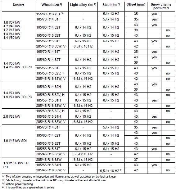

I’m after some advice got some 14” alloy wheels on the fabia. Also got some 15” steels don’t know which way to go! Also what’s the best tyre size on each size. Thanks matt.

True...almost :-) > this just gives info which pressure must be in which dimension of wheel. But in general is true.
Look > on my sticker there's also 13" wheels mentioned- but they can't be installed on my 1.4L 16V 74kw Fabia due to bigger brakes.
Reccommended wheels can be found just in Škoda Workshop Manual.
