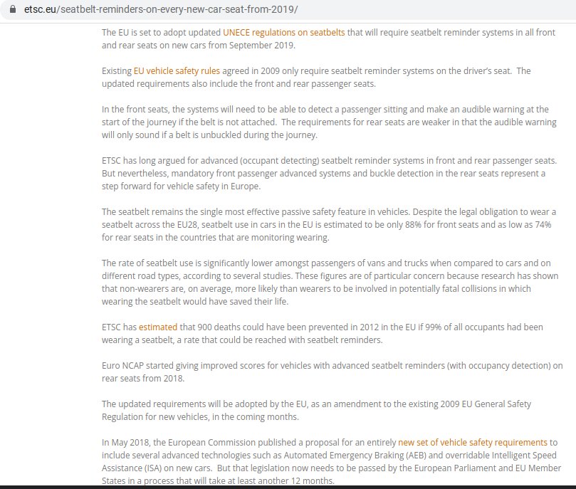

I've checked my car - dont have wires or any modules/coding available for such option. Car was for Italian market...but yet i think all EU spec must have it by default. The other option is that EU made them mandatory from 2010+
Was that mandatory on all vehicle Type Approved from 2010?  And in registered in the EU.
The Mk3 did not even get New Type Approval in 2014.
