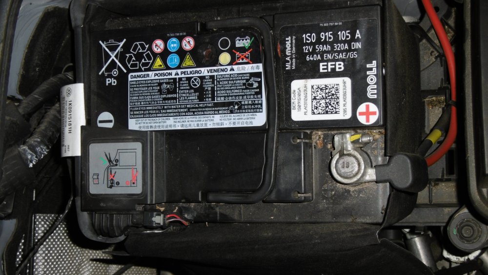

Did he charge it or use jump leads to start. Mine is clear with a diagram on the battery to connect the negative/earth terminal to a metal part on the car and not the battery terminal
He must have charged it because his van was 50 feet away...
