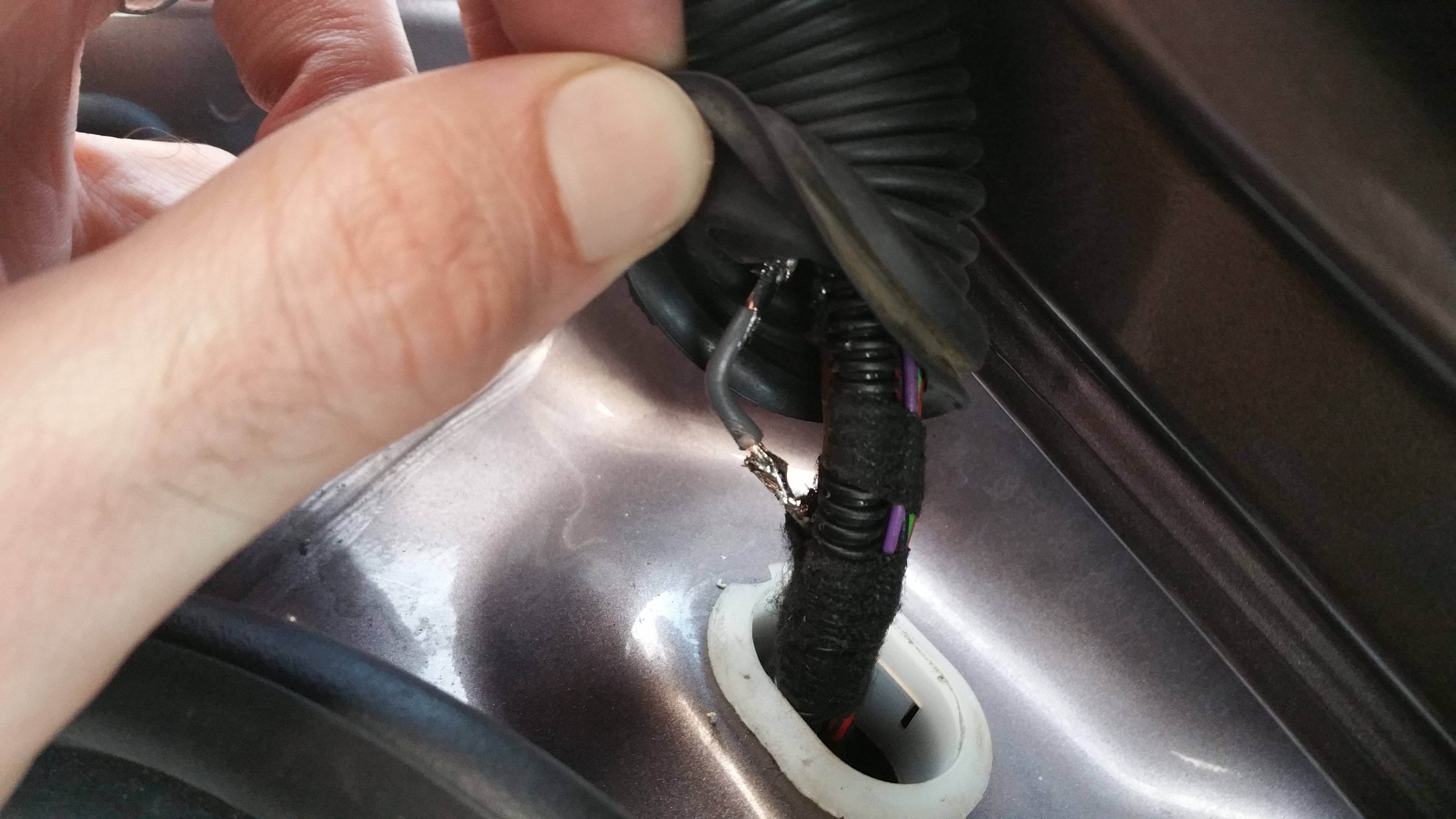

Problem resolved, thanks for the info bigJohn.  As soon as i pulled back the grommet and seen the red electrical tape it was obvious. Previous repair (not me) had only twisted the wires together, this shorting of this particular cable  added more strain on it.
I soldered in an additional small piece of cable, Unfortunately I don't have heatshrink sleeving this small so black electrical tape wrapped tight had to do.
