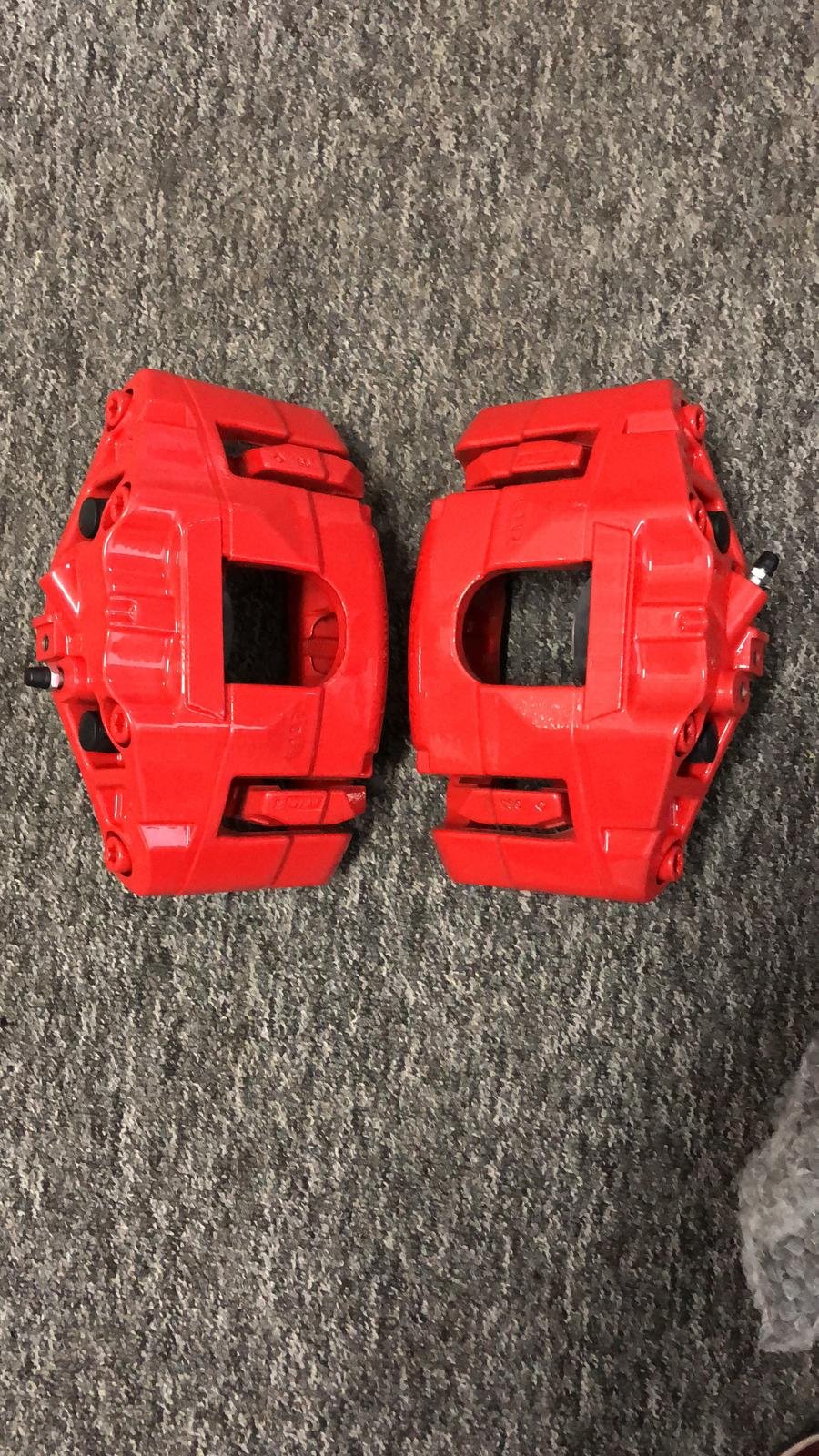

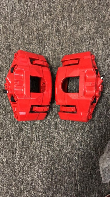

Waking up to old thread I’m just about to fit 345 calipers from 3.6 v6
That should certainly help the scenery slow down ! :)
