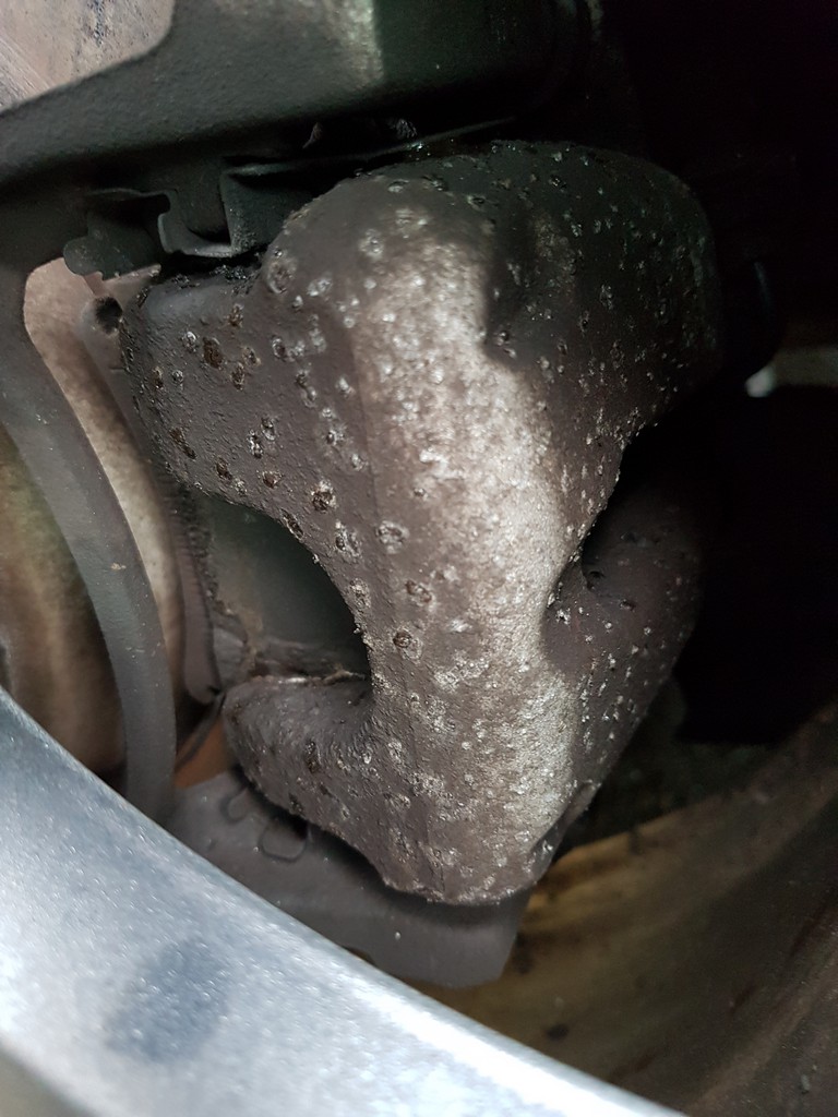

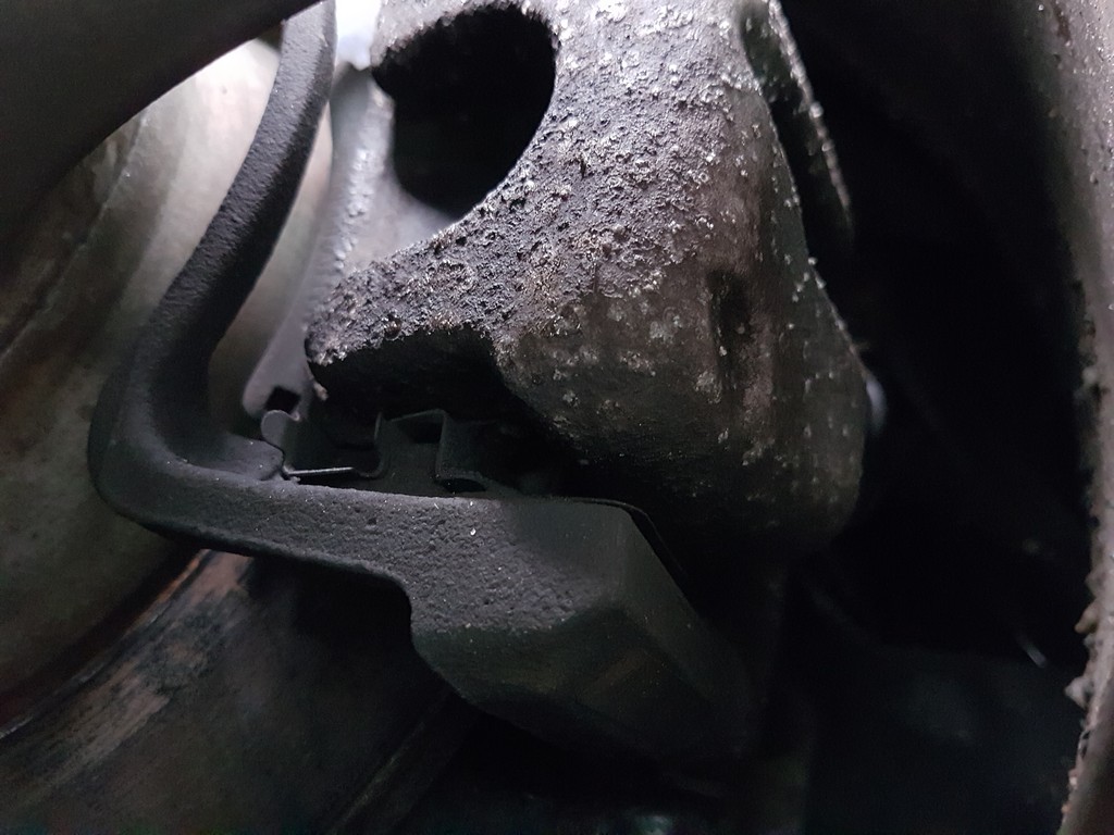

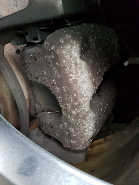

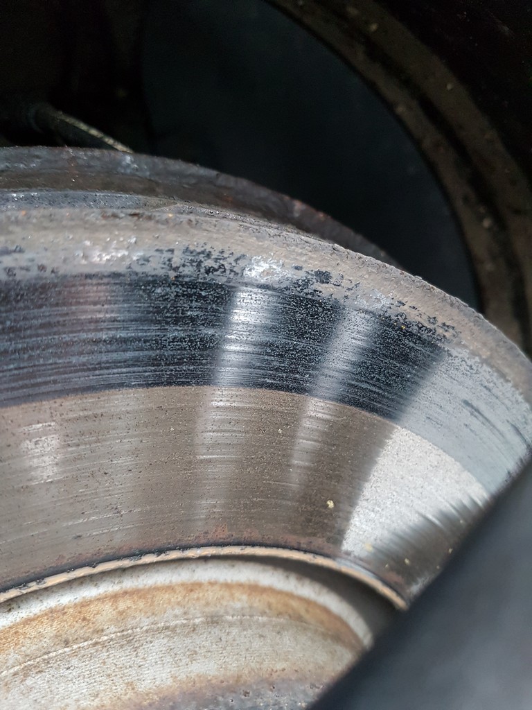

NSF appears to have a band of uneven wear and isn't looking clever with pad contact not the full extent of the disc, probably an MOT fail....not sure what would cause this...  Brakes haven't been good from day one, and I expect this won't be helping...  Car is in at the dealer next week for a service so will get the brakes checked/cleaned meantime ahead of ordering the parts required.
Edited by TasMan
That last photo looks like a floating caliper which isn't floating or something wrong with pad.

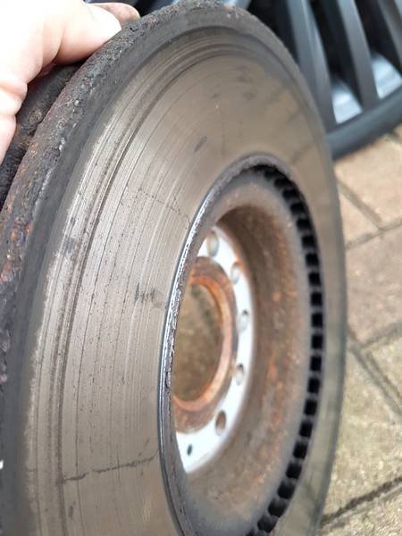

I have had the pads out twice front and rear  cleaned carriers and slides before eventually upgrading to Black Diamond Predator Pads all round.
My pads were changed about 70,000 and the discs were still well within wear tolerance so only fitted the pads in hindsight I should of went the whole hog then...
Now at 100,000 my discs are going the exact same way as the above picture so they are getting replaced with Black Diamond discs all round this timeB)
I am thinking that the discs are too hard a compound cause my C Class eats O.E. discs both front and back:crying:

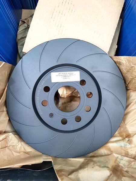

Finally getting to update this thread.  Car has now been treated to a bit of an upgrade.....
Black Diamond 12 Groove discs all round with matching Predator pads and a set of braided hoses, I wasn't messing around...... :biggrin:

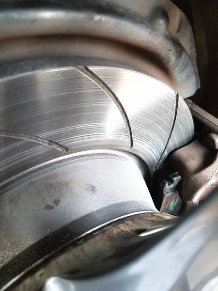

I have now driven about 300 miles bedding the brakes in and the performance is night and day.....
The first 50 - 100 miles weren't great but the performance then got progressively better every day.  Stopping power is immense now with no sign of fade.  Initial bite is excellent, not over the top for a family car if you brake normally but when required you know all about it....  There is no squeal or drumming noise when braking which was a slight concern with grooved brakes.
My driving style doesn't normally need the full braking potential but knowing its there when required is brilliant.  The braking power would easily give folk close behind something to think about.  My insurer has been informed and I now have 'brake changes' noted on my policy with no additional premium which was excellent.
Overall, highly recommended for anyone thinking of an upgrade.  When I get a chance I will list out the Black Diamond part codes for anyone interested.
Cheers Dave

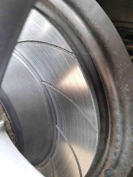

Discs with only 30 - 40 miles use, sweep area still being cleaned off, now fully clean with no bedding marks.

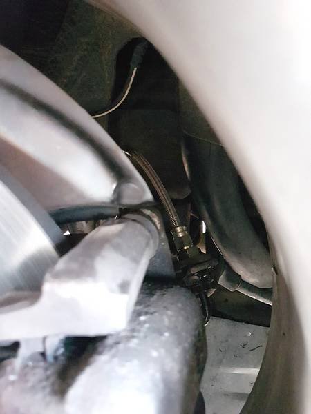

Braided hoses all round...
Crusty state of old discs, photos make them look better than they were, bad scoring and poor surface contact noticeable.
