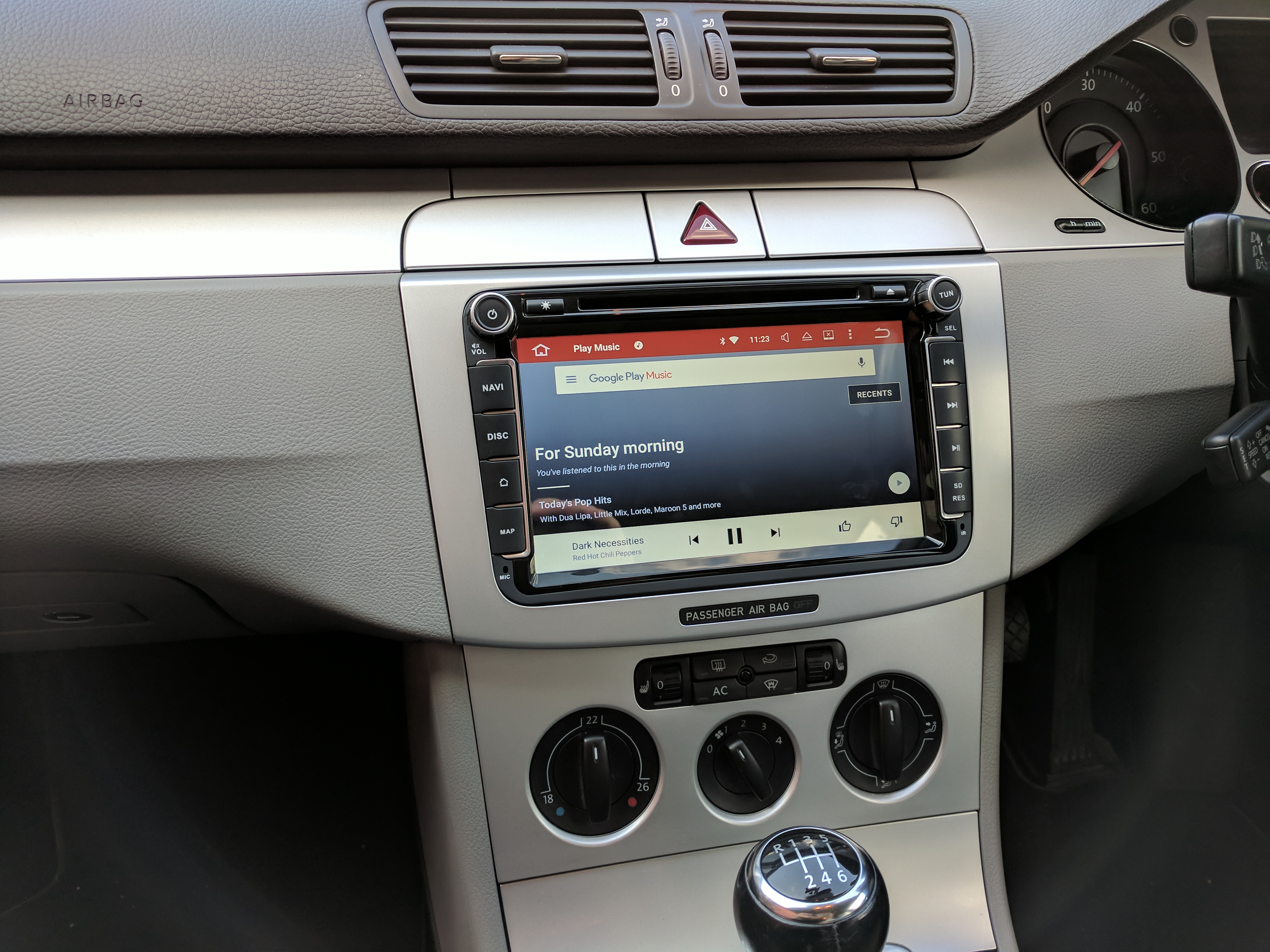

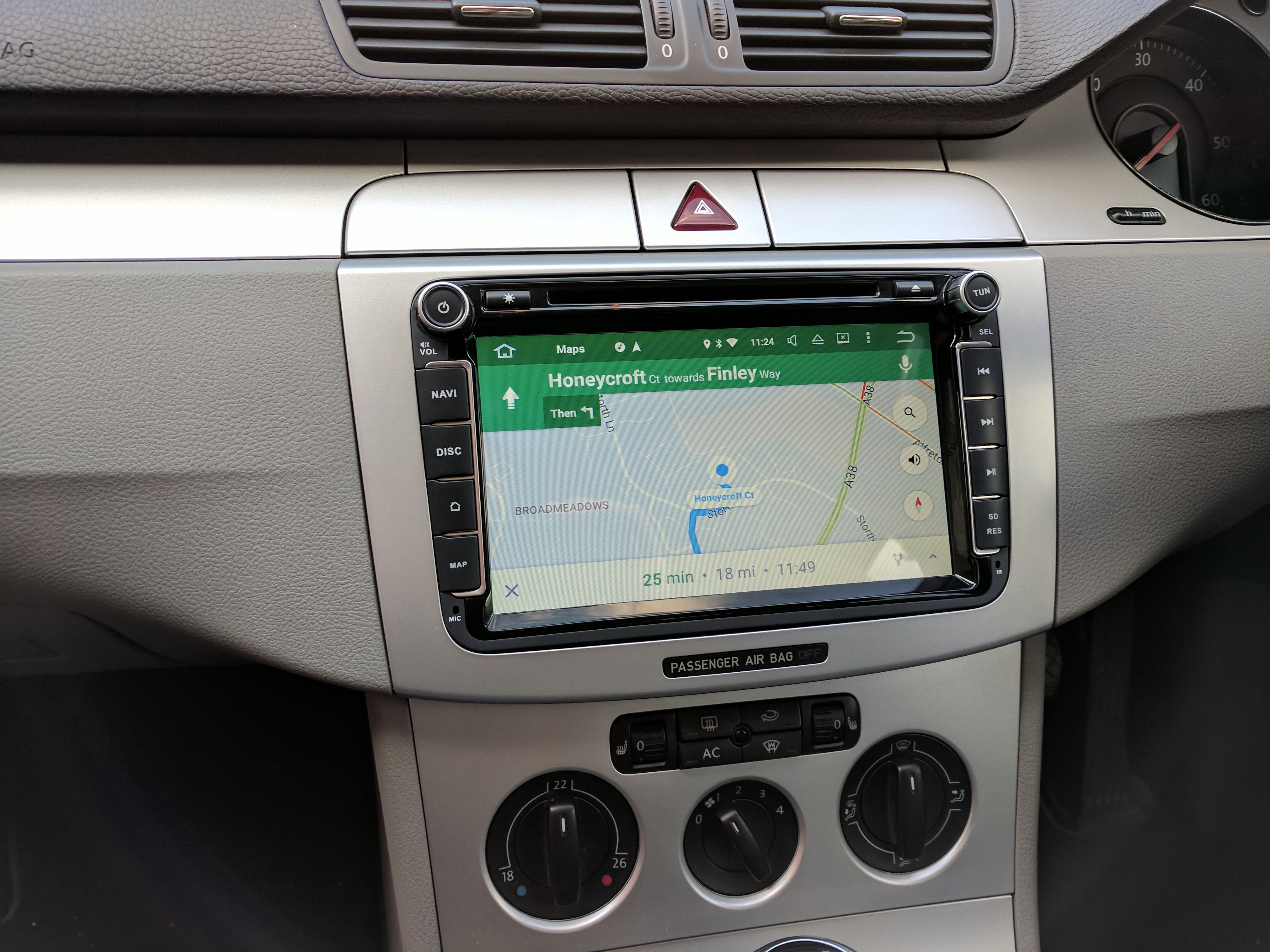

May I suggest one of these cheap Android stereos if you're considering upgrading:
http://xtrons.co.uk/head-units/custom-special-car/car-make-s-z/volkswagen/pb88unvp-android-8-octa-core-4gb-ram-32gb-rom-multimedia-dvd-player-with-8-display-custom-fit-for-volkswagen-seat-skoda.html
It's basically an in-dashboard Android tablet.  I have one in my Passat and it's really pretty good - I can't really imagine going back to an OEM system.
  • You can install any sat nav app from Android store (my preference is HERE - which used to be Nokia - but you can use Google Maps, Tom Tom or anything else)
  • You can use your favourite music apps directly on the device - I listen to Google Play Music. I also use RadioPublic which is a podcast app.
  • Still connects to my phone via bluetooth for hands-free calls
  • Looks totally OEM - lights up Skoda green or VW red (there is a setting)
It's worth mentioning it did take a small amount of fiddling to get right (back and forward with the manufacturer installing updates) and there are a few rough edges if you dig into the menus - so if you want it to be plug and play and 100% slick it may not be for you.  But I'd still recommend it!  Looks ace too:
The Xtrons unit I mentioned should support some kind of screen-share, but when I tried it I didn't have much luck - your mileage may vary.  It's possible they've come on a bit since, or maybe there's another make of Android HU that has better support (I've heard good things about Joying also).
In all honesty though, Android Auto / Apple CarPlay is not something that seems necessary on these units since it's a fully-fledged Android device.  I can install any apps I care to directly onto the device.  All my stuff is cloud based these days anyway.
