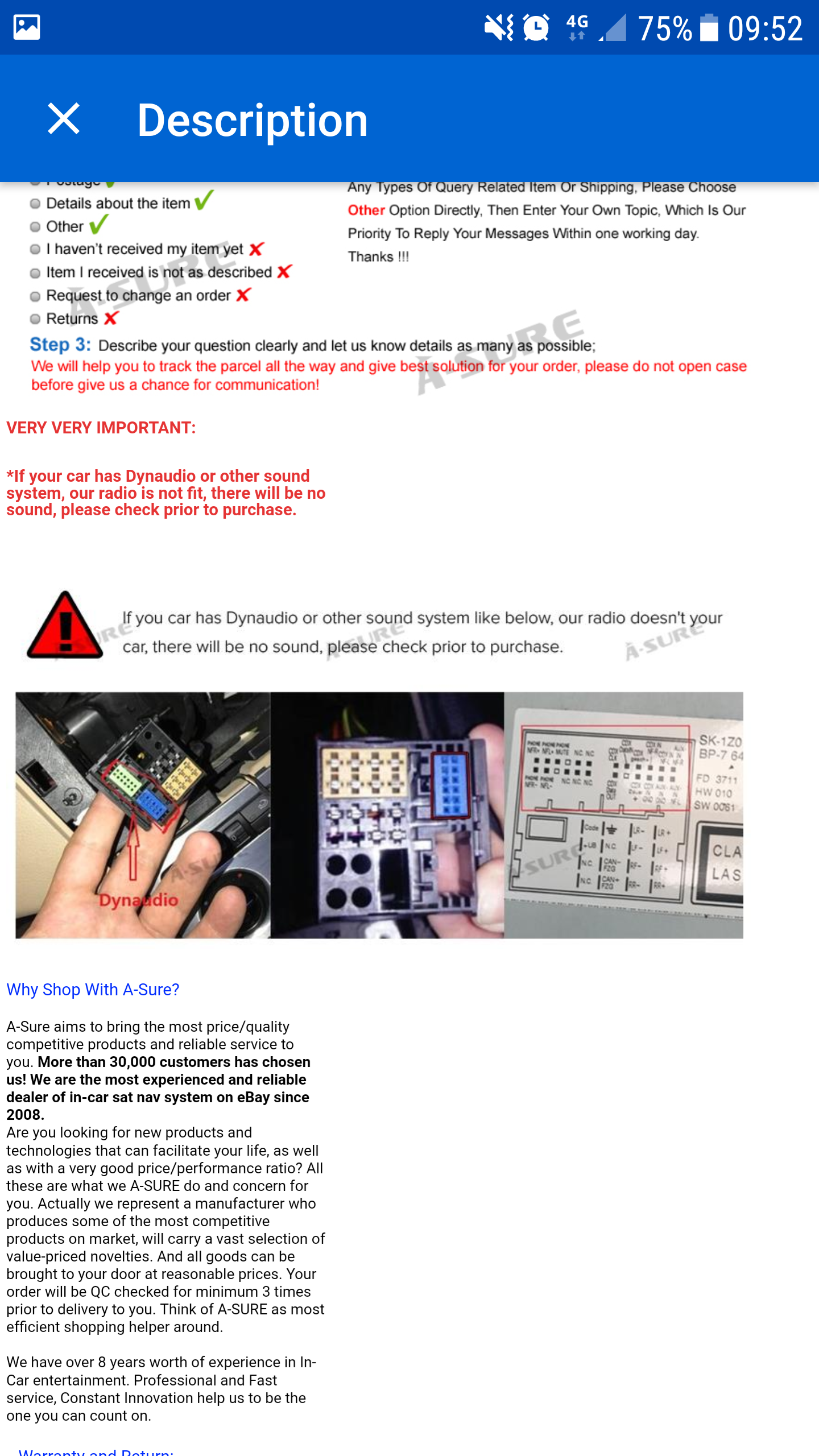

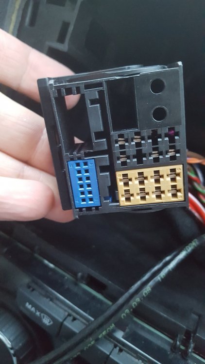

I was looking at android head unit Asure or Xtrons ( ebay) but in their descriptions they say - if I have Dynoaudio system( see photo attached) Mine is on second photo
At the moment I have Bolero system and my connector is slightly diffrent
My question - what type of system Bolero is? Is it Dynoaudio?
I asked seller but he replied with question "Is my car has Dynoaudio or other system?"

I believe that Dynoaudio is one of the amplifier options for a VW.
If you haven't got a factory amp fitted then it'll probably be fine. I'd normally expect to find it under one of the front seats, a VCDS autoscan will confirm.

I really do not understand this unit can fit golf and other vw. Does Skoda have different connectors?
No difference in connectors but there must be a reason why they say to contact them if its for a skoda.
