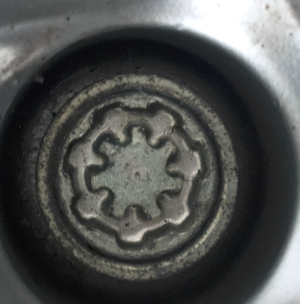

Below is the locking wheel nut.

you should be able to match your picture to one on fleabay.

I did contact my local dealer this morning, its a non-stocked item as there are about 20 variations believe it or not.
If anyone ever needs in the future to replace this removal tool,  it might be worth noting, that its actually cheaper to purchase 4 new security bolts and the tool,  rather than having a replacement tool and a single security bolt to match your existing set, from your local dealer. I just thought that I'd share that information, obviously Fleabay would be cheaper still.

I'm 95% sure that there was a post (some time last year?) about these removal tools. If memory serves me correctly, there is a number on the hex drive and this will identify the specific pattern needed if you ever have to replace it.
I've got my number on a post-it inside the drivers manual.
There is a single letter stamped on the socket, this translates to a three digit number that appends to the part number,
searching just for the letter will suffice.
