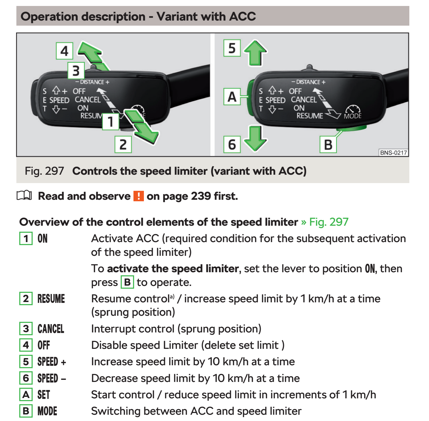

There is mode button below the stalk.
This will switch between active cruise or speed set cruise.
See attached image - it's labelled "B"

Does’nt matter if it’s factory or retrofit; standard cruise is operated on the wiper stalk, not a seperate stalk.
The mode button only switches between ACC and speed limiter, which is not normal CC, unfortunately.
If it was, I would be very happy.

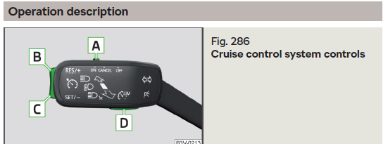

The partnumber for OEM cruise control is 3V0800054 (/A depending on current equipment).
(JR RS - sorry, but I don´t understand half of your last post...)
Photo is from P. 232 in the Superb Owners Manual.
