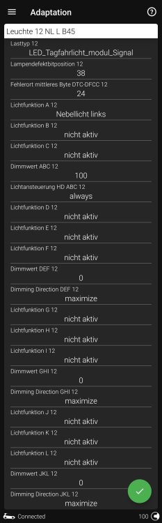

I realise this is an old post, so not sure if I'll get a response, however...
I have OBD11 Gen 3, and I don't have CD 12 or CD 13 as options...
Does anyone know why this is, or if it would interfere with this coding potentially working on my 2021 mk4?
