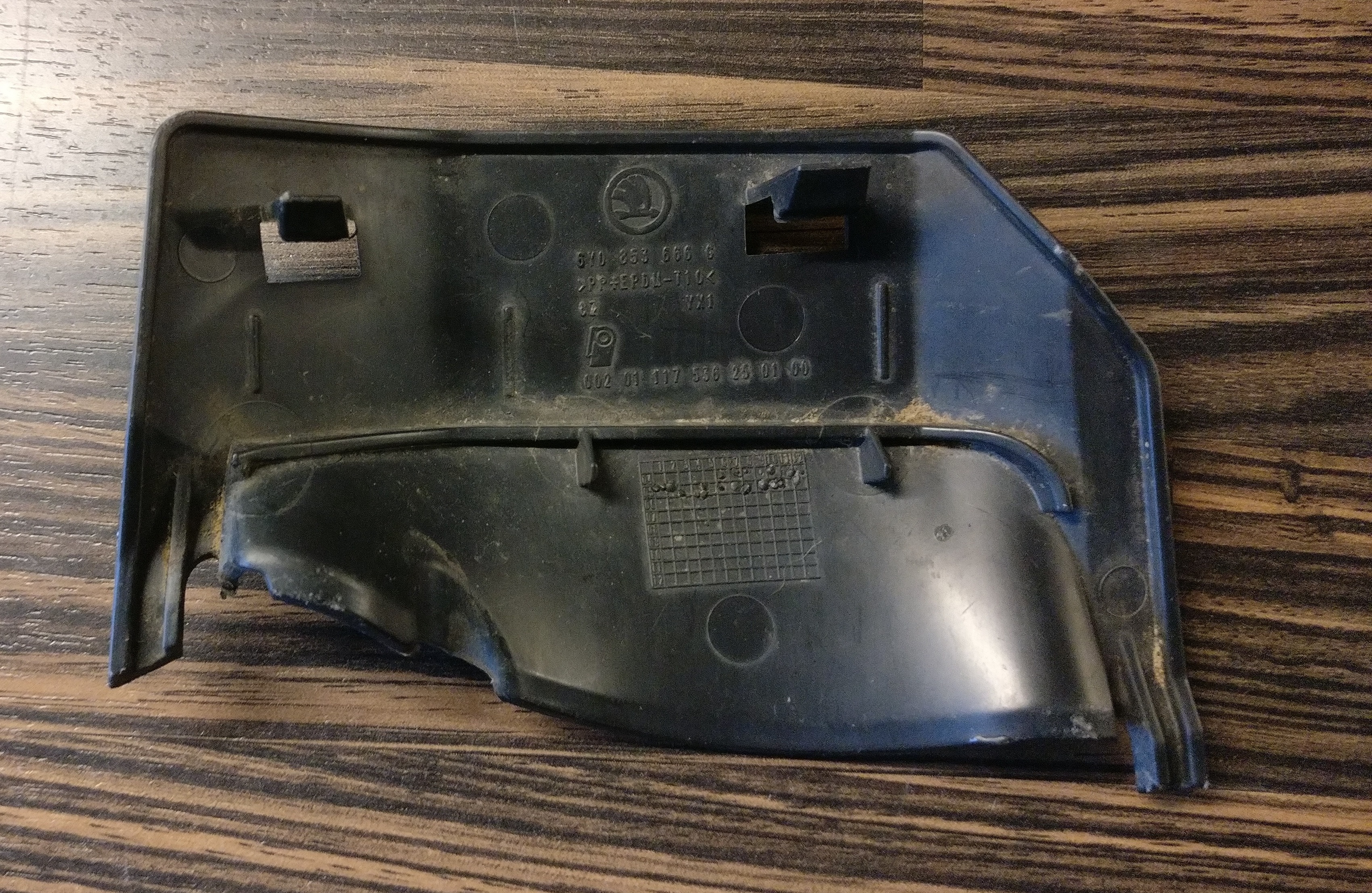

 The part in the attached images had the code 6Y0 853 666 G and is off a 2006 Fabia. When I took the bumper off this part fell out and I can't for the life of me work out where it fits back to. :blink:
If anyone has any information that would be much appreciated!
Thanks

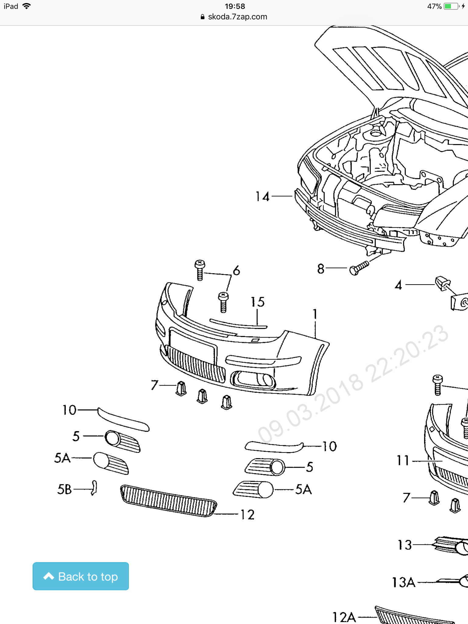

That's what I thought from looking at some drawings online but they aren't very clear as to how it mounts

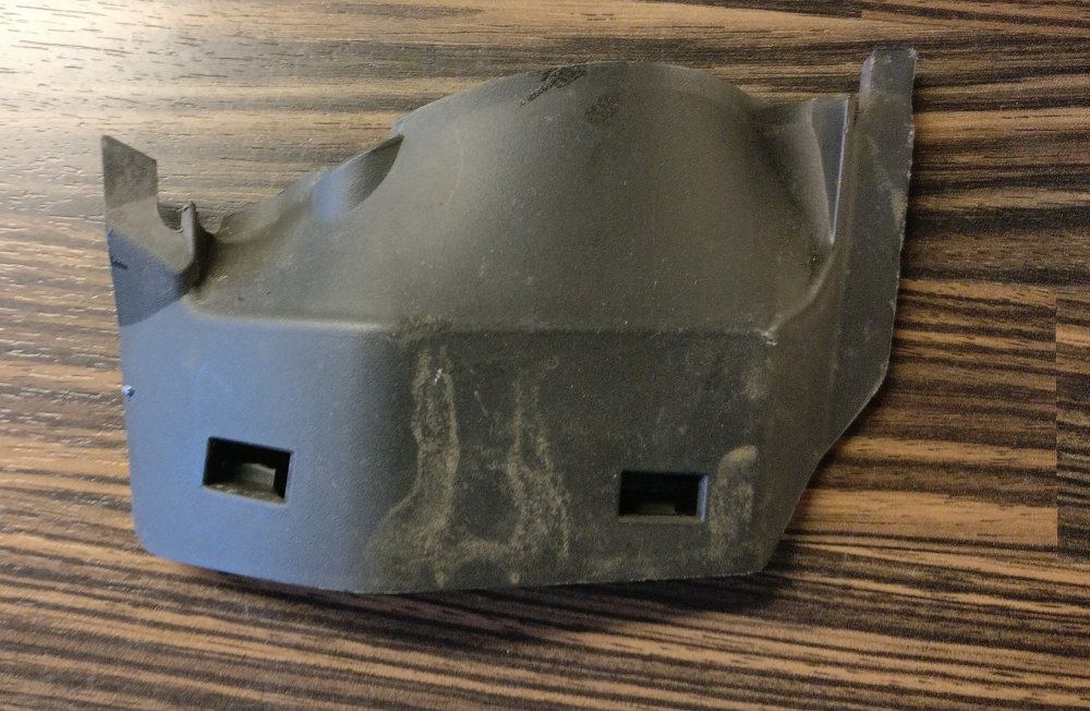

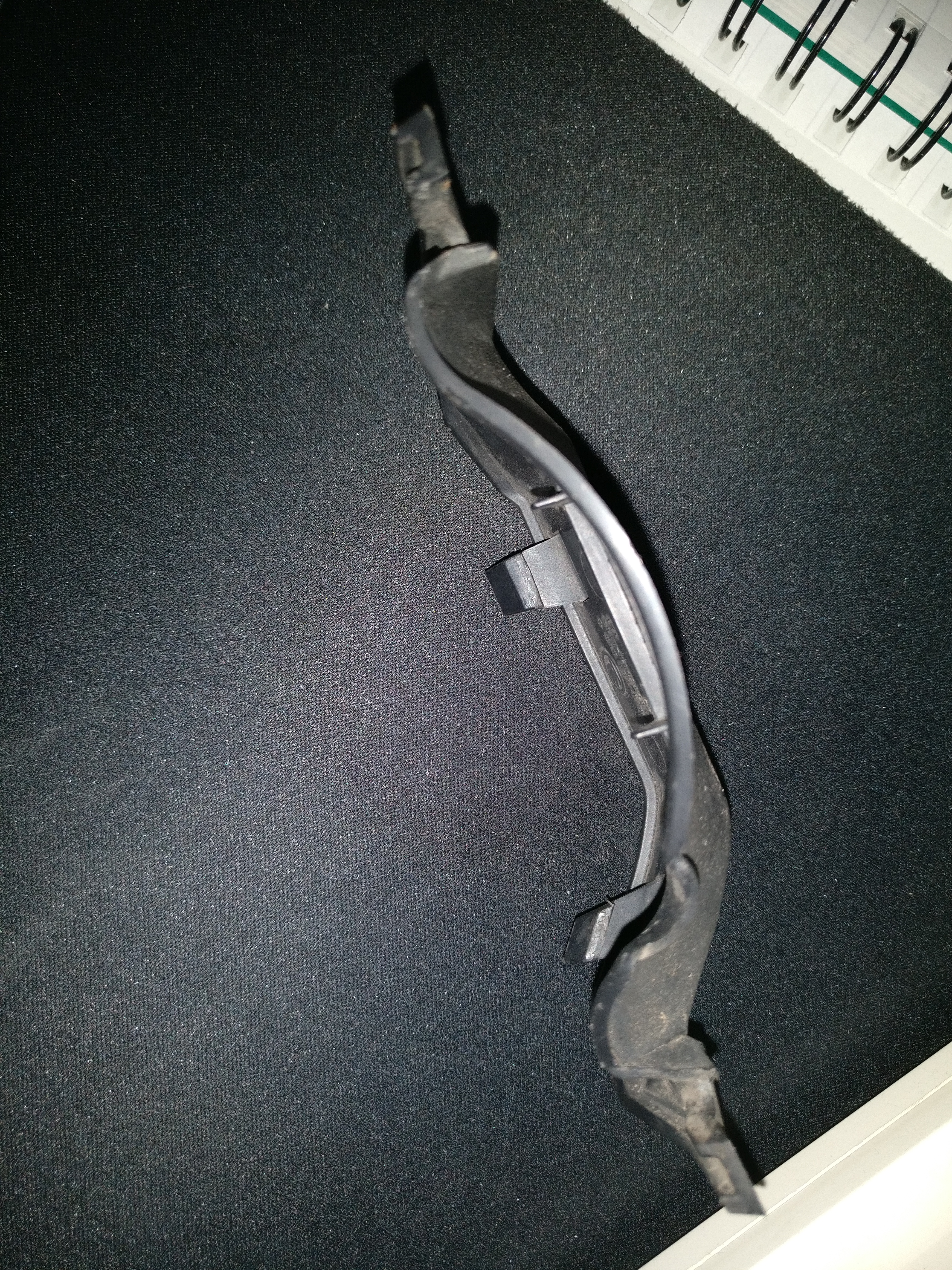

It looks as though you'd piece may be a bit mangled the two cut outs are push in clips. The bottom end looks broken to me. Any pics of the other side of the piece?

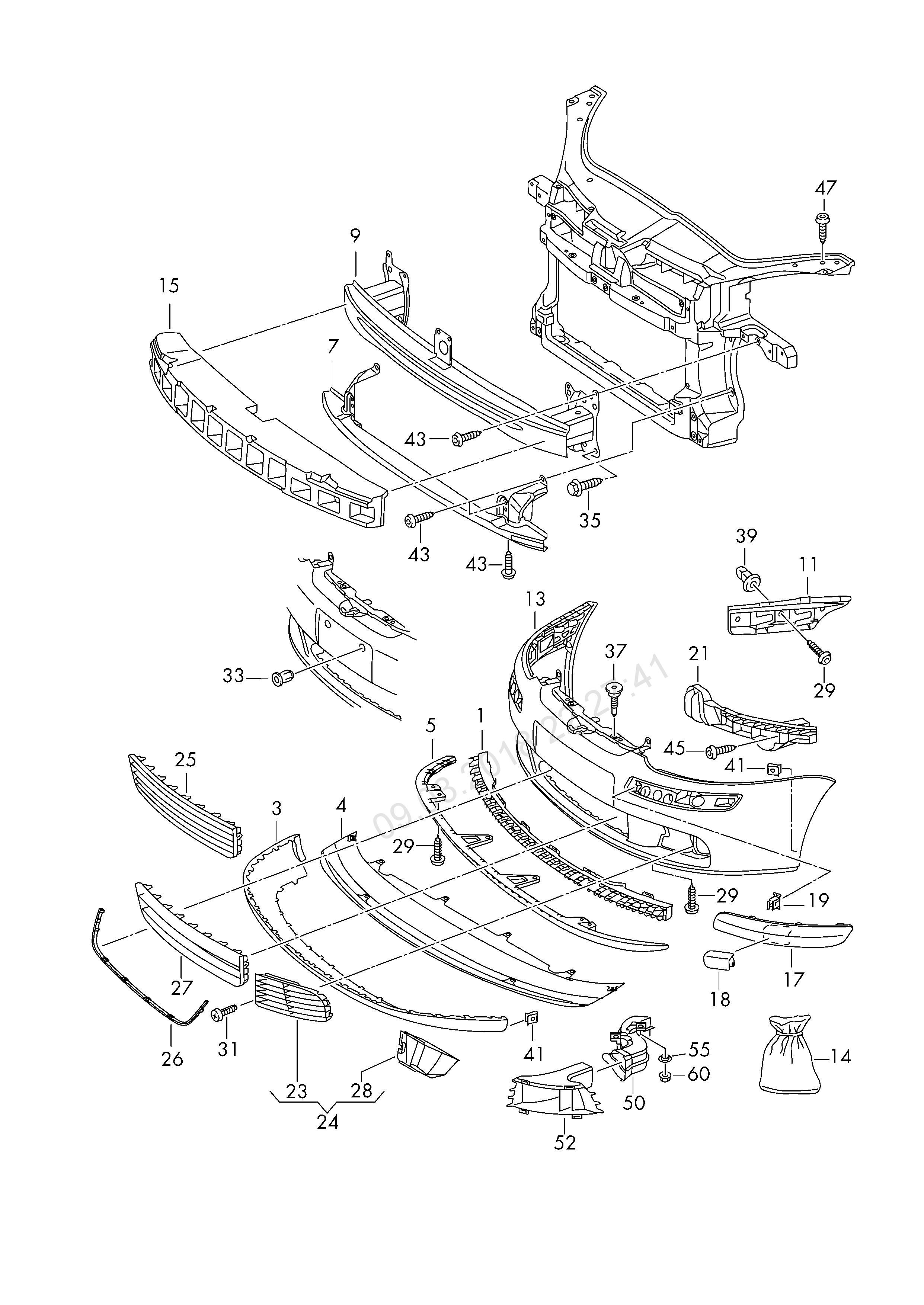

Found this pic it's part number 28. Some kind of air vent. Behind the front fog lamp?

Hi is that image any help? Looking at in person it doesn't look like anything has cracked off
That curve will go around the front fog. Unsure if it’s top or bottom of the lamp though, maybe a second half still there or lost? Part number shows it’s for the right side
part 5b on this pic. So outside of right foglamp trim it clips in around the fog light and the curve would go down the inner side of the foglight

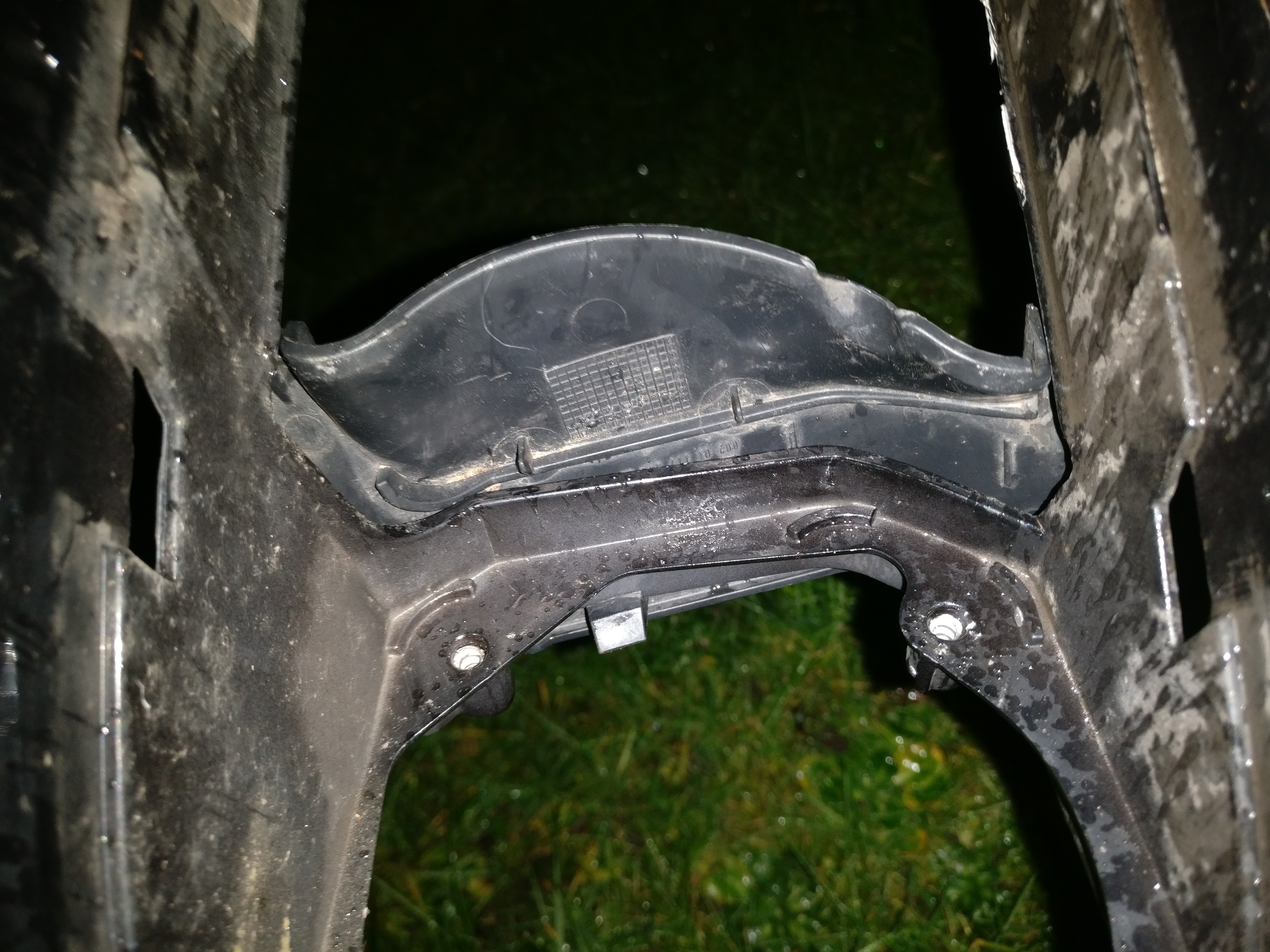

Thanks everyone for the help with this. As promised these are some better photos of how it fits:
You first have hook the two "prongs" or lugs on the front of the part behind the two "rails" cast into the bumper as can be seen above.
The part then clips round the back of the fog light bracket as shown
And this is how it looks when installed on the car. I've no idea what its function is really, all I can't think is it's just to help with directing air into the inter-cooler?
