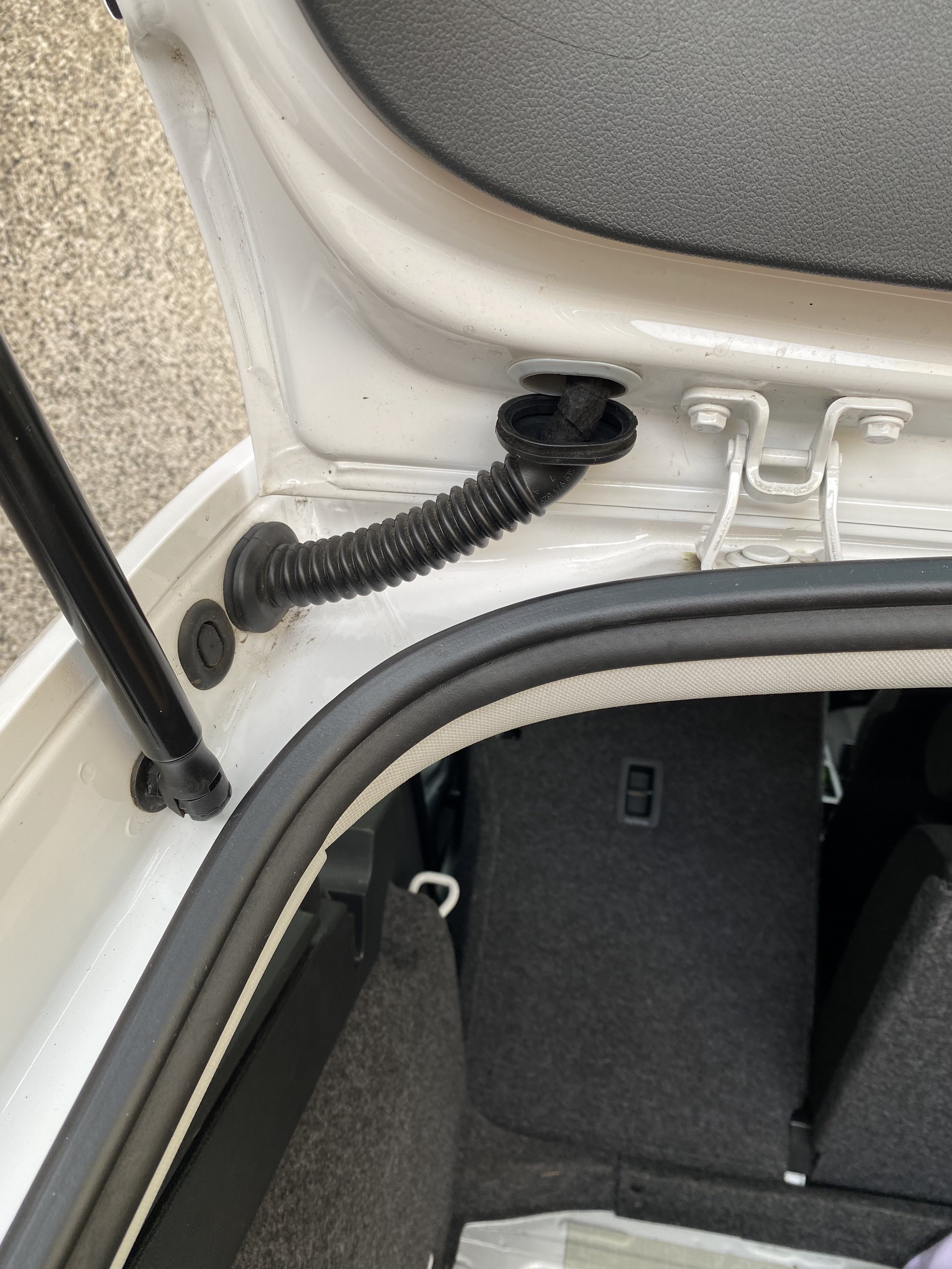

I’ve not seen anything leaking that high up or in the area of the brake light under the rear spoiler where the washer outlet is.  The carpet on the left of the inside of the boot is wet and I can feel that the foam stuff under the carpet on the left side inside the boot is wet.
it looks like the pipe that services the rear skoosher runs behind the trim on the nearside of the boot and goes up to the brake light assembly through a flexi hose that you can see with the boot up.
I took off the trim from inside the rear hatch/door inside.  Eventually I was able to see a 90 degree bend in the pipe that feed up to the washer in the spoiler.  I fooled the car into thinking boot was closed by flicking the lock, and operated the rear wash, it was leaking from above the 90 degree bend in my case, and it would find it's way down to the wheel well.
Might be easier to check this area, to rule it out as you can get access to that easier than removing the side trim.
I’ll check that tomorrow.
Was there a 90° elbow coupler that the pipe had popped out of in your case?  Was it nearer to the left / nearside of the boot door or did you have stuff leaking down at both the left and right side?
Found this youtube video for removing the trim.  The washer outlet on that one is at the left of the light whereas mine is on the right:
Decided that pulling the rubber gromit off the inside of the boot and skooshing the rear washer while it was off was a better way of ascertaining if the leak was from the boot door or in the boot itself.  The flexi hose area inside the gromit was bone dry and stayed bone dry after running the washer but screenwash appeared inside the boot next to the carpet trim on the left.

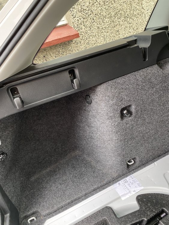

@sutra so I had a crack at this over the weekend due to the nice weather, I was retrofitting an RVC.
In the link below are pictures of what I needed to remove to remove the trim, you'll also see there is a join in the washer pipe right about where yours appears to be leaking (from your photo).
I removed the rear boot trim that has the boot latch on it and the rear pillar trim, also the rear bench and the trim that goes over the wheel arch as this allowed for the trim to be pushed out of the way.
There are 4 fixings, two with the fold out luggage hooks, one behind the rear pillar trim and the other where the rear shelf inserts.

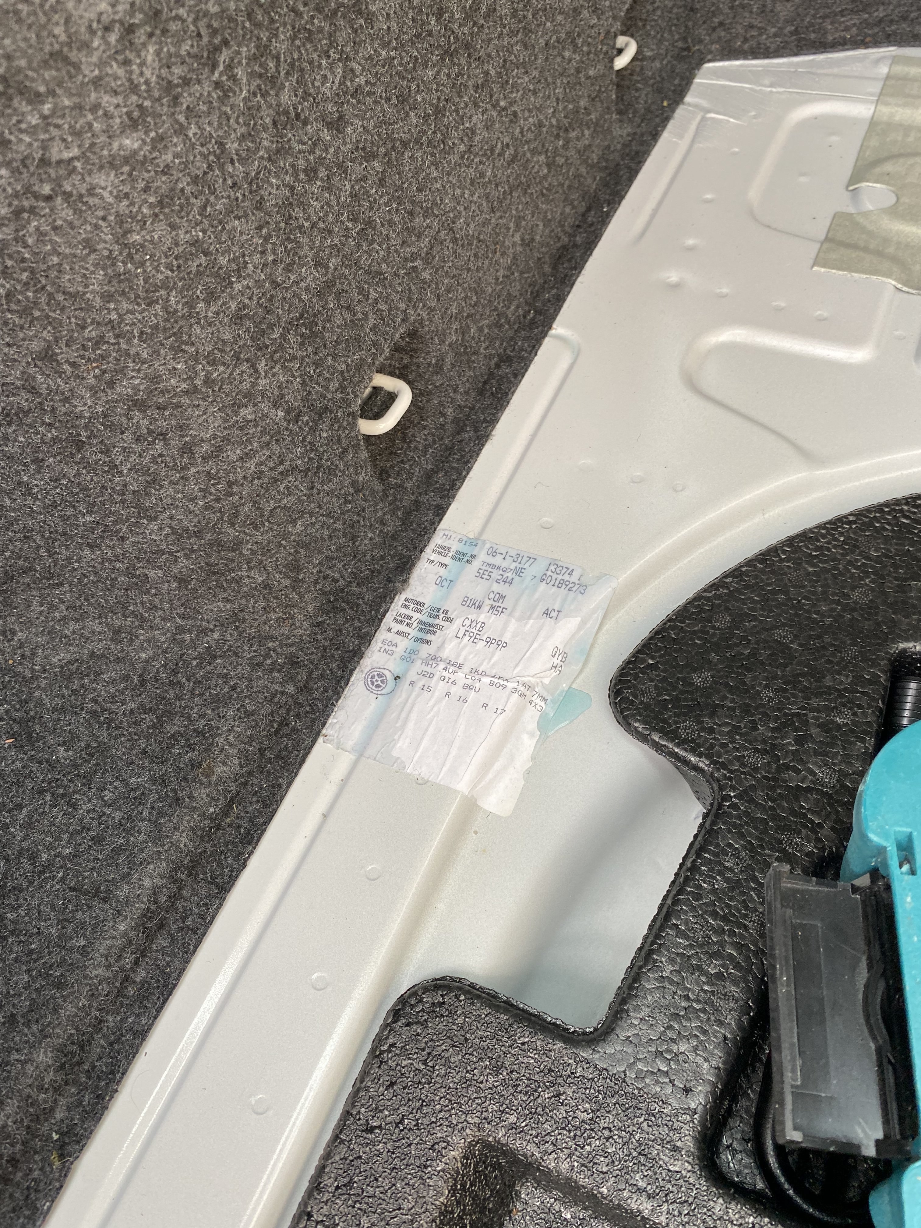

I also had to remove the two netting hooks and finally using a spline bit the lashing point right behind the rear seat, I pictured this separately as it has a cover hiding the bolt.
You'll need to remove the rear luggage light as well, when I started to remove the trim piece I worked it from the rear over the lashing eye/loop fixed to the chassis.
At this point I was able to reach in and disconnect the 12v socket, finally I had to lift the trim over where the seatbelt exits the trim.
I wrapped the seatbelt round the rear seat that was folded down and this allowed me to move the trim far enough away to work comfortably, if you wanted to remove it completely you'd need to undo the seatbelt from the rear bench.
Hope this helps, I think the fixing you were missing is hiding behind the rear pillar trim.
