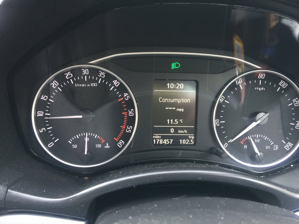

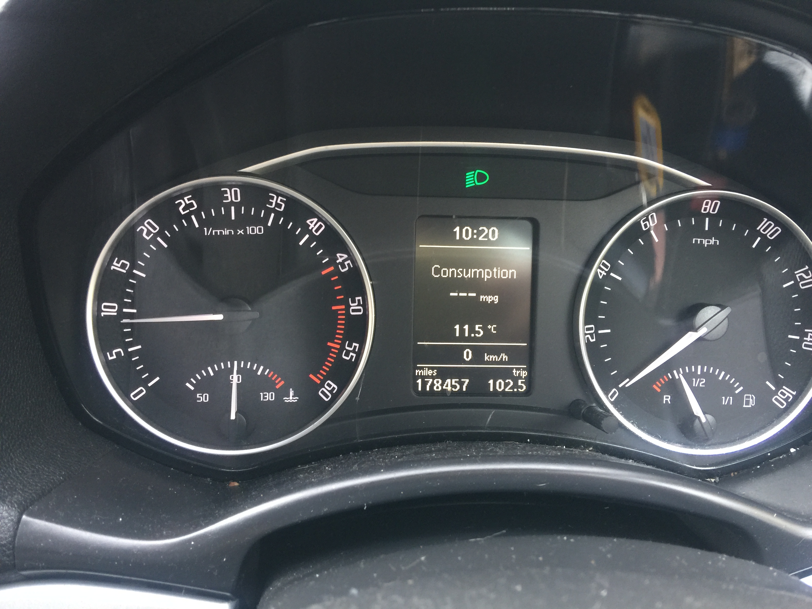

It’s a manual mate, here’s the idle pic from this morning.

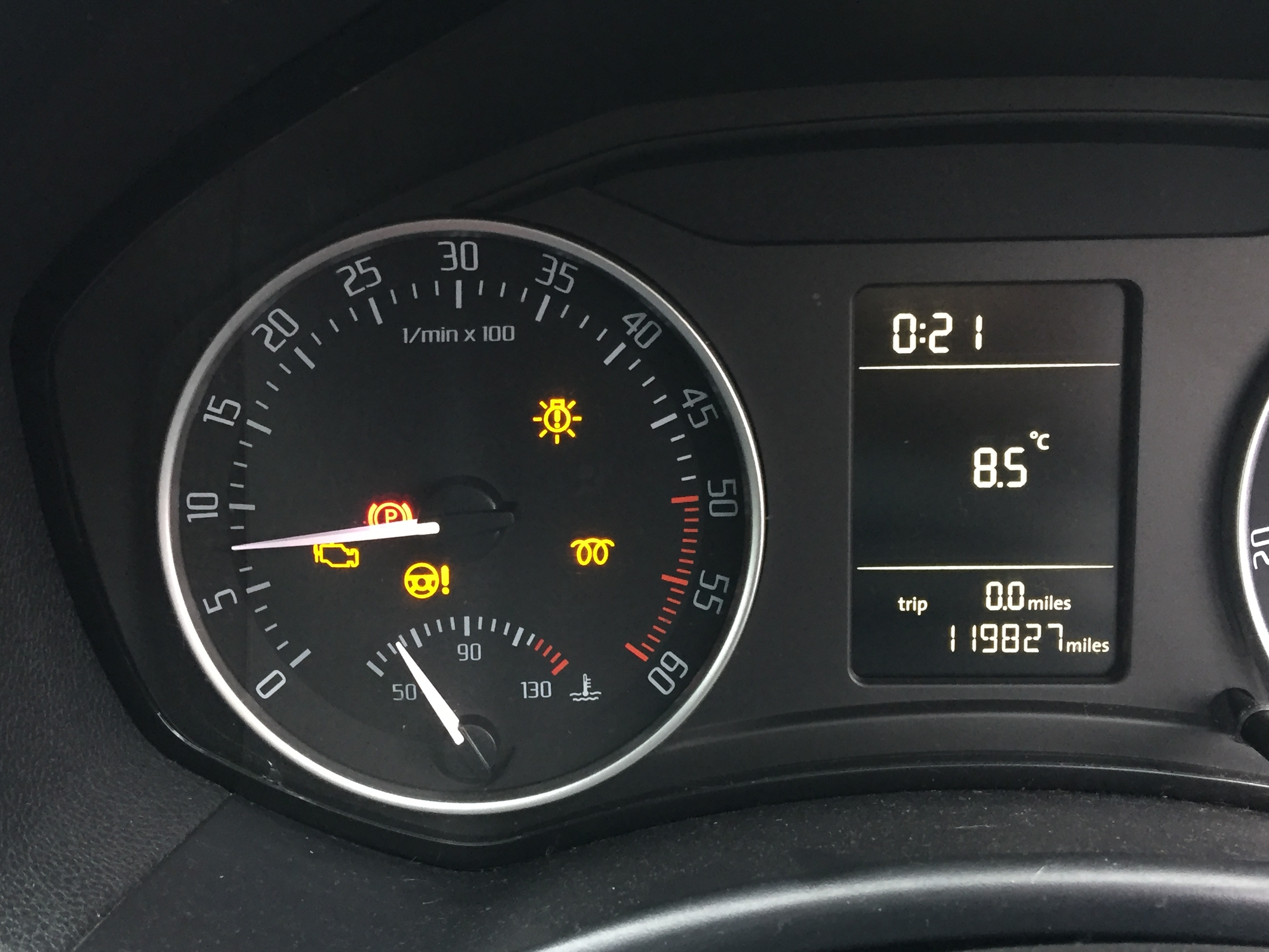

Here’s a photo of the idle on one of the 62 plate Octavia paramedic cars, I no the engines are slightly different but surely the idle is same on all engines?? My engine code is BMM if that helps, on my solus pro it does say that the idle target is 750 rpmbut actual reading on solid is 830rpm
