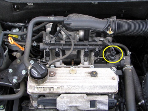

Picture ripped off from another post:-

I don't think so. There seems to be a temperature sensor in the thermostat housing, of course that had to be removed. I didn't see any other sensors. The Lambda sensor in the exhaust was also left in place untouched as I left the exhaust attached to the manifold.
What about the MAP sensor on the back of the intake manifold? Haven't disturbed the wiring or anything?
This was disconnected when the inlet manifold was removed. It was reconnected when the manifold was remounted.
