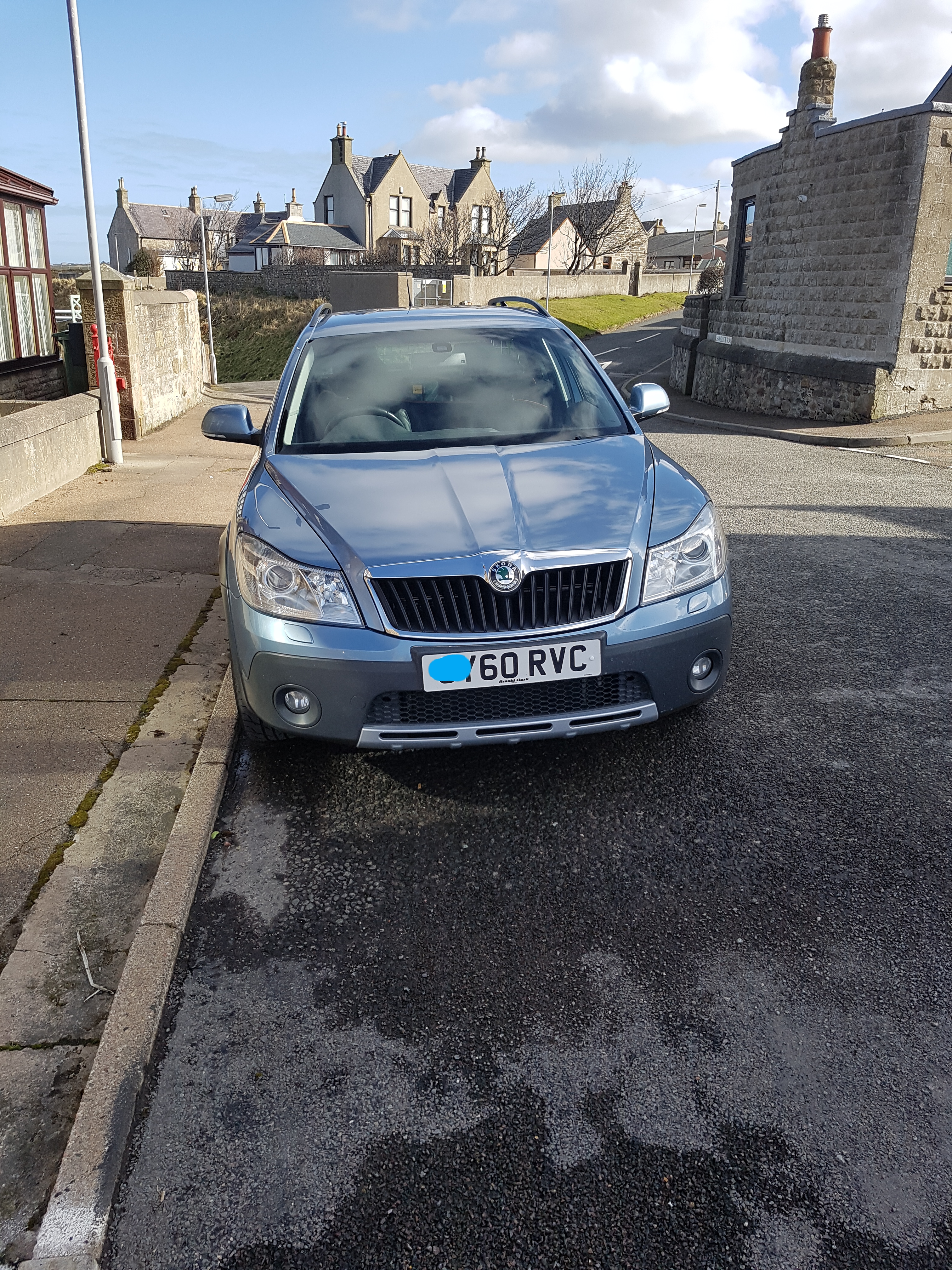

Send a photo of the front view of your car and you will get the information.

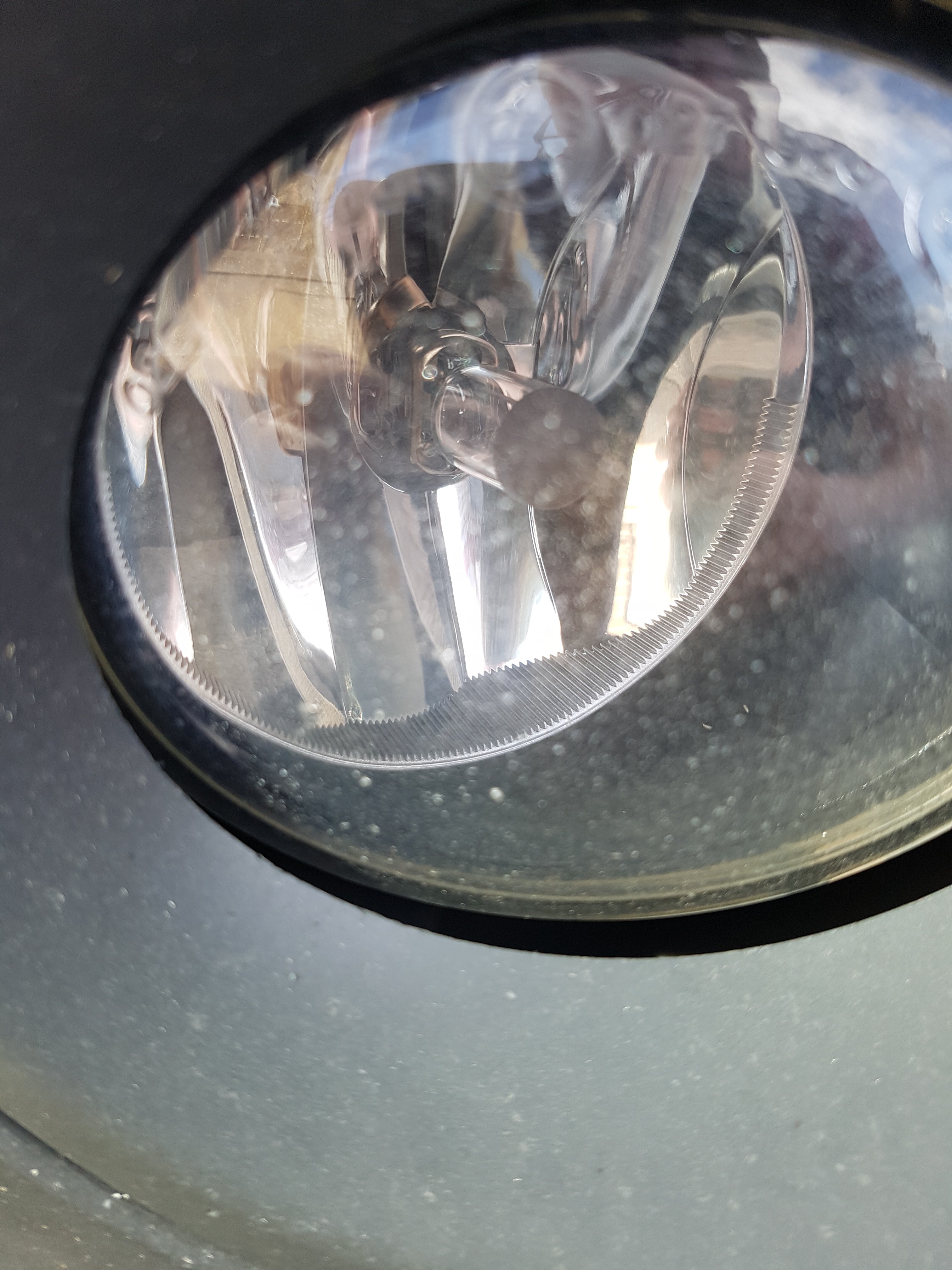

It has fogs but they just look like normal ones to me
Edited by mustang86
Missing pic
That's a fog light.

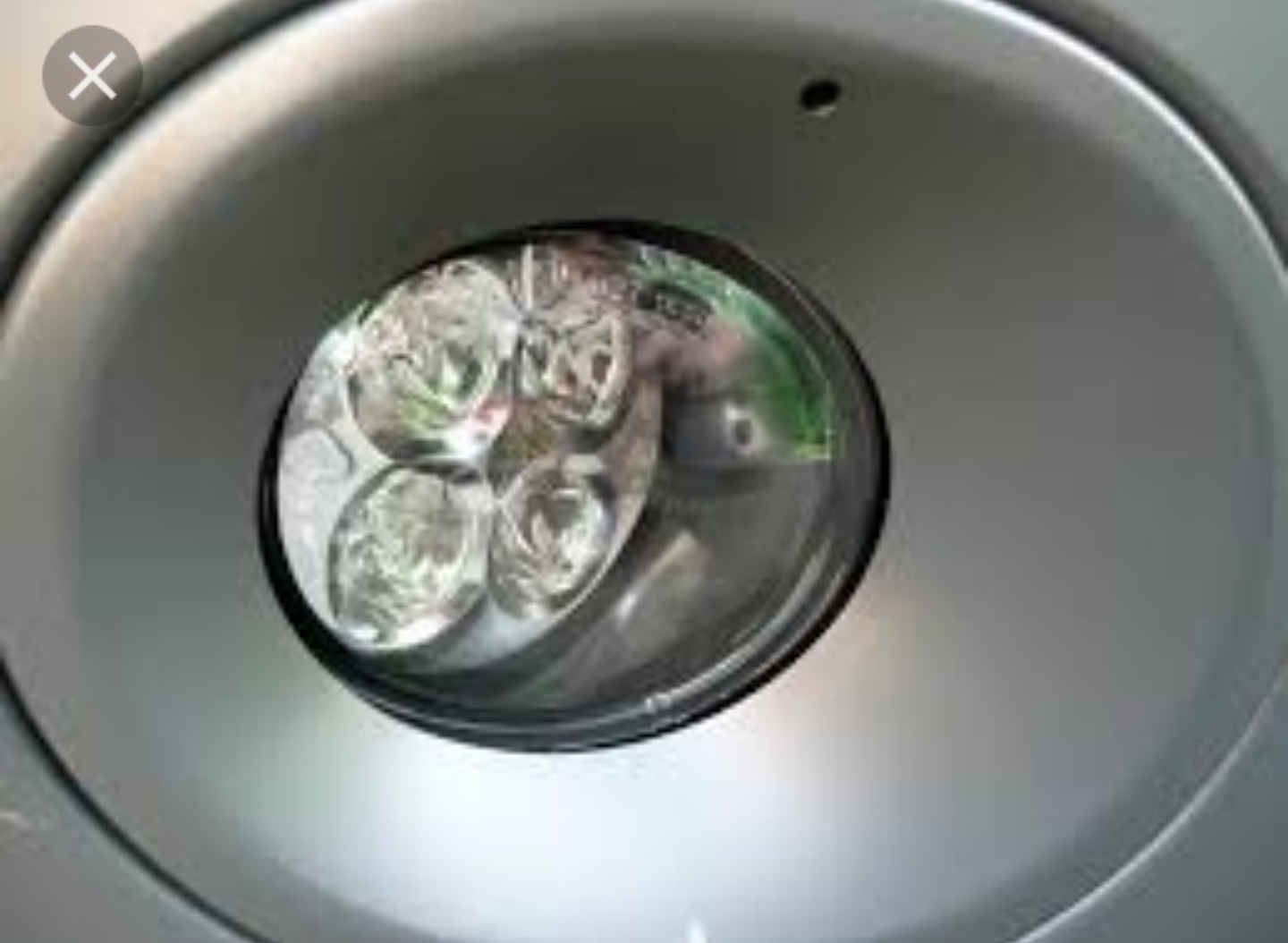

The DRL's are 4 LED's.
You can get the fog light coded to act as a DRL, but I'm not sure if that means you will lose them as a fog light and/or the cornering function, which I really like.
This is about the best image I could find of a Scout DRL after a quick Google:
