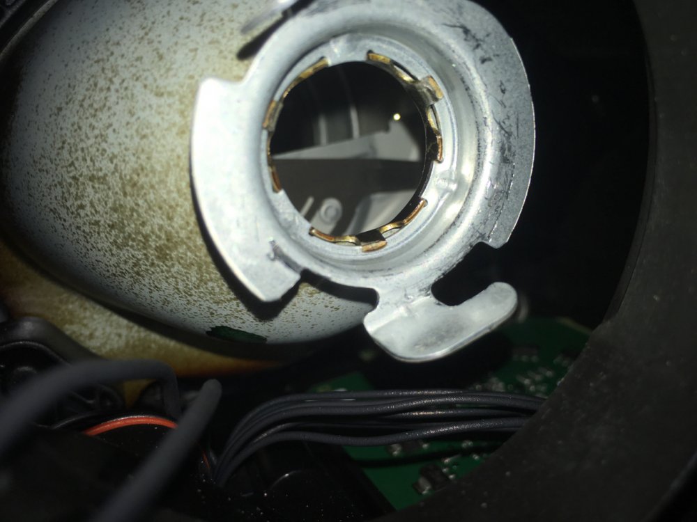

My car has the projector type headlamps with the H7 bulbs. It's a 1.2TSi. ( Are the relevant parts of the Diesel layout different?)
I renewed the bulbs again, 2 or 3 months ago - and this time around - I found it much, much easier to do. The Nightbreakers that were installed about 18 months ago had failed.
Anyway - on the off-side/Driver's side (RHD car) is easy enough - just hold the plastic connector as firmly as poss, and rotate anti-clockwise ( from the bulb's perspective !! ) about 10 degrees should do it.
It might help to know that you are twisting out, of a Bayonet fitting.  ( which does help to know, when you're re-installing )
 Some pics attached below.
So, you withdraw the plastic connector with the bulb. ( This is attached to a metal carrier which is the "other side" of the Bayonet. Pic 1 below)
Replace your bulb ( observing usual halogen-handling care ).
Note the location of the bayonet tabs on the bulb side, and the bayonet slots ( ref. pic 2 below ) , on the headlamp unit side.
Offer the bulb carrier back into the headlamp unit.   Just twist (clockwise) that little distance that you see on the pic. "Not a lot".
On the nearside/Passenger side (yes- RHD car !), I found it essential to remove the battery. This is very easy. Clamp bolt for battery  ( either a 13 or 15mm, can't remember just now ), and then

The Main Beam is similar - but not the exact same !  It's still a bayonet, but the metal carrier is a smidge different in design - the bayonet lugs (IIRC) are made from
two Allen head screws - the bayonet tabs on the bulb carrier are slotted in below the heads of the screws, as I recall. Anyway - that's for another day!
I expect all of this is different for the non-projector H4-bulbed cars?
