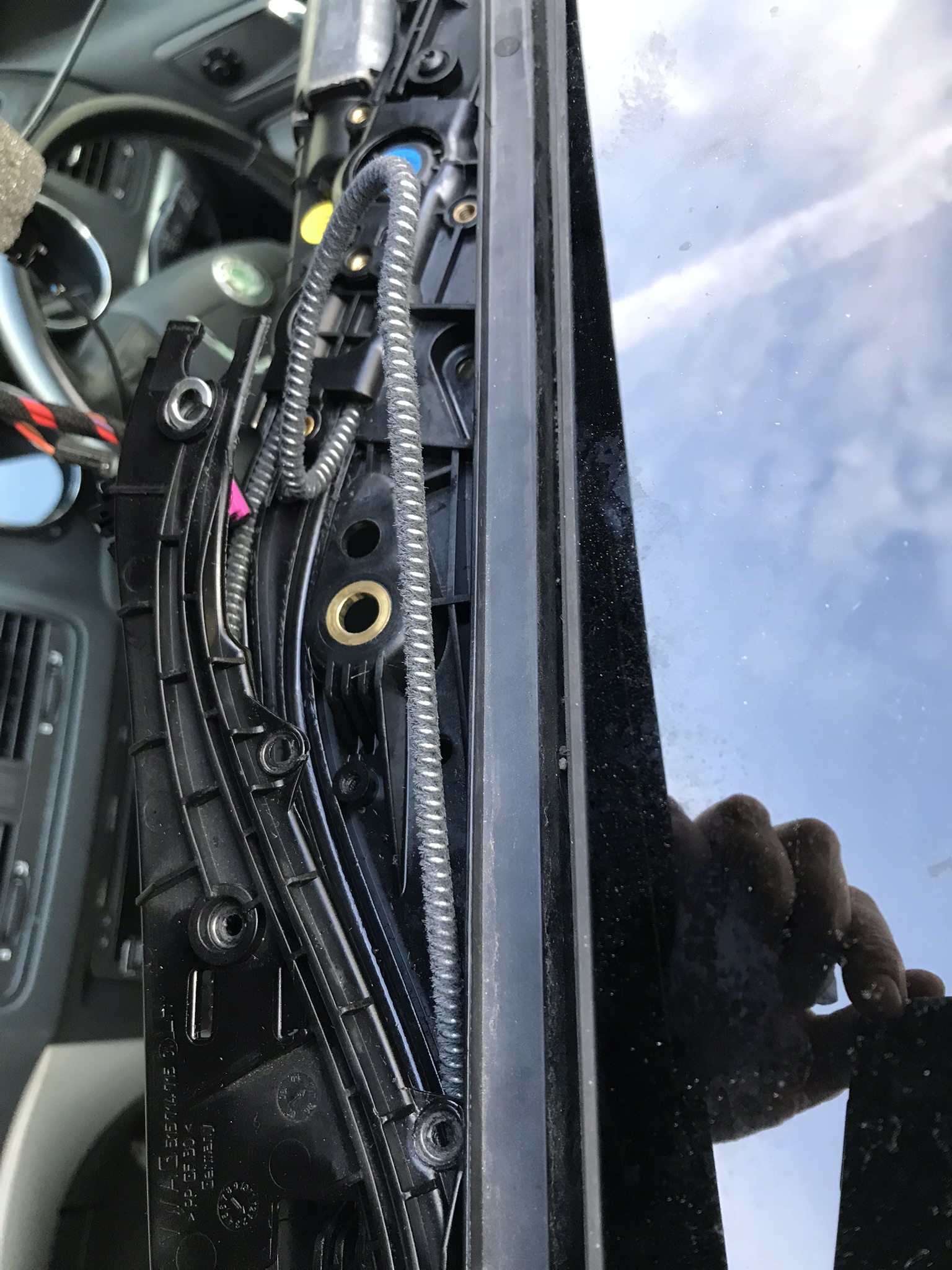

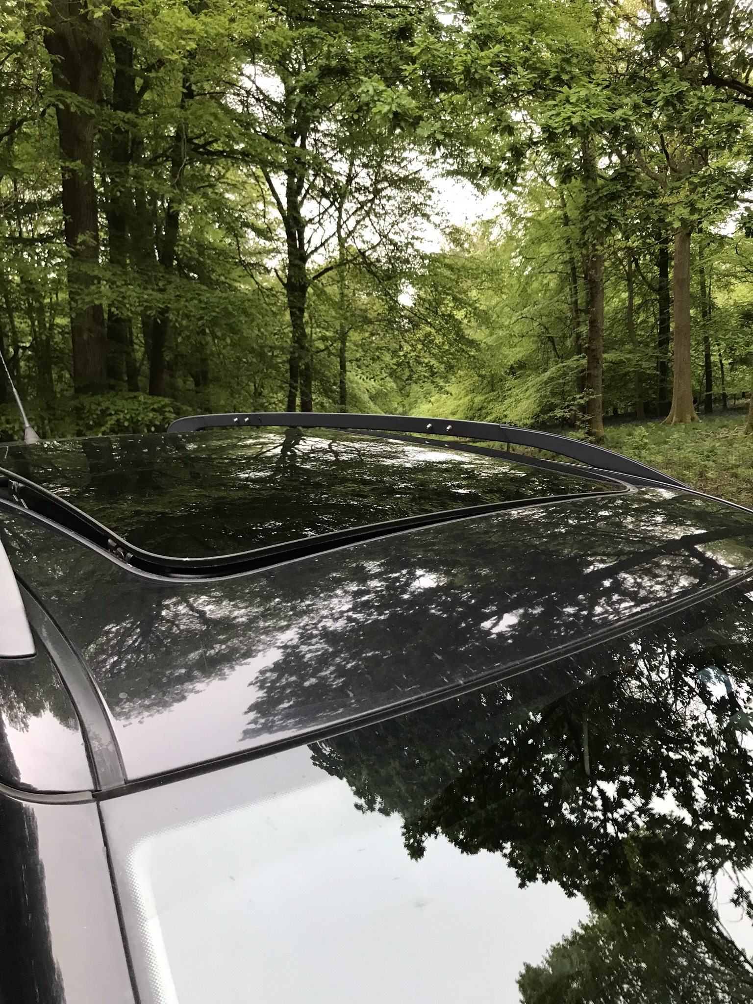

Similar thing happened to me 2 weeks ago (with rear discs, sunroof and recently a/c issues this has not been a good month!).  Went out, opened sunroof, there was some loud noises and the left side tilted a little and the right hand side tilted a bit more then everything stopped.

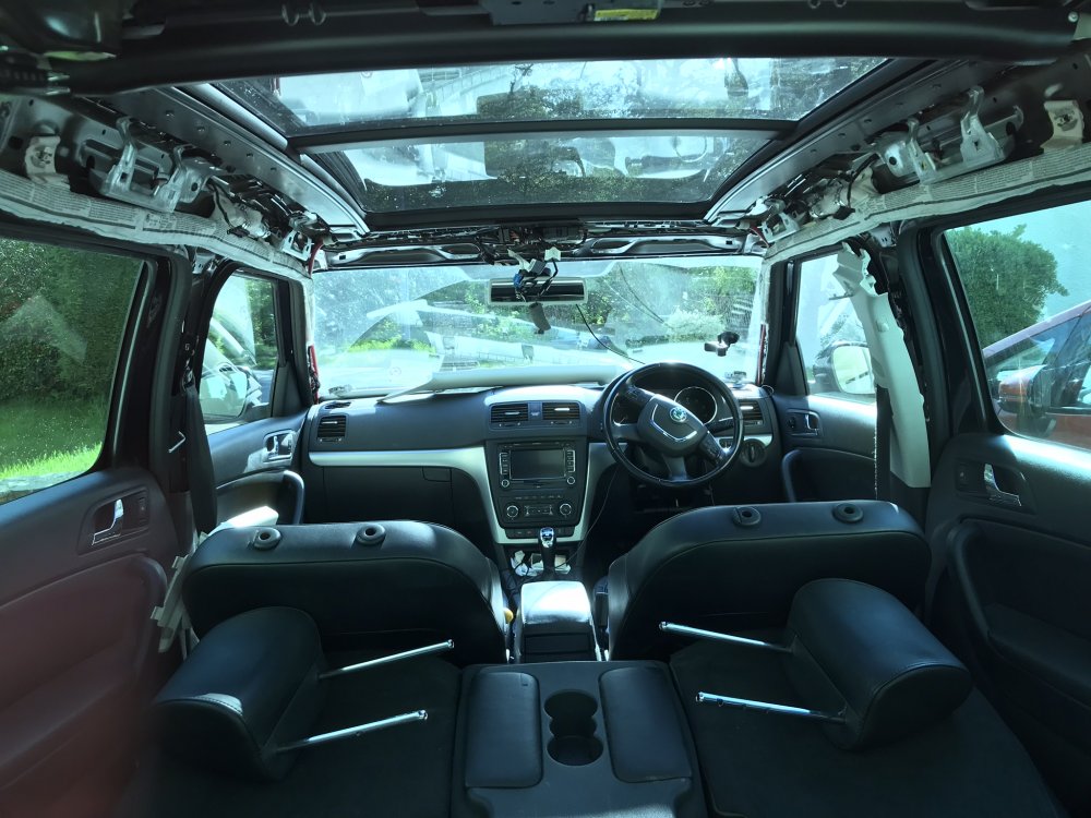

It was a Saturday night so no garage options ... found in the manual the emergency close (remove glasses holder, use allen key to manually turn driver motor) that closed the right hand side but the left didn't move.  Saturday evening and Sunday was spent stripping out the headlining, then removing the panoramic roof.   At the front of the roof, on the top are 2 channels that the drive cords (looks similar to a pipe cleaner) run through.  The plastic cover on the left hand side had deformed and the cord escaped the channel and twisted into a loop and jammed.
I took the drive motor off, straightened the cord and could then manually open and close the roof by pushing/pulling the cords/roof.  Moved it to the closed position and reassembled everything.  Have now disabled the sunroof by driving the motor to fully open position then disconnecting the switch and moving it to the closed position and reconnecting.  Now if anyone tries to open the roof (from the sunroof control or global open) t doesn't work.  I did this after using global open to cool the car and having to repeat the whole task 4 days after the first time.
Took approximately 3 hours to strip out (need two people to remove headlining and roof) an hour working on the roof and 2 hours to put everything back together.  Slightly quicker second time round as I didn't remove the pano roof from the car, just dropped it onto the jacked up seats/headrests and worked on it in situ.
