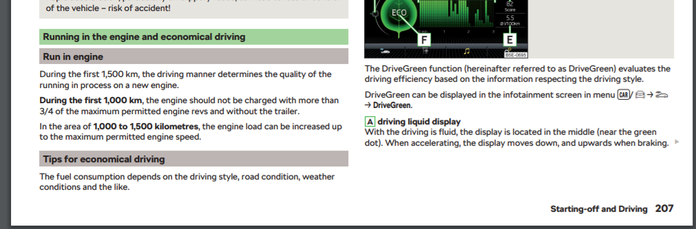

This is covered in the manual for my Suberb TSi, not sure if it is in the Karoq.
Page 207 of the Karoq manual:
