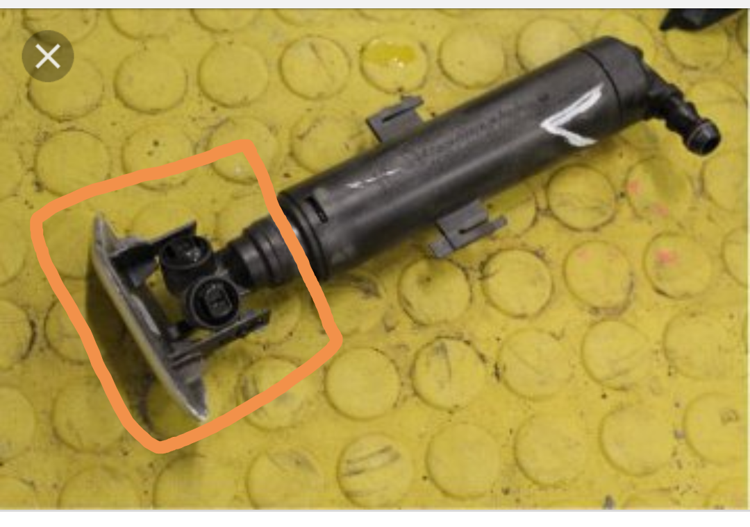

Not sure what's happened but I'm missing a washer jet all I know it was there sat and now it's not lol.
Does anyone know if I can replace the 2 part in the square?  Or do I need to replace the full unit?
I've found these 2 parts so was hoping to just push it into place:

Yes you can just replace that part, it fits in on a ratchet mechanism so you just push it in as far so the washer cover sits flush with the bumper.

Mine is the passenger side is it possibly to fall out or has someone stole haha?
if the clip was broken/weak, it could have blown out when the washer operated. They work under quite a bit of pressure so it wouldn't be too difficult to dislodge it
