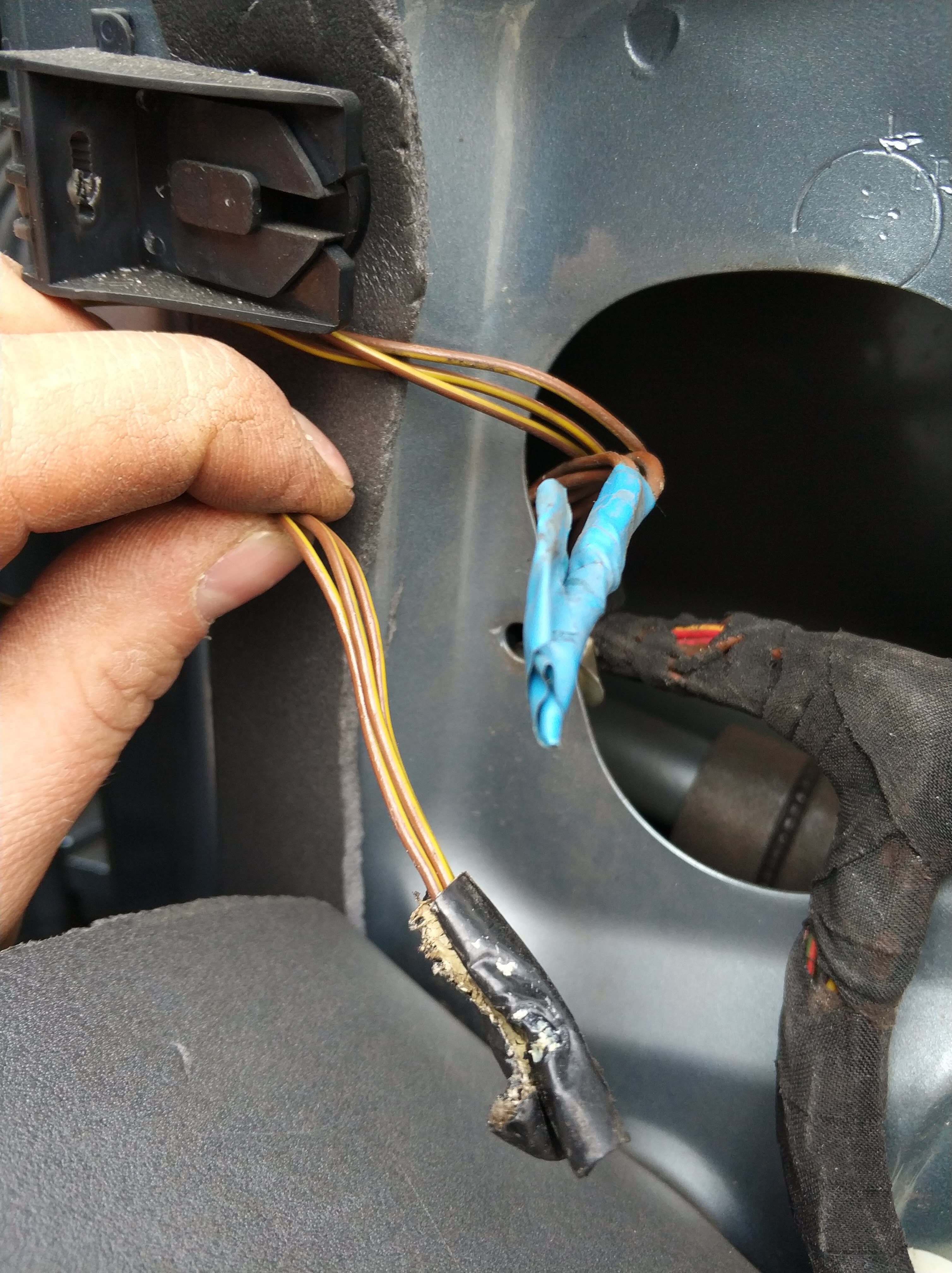

There are some brown and brown/yellow wires just taped up in the door, near where they come through from the car.
Does anyone know what they do or have a diagram?

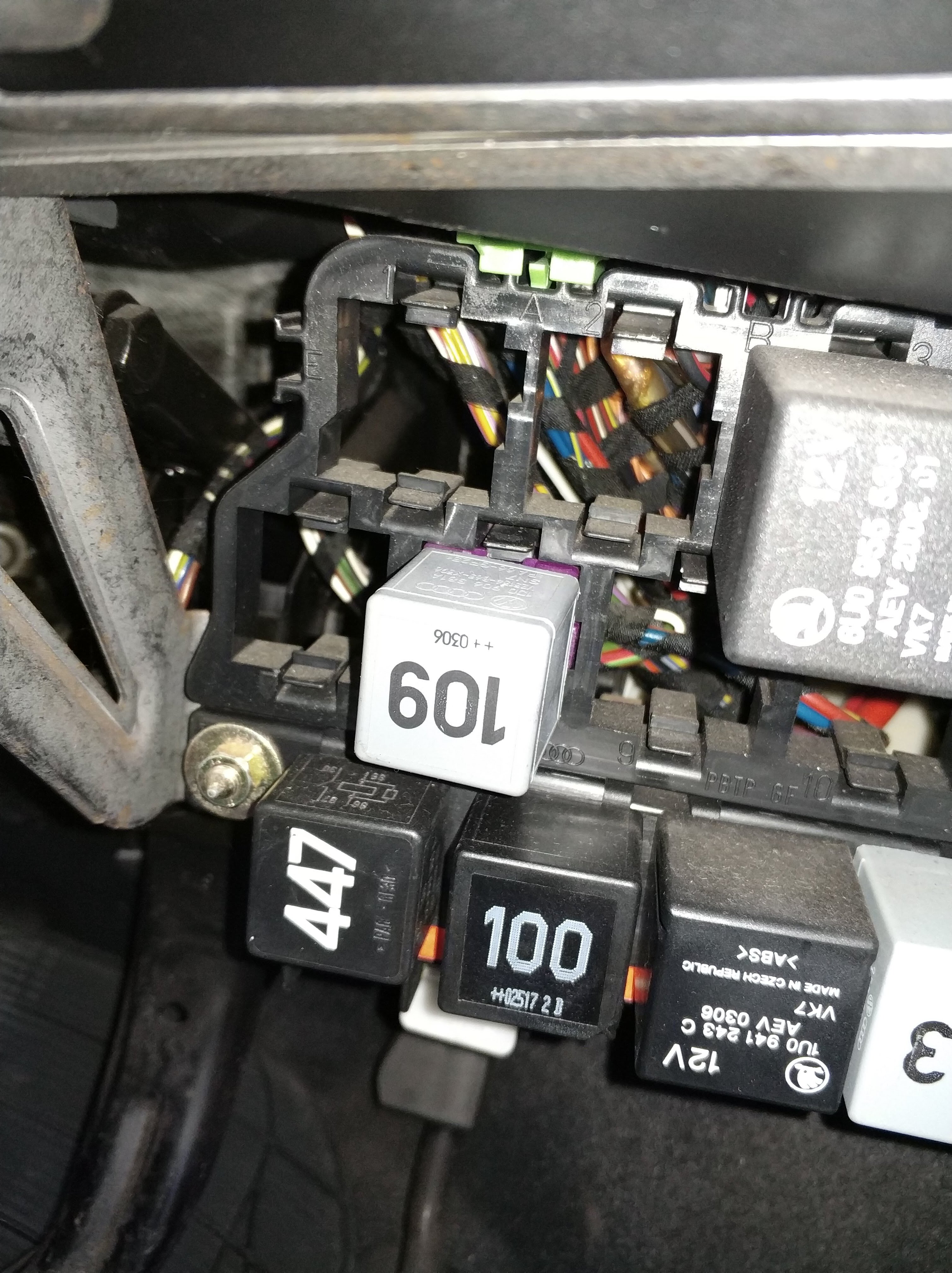

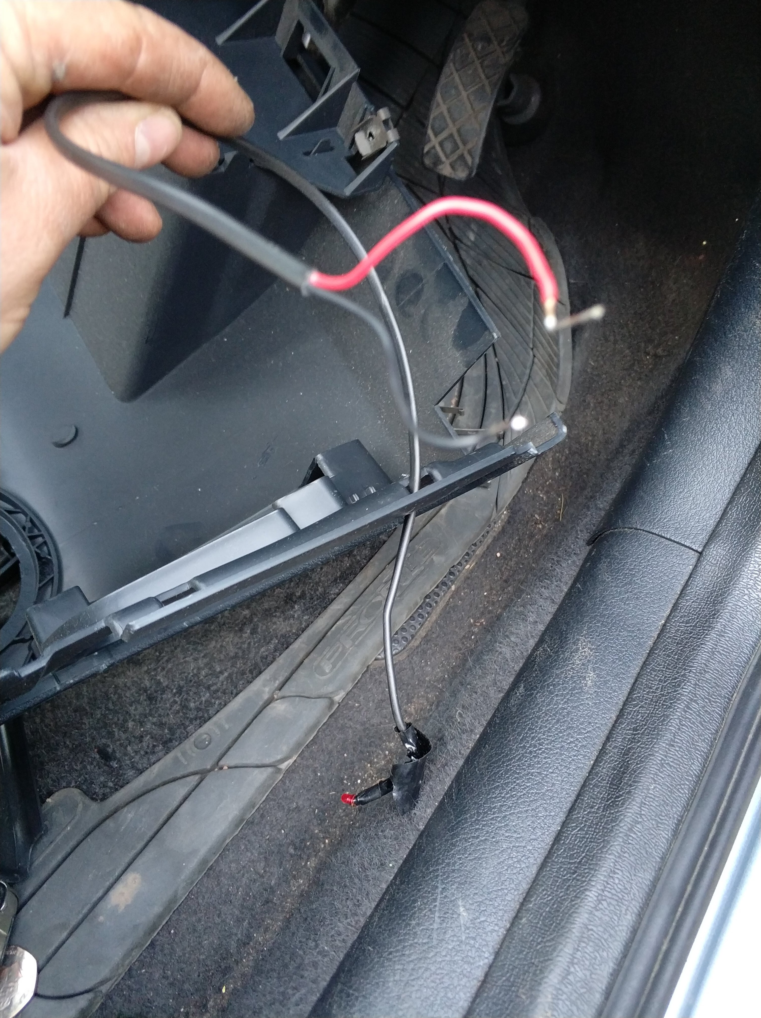

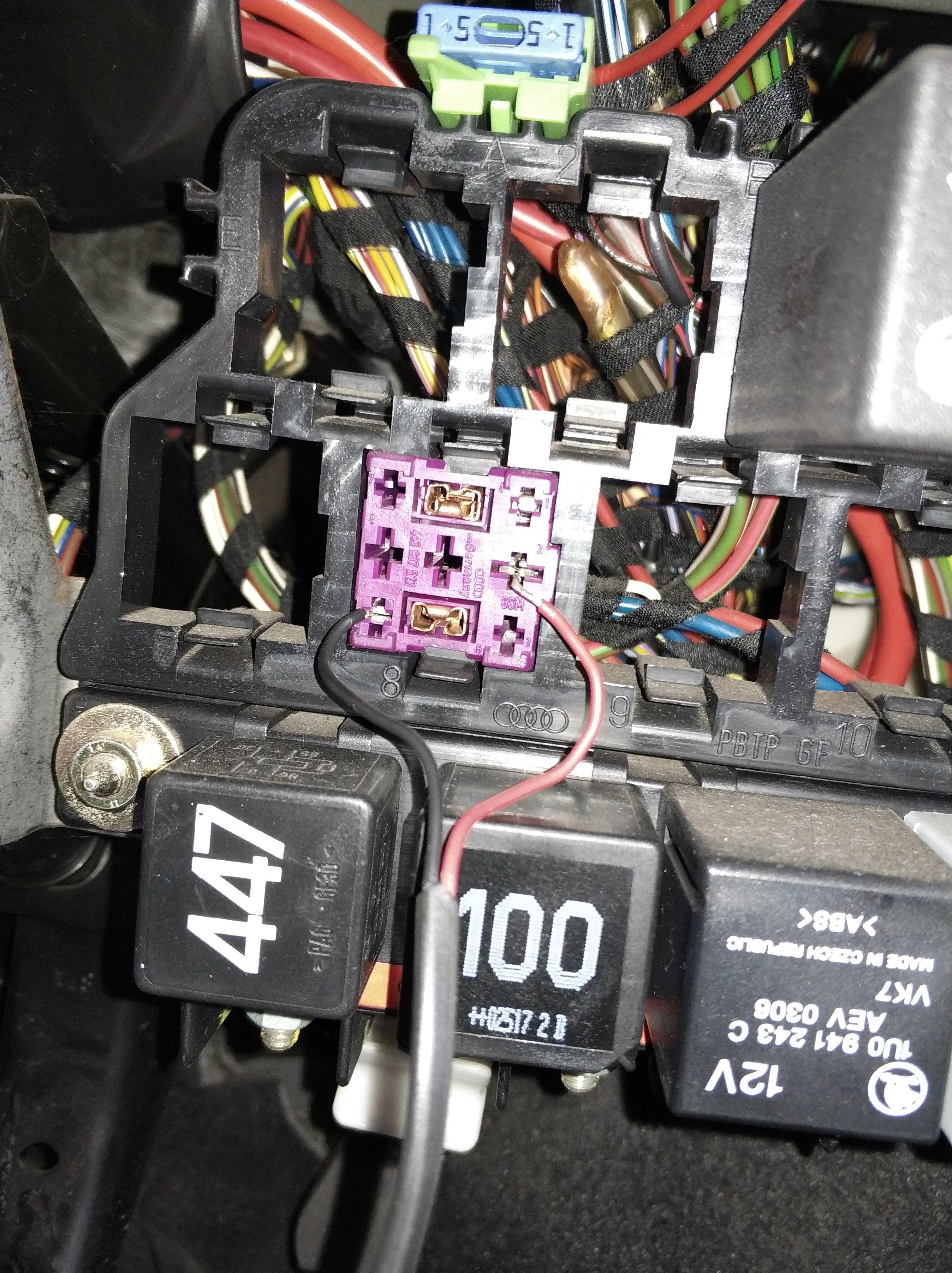

Also there was a random DIY led just pushed into the terminals for the 109 relay? any ideas what thats for an why someone would do that?

Could be a previous owner had been doing some really basic relay function testing/ monitoring to prove a faulty 109 relay was a cause of starting issues? Relay working - led lights up. Relay not working - starting problem and no led..

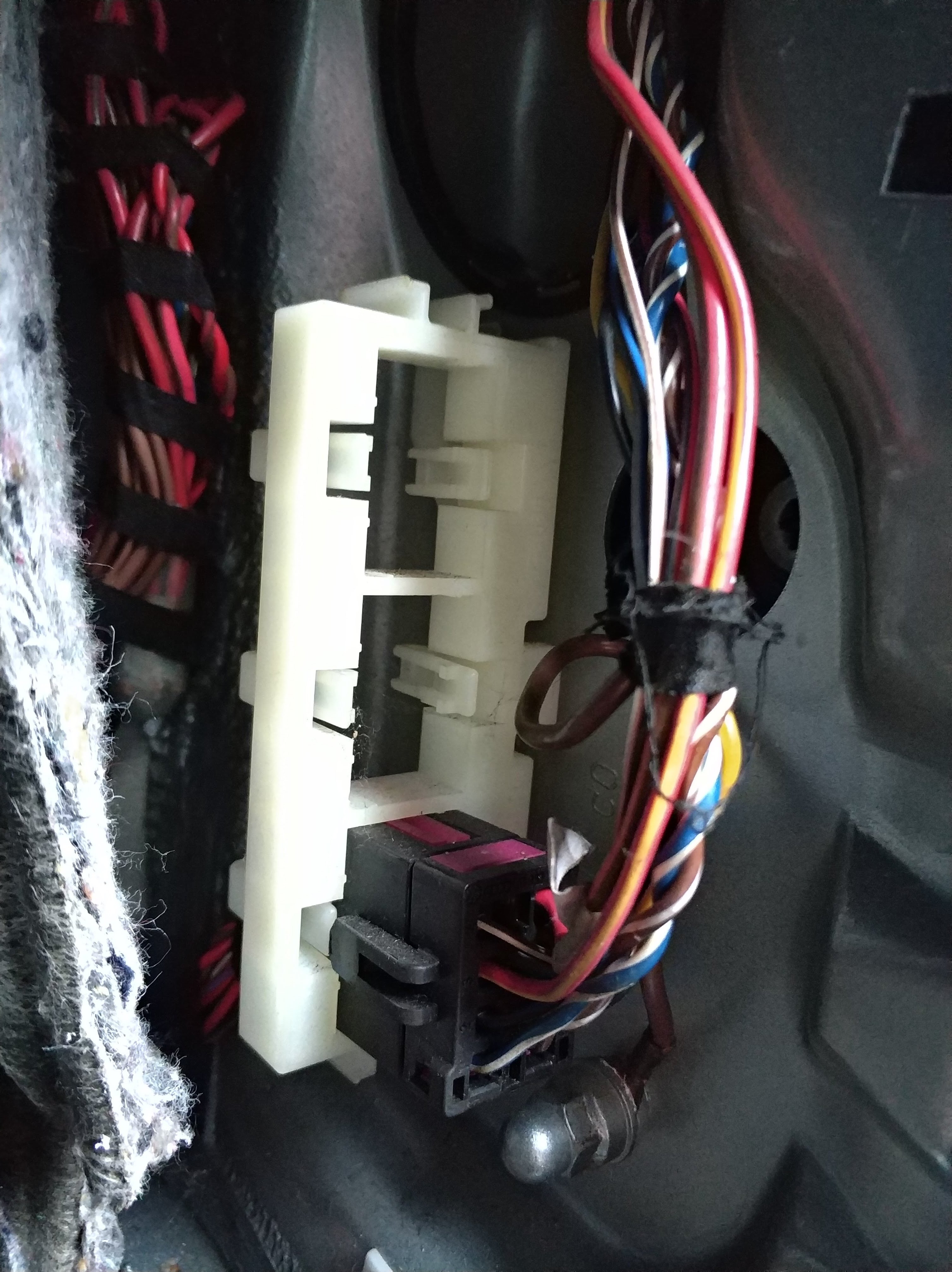

Turns out water had been getting into the 29 pin connector that goes into the window motor/regulator. Pins had corroded and snapped off into the loom. New loom cost £120, but eventually tracked down motor which is specific to the L+K Octavia second hand. Just preying it's ok when it arrives
