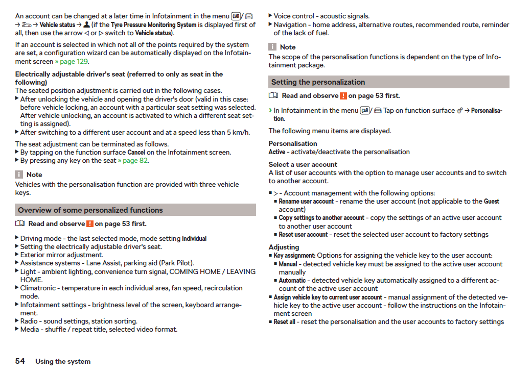

I think you need to follow the Personalization to assigne the key to your settings.image.thumb.png.047e1762e2b7743c12be01832e5d2f4c.png

Helpful, thanks - will give it a go

I saved my seat settings, but every time I unlocked the car, the seat moved forwards and upwards.
I was informed by the local Skoda dealer that I had gone beyond the parameters of the seat - go figure!
The only way I could find to stop this from happening was to switch off 'personalisation' in the settings menu. Not impressed.
