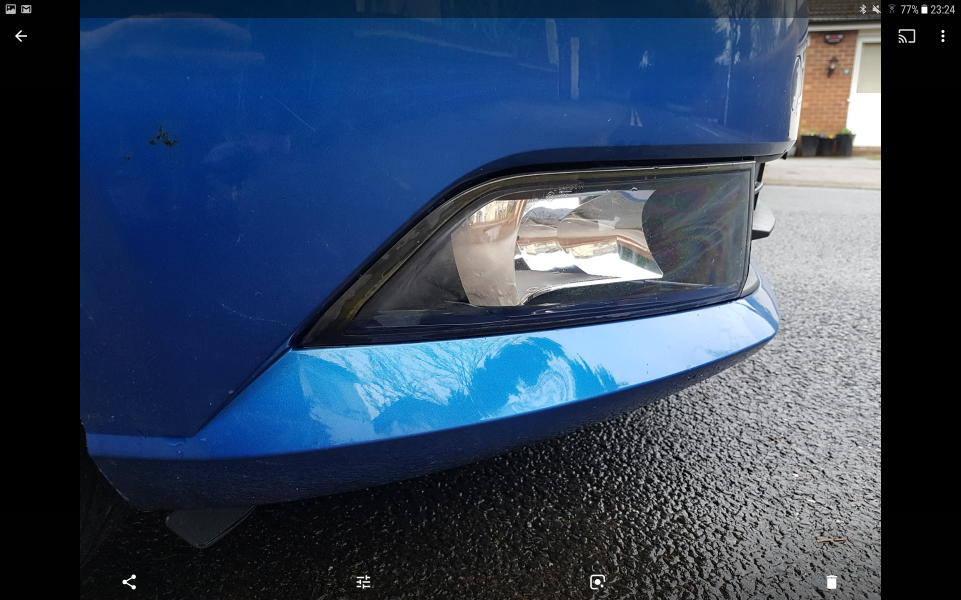

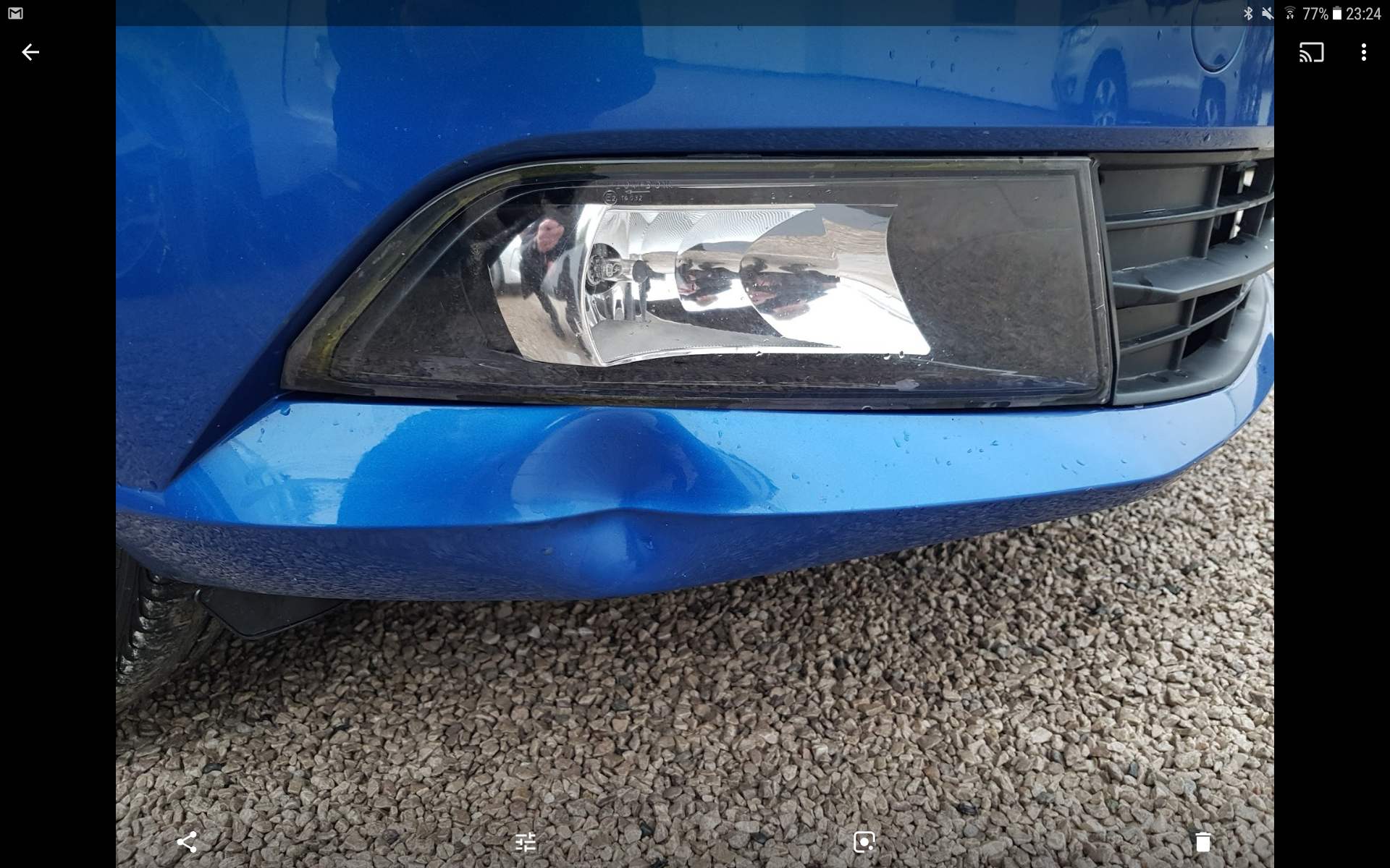

A lovely considerate person reversed ( presumably ) into my Yeti leaving a dent in the rear bumper. They didn't fancy having to explain it so buggered off without a word, bless 'em! Skoda wanted € 600 + to replace and fit a new one. Unfortunately, we're in the middle of moving house and fixing it just isn't in the budget right now.
Having seen all of these wondrous clips off of glowing white teethed people with buckets of hot water / heat guns and poking devices knocking dents out of bumpers, i think I might give it a go! I really don't fancy taking off the bumper entirely so am wondering can I access the dent in the pic below through the wheel arch or from underneath. I'll have to live with the tear in the bumper but the dent is driving me mad. At least if I could get rid of that, my tenuous grip on reality may be maintained for a little longer. Who knows, i may even get my teeth whitened and make a youtube vid!
Thanks for any advice/guidance...

Pour a couple kettles of hot water around the circumference of the dent. Push gently but firmly from the inside, again just inside the circumference, and it will pop the dent out. If you can get your hand inside use the handle of an hammer.
If you’re getting under the car put some eyewear on to avoid dirt dropping in your eyes.
And if a hammer will not fit you can try a wooden spoon.

Looks to me like that bumper is torn slightly, not just dented.
You could try pouring boiling water over it first of all without removing anything. I had a similar problem a few years ago with a Mondeo bumper that someone had dented and it came out just with boiling water. If it doesn't work you have lost nothing but if it does you will have saved hours of work.

Yes, definite tear but i'll have to live with that for the moment. Hoping it comes back together a bit when the dent pops out

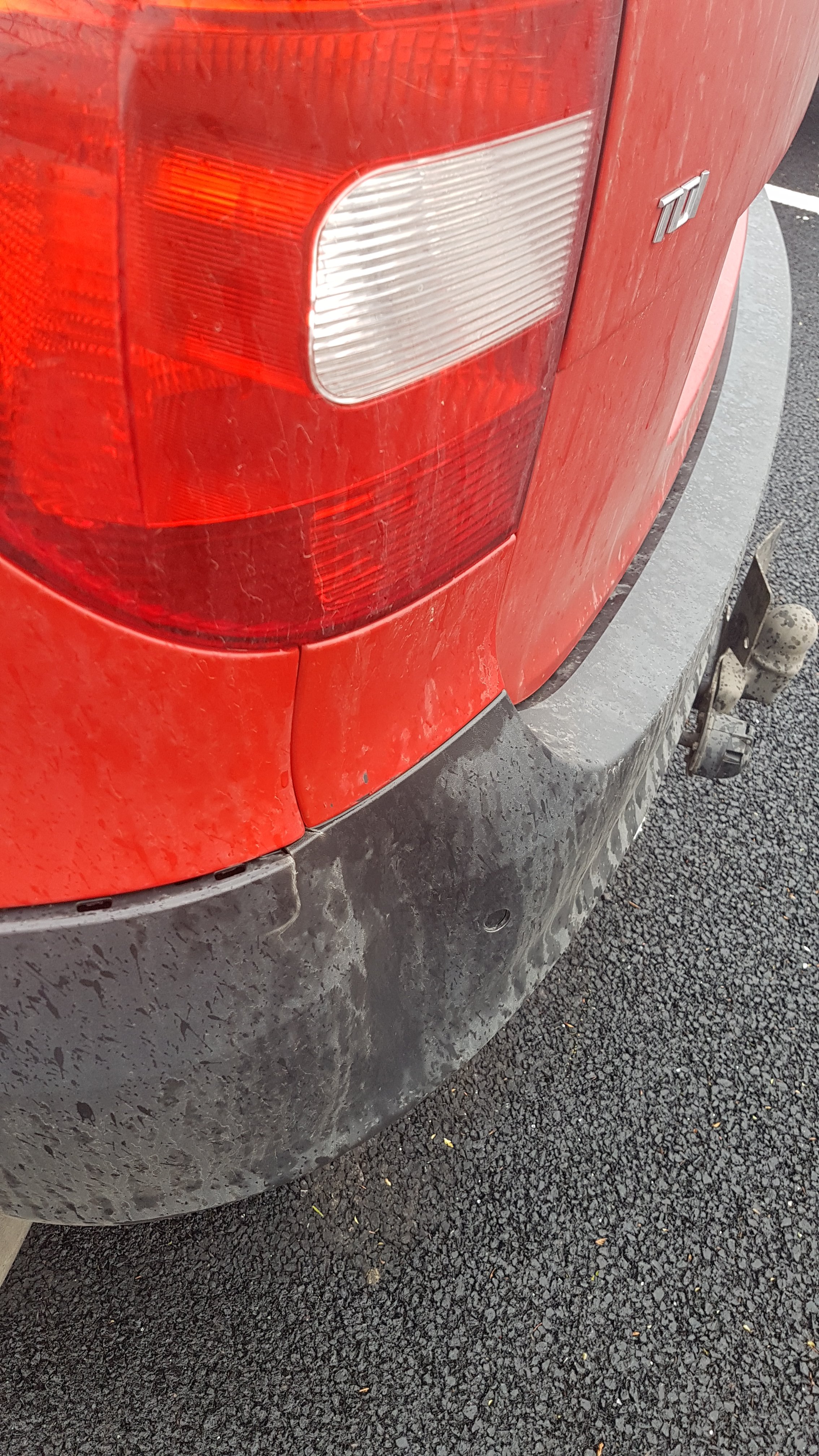

It was water from a kettle just off the boil.
I kept pushing and gripping the sides top and bottom until it popped out. The plastic became quite malleable as I kept carefully pouring the water over it.
I couldn't get at it from underneath.
There's only the slightest evidence it was ever there thankfully.
