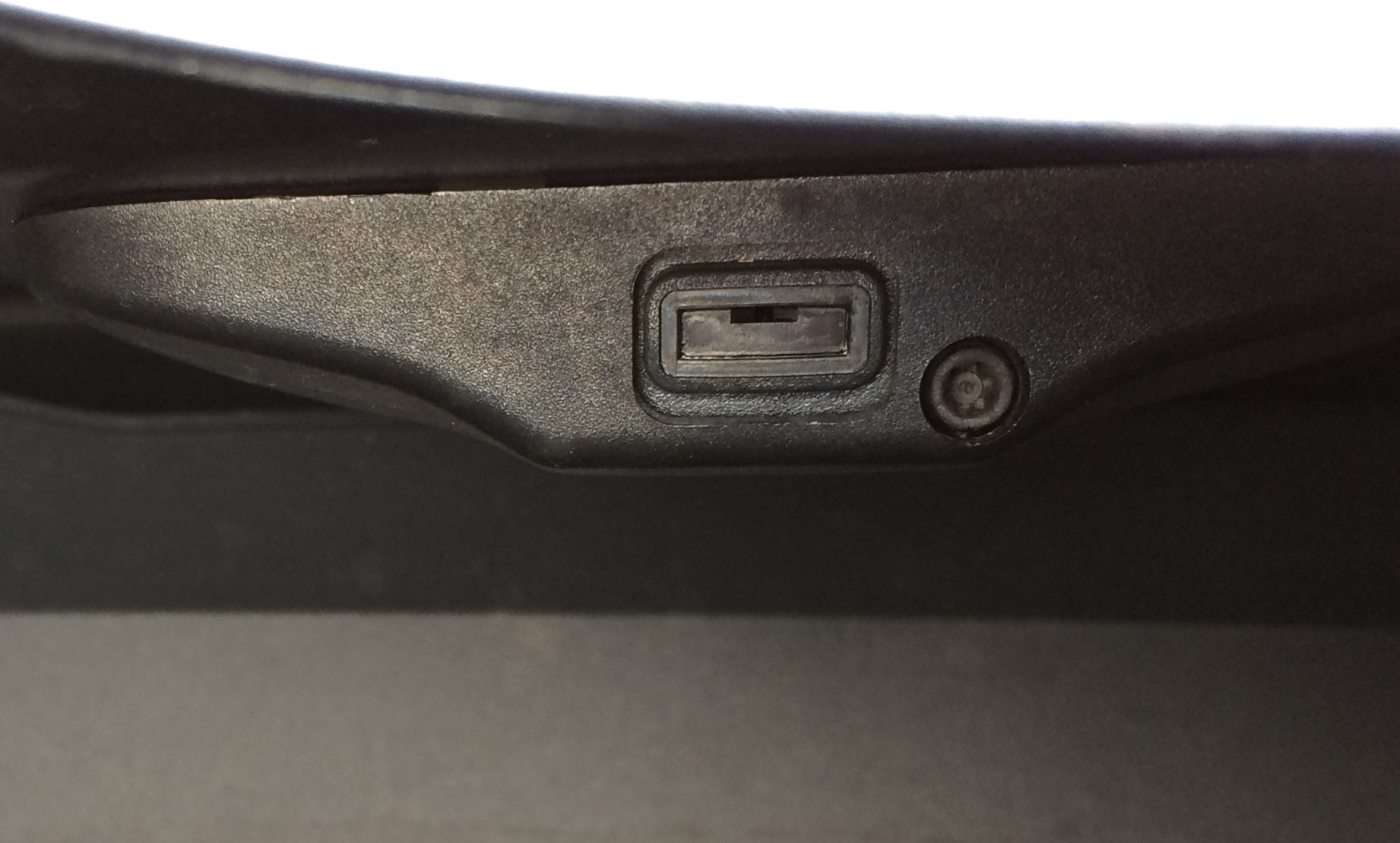

1. The infamous LH wiper blade not doing it’s job wiping the top few inches properly. “Just wipe the blade clean with screen wash fluid” said the man. Wouldn’t admit there’s anything wrong with the blade design. When we discussed the poor spread from the washer jets he told me that the small screw that can be seen by the jet is an adjusting screw, not a jet mounting screw.  Haven’t tried it yet.

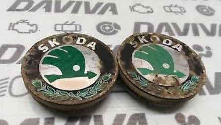

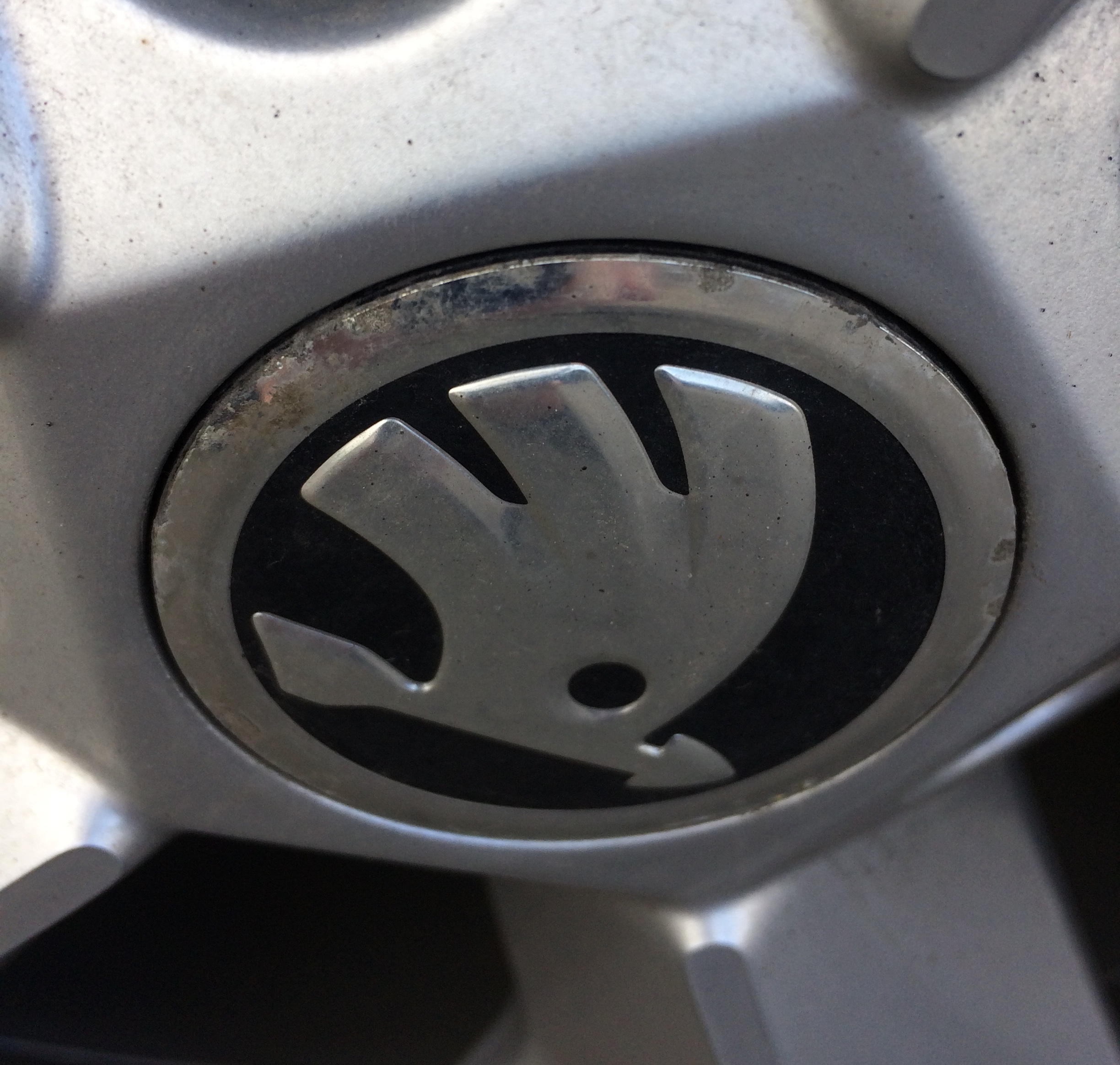

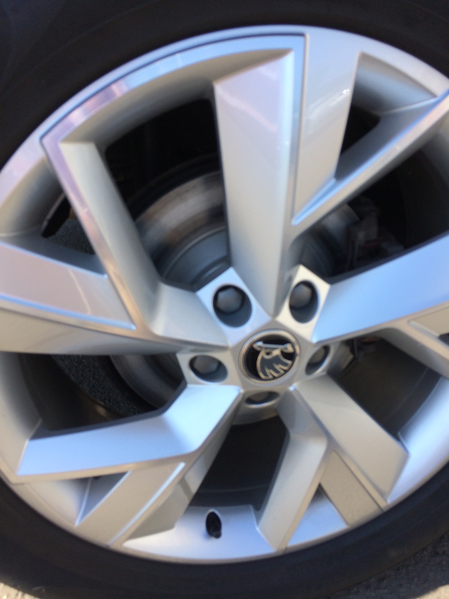

2. Wheel centre caps rotting away as usual. New set on order. Score 1.

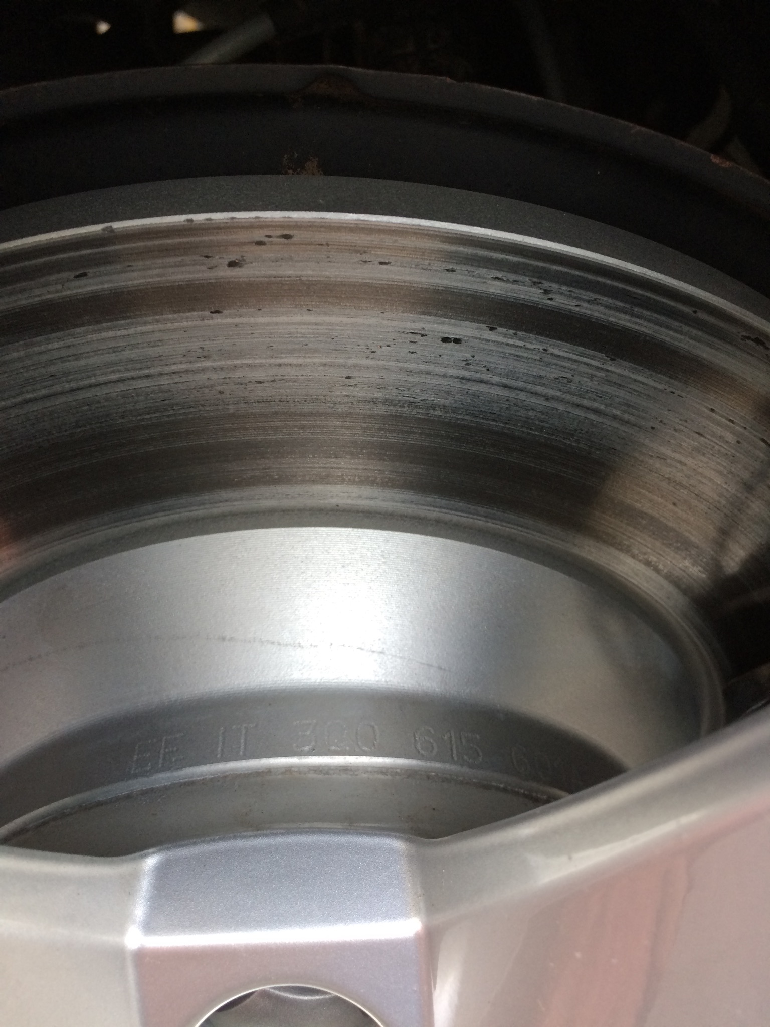

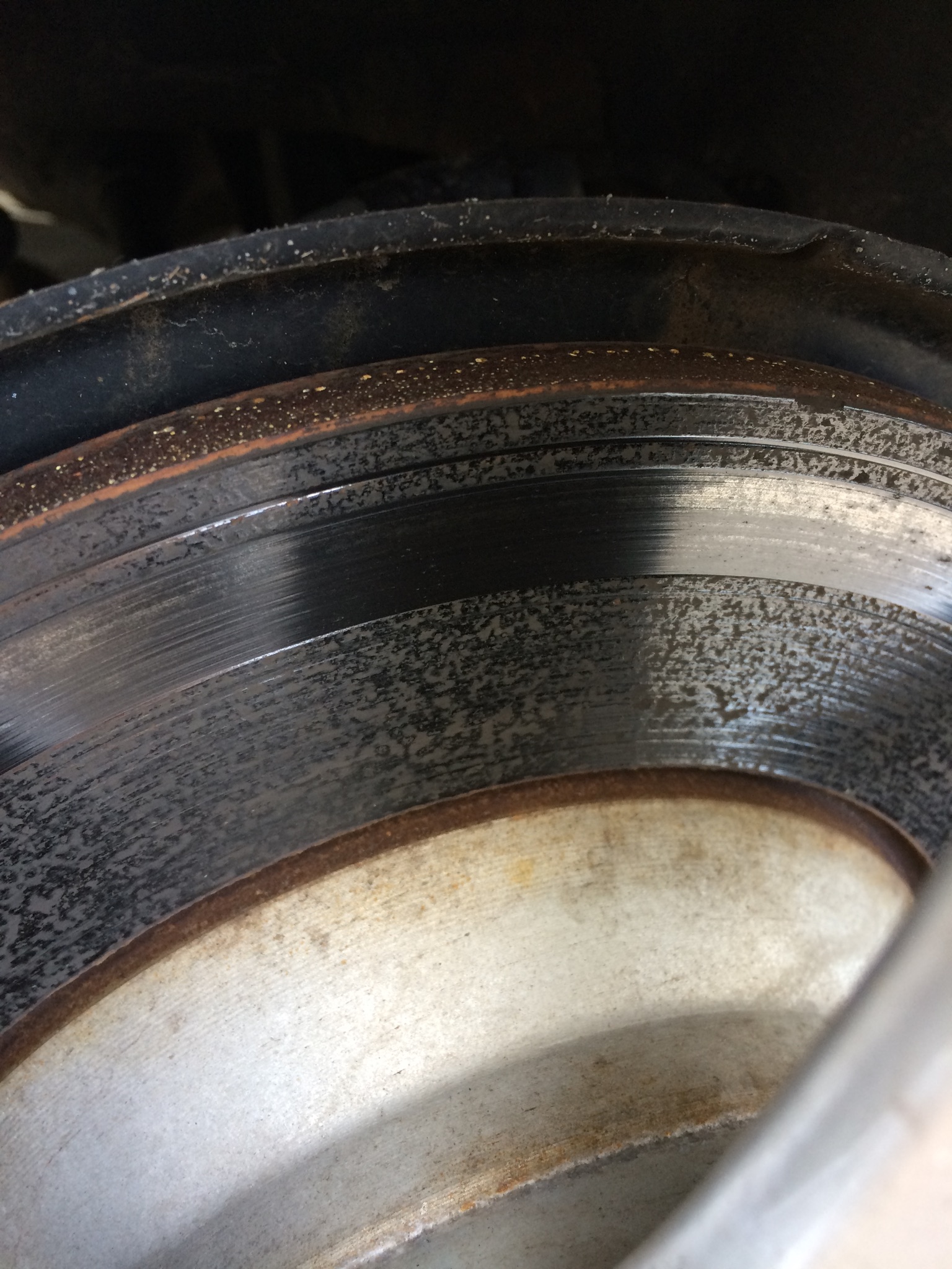

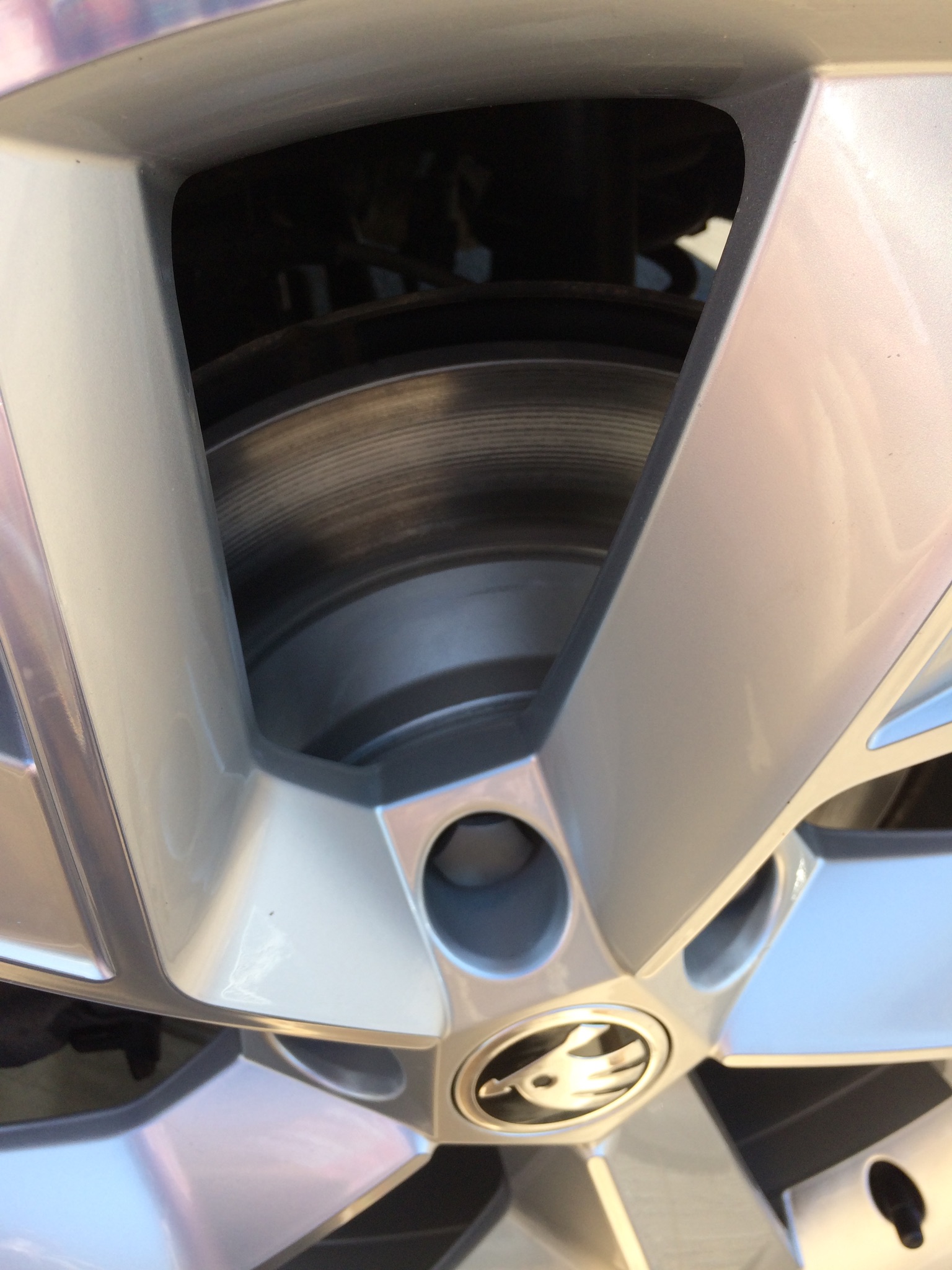

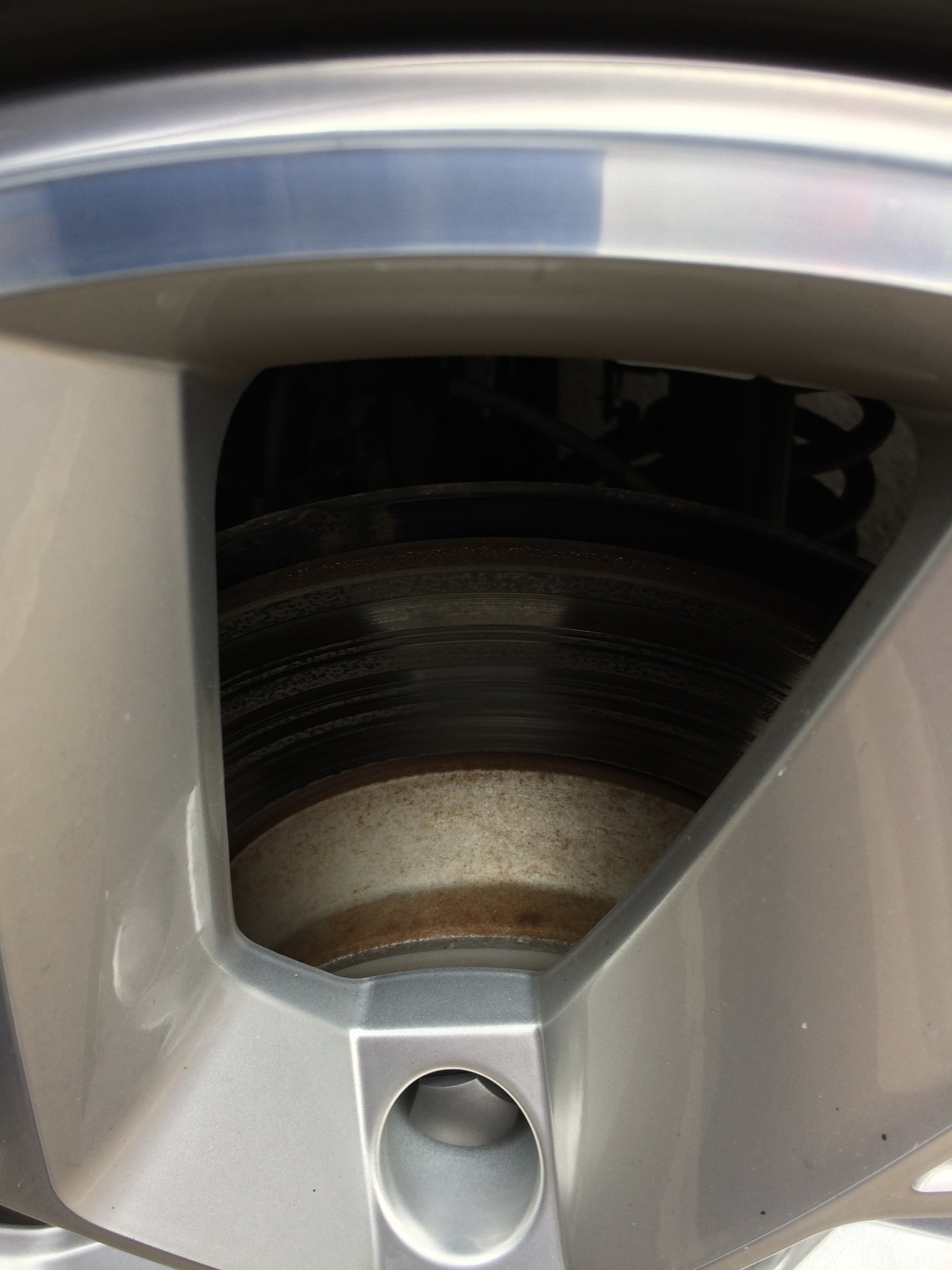

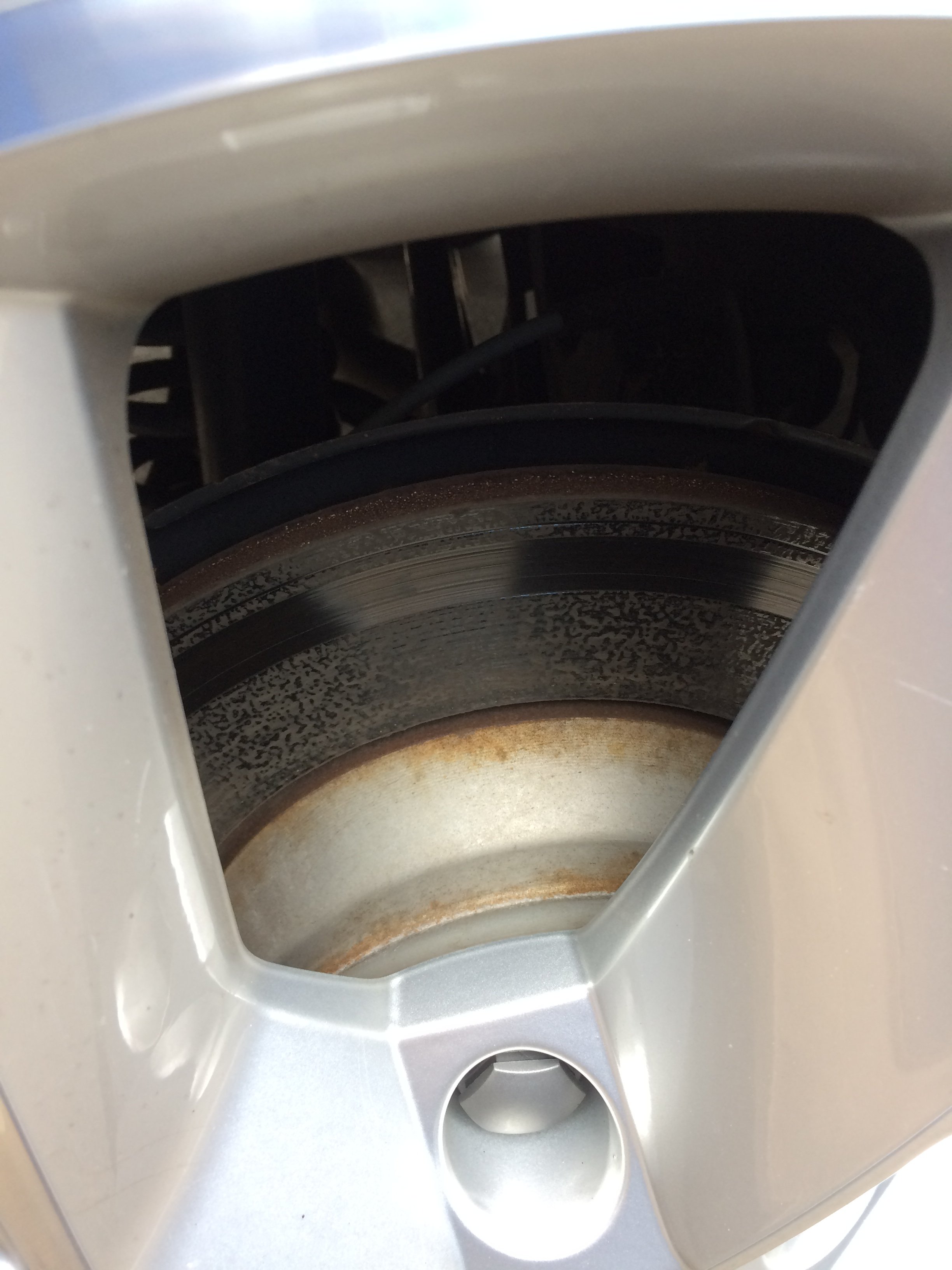

3. Rear brake discs / pads not operating properly across the full width of the disc area. I compared with 2 visiting Audis yesterday with lovely silver operating areas on their rear discs. It didn’t take much to get agreement that “they shouldn’t look like that”, though the man did try to convince me that rusty brake discs will be braking better than non-rusty discs.  I let that go rather than argue that Lewis and co. preferred smooth discs for their first 2018 outing in Melbourne. New discs on order. Score 2.

Ask the dealer if you can keep the new centre caps and put them on when the weather improves, unfortunately the new ones will soon follow suit. Poor design that Skoda have so far failed to remedy.
Can you claim for new centre caps a year after? Do they class that as wear and tear. Intrested to find out as my kodiaq is brand new and things like this didnt bother me as ive always brought Used. Ive too noticed that the left wiper is not as affective as the right - leaves streaks across the screen but im not sure what the dealer wouod say about that? Car is only 2 days old
Sounds like Boxer Boy has had some success, I'm sure it is down to each dealer, some are more customer focused than others.
Fair wear and tear for me covers tyres, non-LED bulbs, brakes, exhaust, scuffed alloys etc.
Corrosion on the wheels without evidence of a stone chips or external interference should be covered.
Skoda and their problematic alloy wheel centre caps go back many years, even well before the latest design...
Unfortunately their very removal and replacement can introduce corrosion to the alloy wheel itself as they are push fit, a very tight fit at that.
Interesting, on my last Skoda the centre caps did not corrode for 6 years. Will keep an eye on these. I can only hope the dealer would see these as unreasonable wear and tear and replace. To be fair the cost of the item is not the issue here. It is the time it takes to replace each one. They need knocking out from behind so you need to take each wheel off and then pop another in. The set is a tenner at most.
That brake disk wear is concerning uneven. The pad seems to have a high spot. That is new pads and rotors surely.

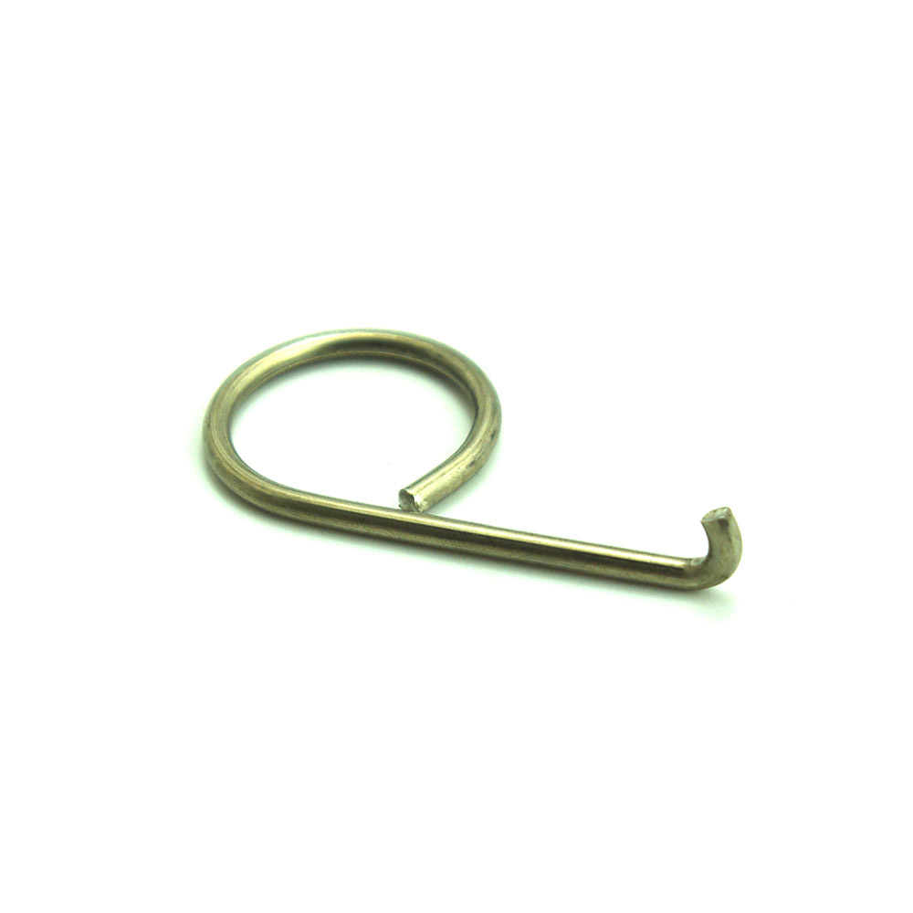

Most dealers don't bother removing the wheels, they use a self tapping screw straight through the plastic cap and pull it off by pulling on the screw with a pair of pliers!
Valid point on removal .. had not considered that .. thanks ..
Or 1 small hole and pull the cap out with the piece of bent wire included with the spare wheel kit.
I believe it’s intended for pulling the larger VAG centre caps that usually have a wee hole for doing so.
That’s what I was going to do if he had given me a set of caps there and then.
I've not seen any Skoda centre caps with the hole but it is definitely a VAG thing...

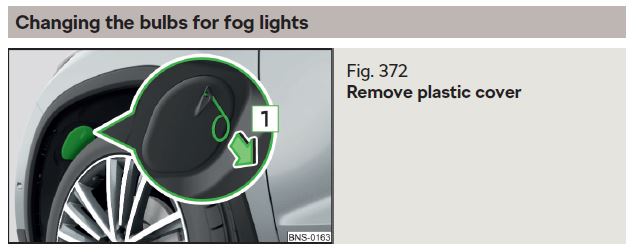

I believe this tool also serves as an aid for opening the foglight bulb replacement panel on the inner wheelarch liner on the Kodiaq.

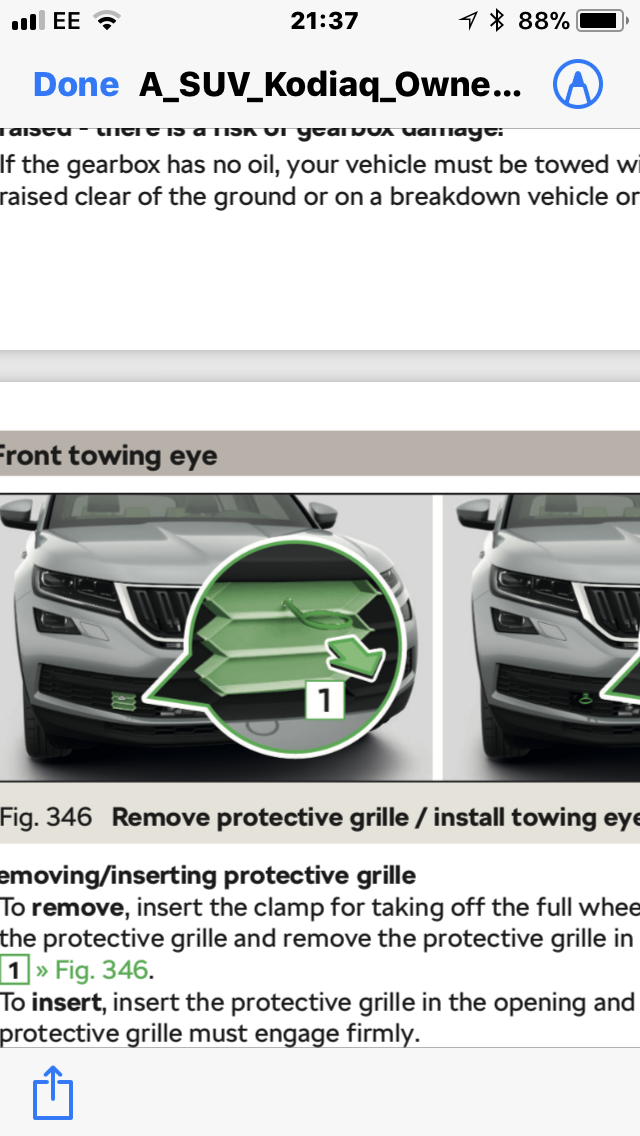

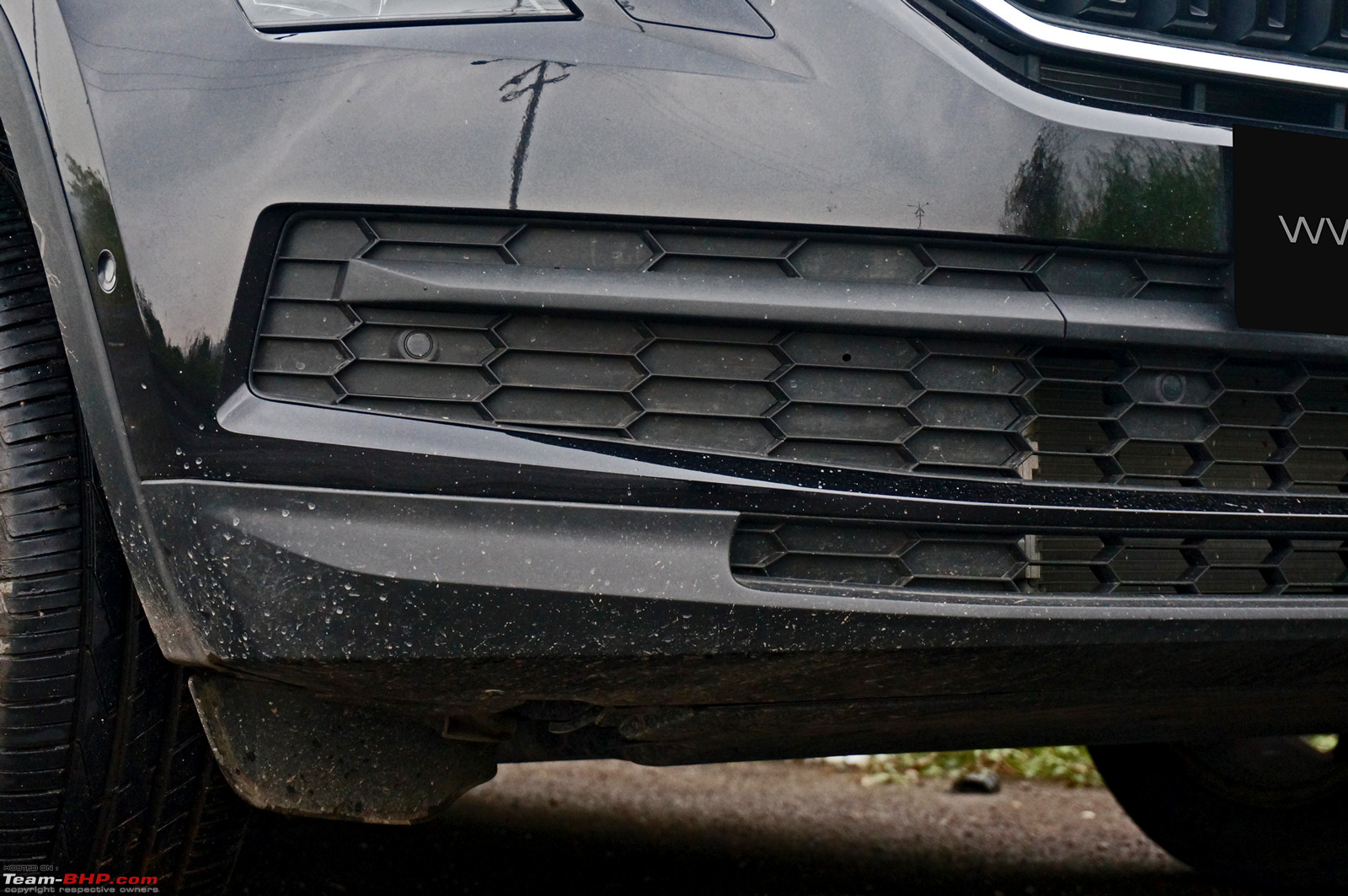

I belive he same tool is also used to remove a panel on the front  bumper to allow the towing eye to be fitted.
I think we now push in the bottom (or top) of the towing eye cap and it rocks out without needing a hook.
I was lead to belive that you insert the tool in the small hole between the two parking sensors to remove panel to reveal where towing eye fits.
Just confirmed from manual
"rusty brake discs will be braking better than non-rusty discs." - it specificly says IN THE MANUAL, that if your pads are rusty you will have a DECREASED BRAKE PERFORMANCE and that THERE IS A DANGER OF AN ACCIDENT -> just show the cars manual to that person and let him get out of that.
I can even see an edge in the groove the pads made, that disc needs to be replaced as a whole when they fix your brakes, not just the calipers and pads.
I have fiddled with the washer nozzles and it gets better.
Go fiddle and see if you can see an improvement.
I’m carrying the Torx key to give them a tweak occasionally.

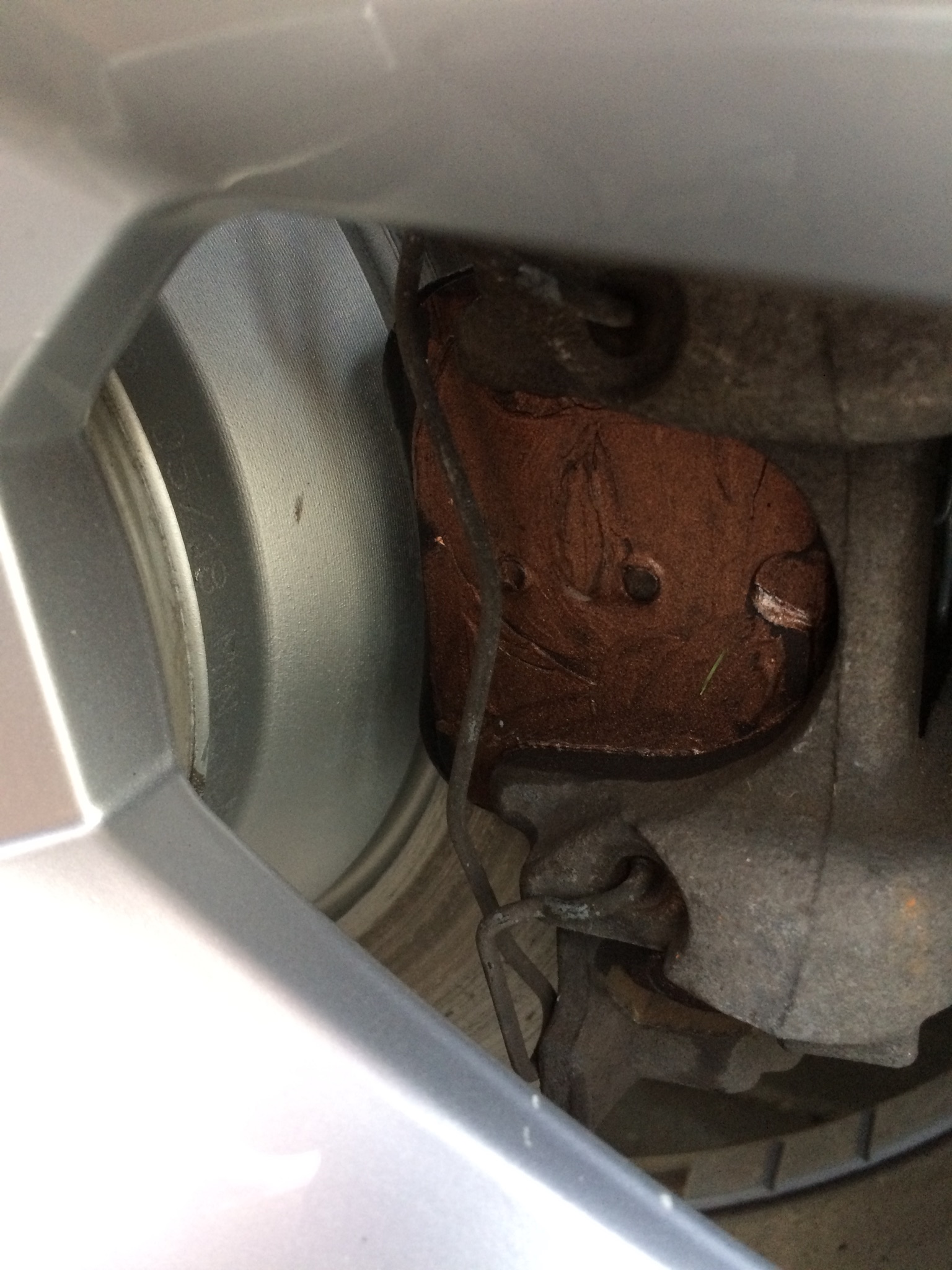

They’ve been a bit slap happy with the  coppaslip on the brake pad in the last picture, that will surely cause problems at a later date.
A sure way of stopping brake squeal!
Excess copper slip should only become an issue if the brakes get really hot, hot enough to melt the copper slip, no mean feat :D

Today my Bear received a second replacement set of rear brake discs and pads under warranty.
I think the paperwork showed an acronym "TIP" - I think that means Technical Information Paper - referencing incorrect brake pad material.
The first set lasted 13 months and 11,700 miles.
Second set lasted another 12,000 miles. Car is now exactly 27 month sold.
This set of brakes should see me through to April 2020 when it gets handed back.
The funny (haha) thing was that the first time I complained there was no question whatsover that something was wrong, but the second time I got some lip from the service guy who "wasn't sure if Skoda would replace under warranty".  Then things went quiet for several weeks and I was about to push them when the call came a few days ago to book the car in.
I still love the car but Cheese for brakes is just ridiculous.
Was it the same issue the second time - only partial cleaning of the discs...
Probably has incorrect balance between Front and Rear - with insufficent force to rear brake calipers?
At least on older cars - pre ABS - it would have been the balance valve or caliper that was issue..
The rear disks on my Kodiaq are in a terrible state, really badly corroded. Car has done 20,000 miles and is less than 2 years old, but the last time I looked on this forum I got the impression that Skoda would just say they're consumables and not covered under warranty. After reading this thread I might go try my dealer for replacement disks and pads.
Getting access to the TPI is important here, if this is out in the public domain it can be printed off and presented to the dealer for those with similar issues, making it much more difficult for the dealer to peddle the 'not under warranty' line.
