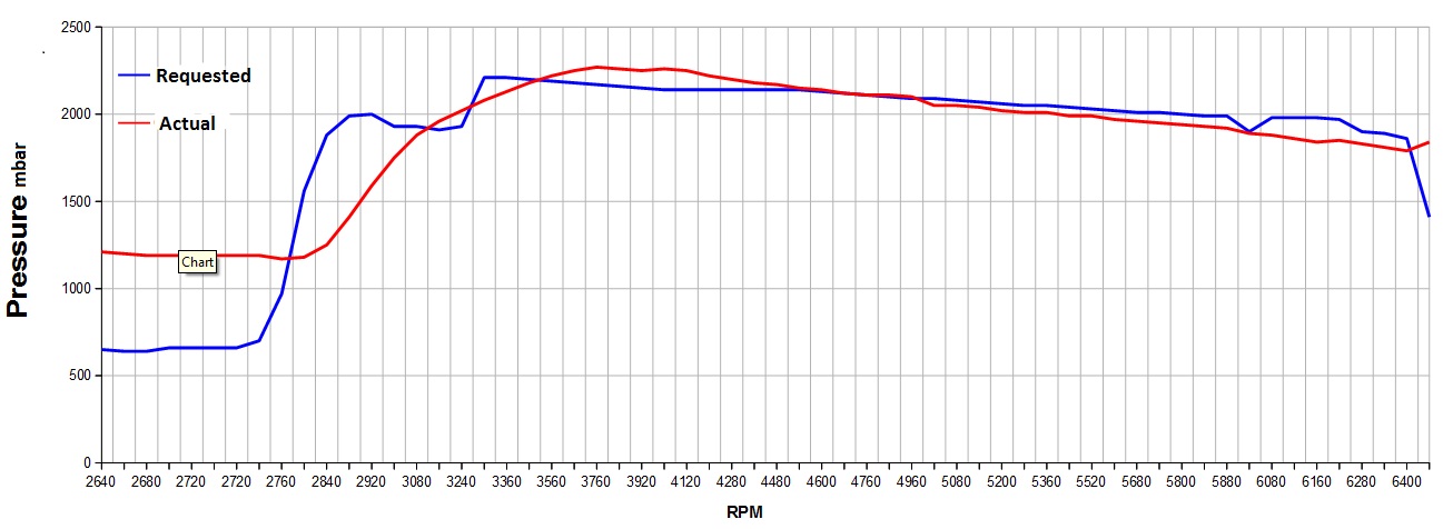

Here's a log of my Shark stage 1, it peaks at about 19.5 PSI, then progressively drops until it's producing around 11 PSI at the redline
Nice one. Thanks for posting that.I did some logging on torque app but I think I need to redo it in 3rd or 4th gear to get a more accurate reading and then plot it on a graph as you have . Are you pleased with the shark map? Looks quite smooth.  Also is a standard tfsi about 10 psi max?
Yeah the map's really smooth and very similar in its delivery to stock.
My boost plot was done in 3rd. 4th to the redline is too fast for my preferred 'test road'.
I believe standard boost pressure peaks at around 11 PSI. This'll vary from car to car especially as even the newest TFSI's are 9 years old now!
