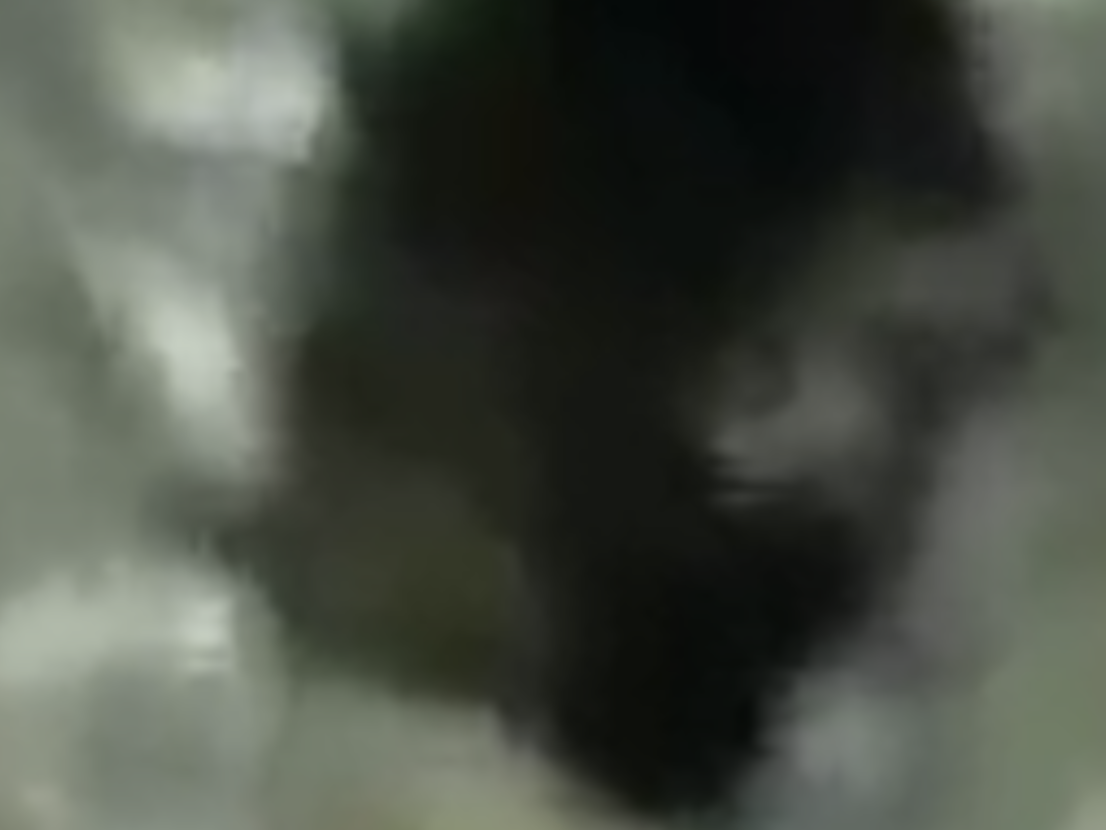

05E3CC15-EA05-46A7-A3B3-F97E329A1C35.thumb.png.cd21257018cce41f7fc0941f5146f5f8.pngI think I can see the problem ,there’s a gremlin in there

Looks internal failure to me. The propshaft coupling wear would be exacerbated by the catastrophic failure of the differential.
