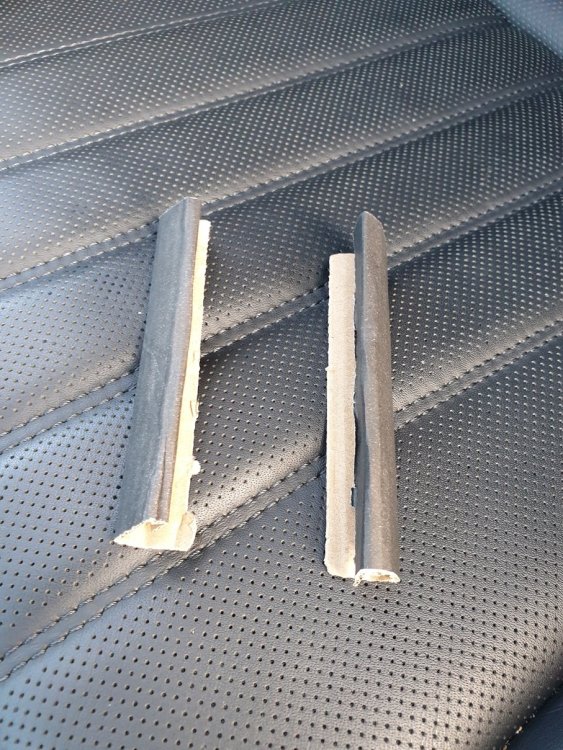

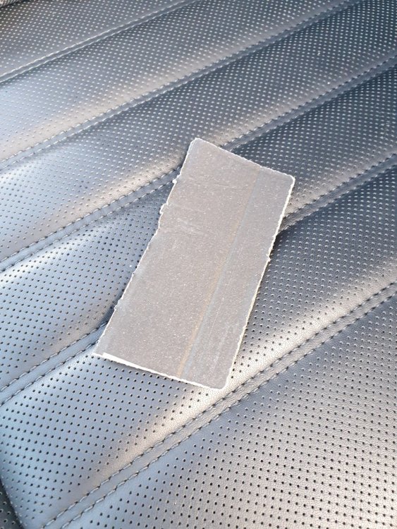

So I opted against the lube option in the end. I conducted a series of tests over the weekend and found that almost all the groans are eliminated with popping out all the clipped sections around the entire sunroof. However as mentioned before this rattle on the motorway was observed depending on road surface. I was a little hesitant with the lube option given the poor access the the clips, and chances I would made a mess, and the job need revisiting from time to time. So in the end I decided to wedge the clips ever so slightly away from the surface they were rattling against. I used some thin cardboard folded a few times to give a snug fit, and then wedged these into the gap. Its enough width to ensure the clips make no contact, but  no enough that I would be worried about deformation in the lining. From the drivers / passengers seats they are unable to be seen.
Another run down the motorway and the rattle is eliminated, as is the final remaining groans in the roof / A frame. Surprisingly, a 100% fix thanks to a few pieces of card!

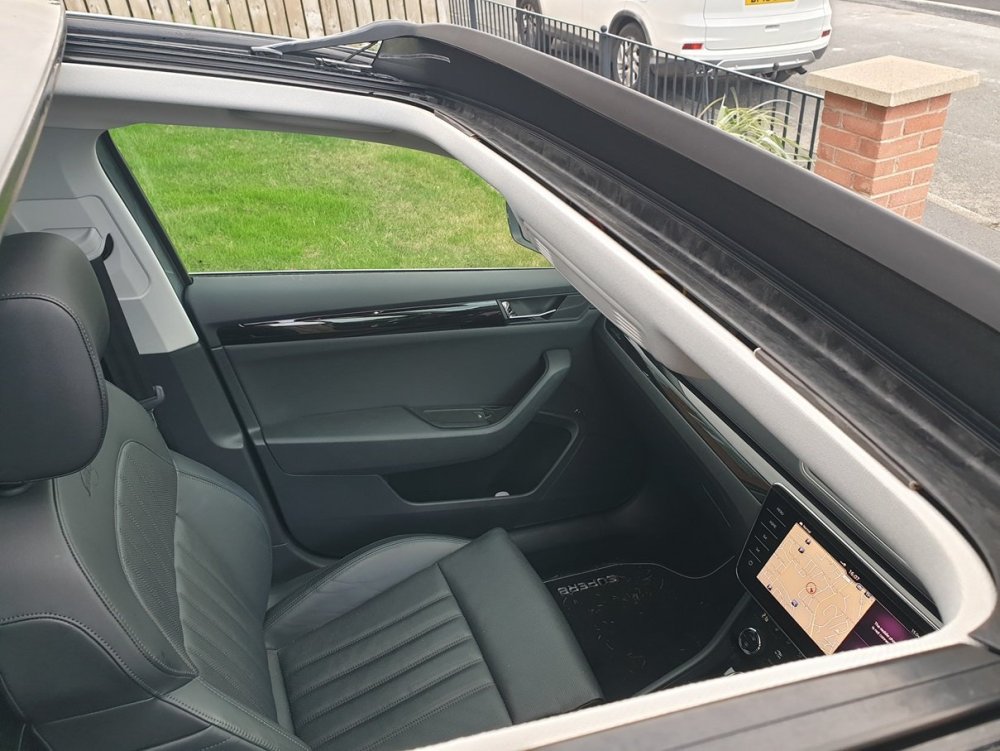

I drive a 2021 superb sportline, and just this evening found another source of noise from the sunroof. The rear edge of the glass has some flex in the centre, causing the rubber seal to rub where it meets the painted roof. The noise would come and go so it was hard to find, but this unusual spell of dry weather here in Ireland gave a good chance to find it properly.
I cleaned all the rubber seals and gave everything a good coat of gummi pflege and the noise is gone. Hopefully it stays away but if not, the next step would be some sort of light grease.
I do have some small noise from the headliner as mentioned here above; I'll get to them in time too.
Video attached, and photo in case video doesn't work.
