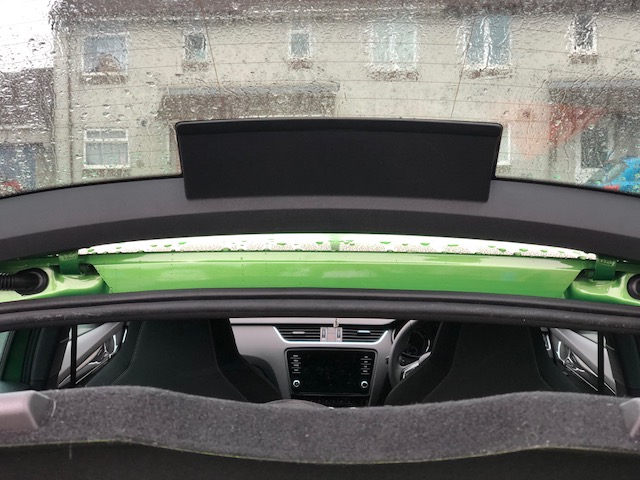

Hello, sorry if this has been asked before, mind you I dunno why anyone else would ask this! But I'm wondering what's behind this plastic panel below the centre brake light in the hatch? Also, would it be safe to drill a 1cm hole here?
Any info would be much appreciated :)
Is that not just the brake light? Maybe some electro gismagic to make it all work. Does it have a rear screen squirt?
Yeah the brake light is there and it does have a rear squirt and all the wires to go with everything, just concerned there might be something else there that I wouldn't want to come into contact with when drilling :D
I'm sure it will be okay to just drill it as long as I'm careful but was just in case anyone had some horror stories for me :D
Edited by siobhanemerald
That trim should come off, perhaps try removing it and drilling with it removed. Would be safer :)
Will have a look at perhaps doing that then! When I had a look last night it looked more or less connected the whole way round the hatch but will do another inspection :)
How bad can it be getting electrocuted anyway? :D

You may find you have a seal around the surround to prevent the brake light fogging up. If you drill the surround then you would compromise the seal.
What at is the purpose of the 1cm hole?
Interesting - will need to investigate this.
Installing my dash cams over the weekend and don't want any 10cm of cable hanging around at the hatch. Had an auto electrican (family friend) fit them to my last car (Fiesta) and he drilled a hole in the hatch and sealed it with a small circular rubber seal enough for the wire to pop through so I'm planning on doing the same. Was a lot easier on the Fiesta though as it was metal and there was no seal or wires in the area being drilled.
Now wondering how much of a task it would be to indeed just remove this trim to suss out what's behind there as I certainly don't want to damage anything :worried:
If you do drill the surround then do it in a dry day and will around the hole with silicon to restore the seal. If you don't want to drill you can secure the cable around the surround using small dabs of silicone or better still Sugru mouldable glue . When you come to sell the car you won't have any holes in the interior and the silcone or Sugru can be easily removed without leaving any marks.
I drilled a hole through that panel to fit a bracket to secure a rear window blind.
You'll be fine as long as when your through you stop immediately.
Removing the trim might be a better option though as it'll allow you to better route the cable without it snagging.

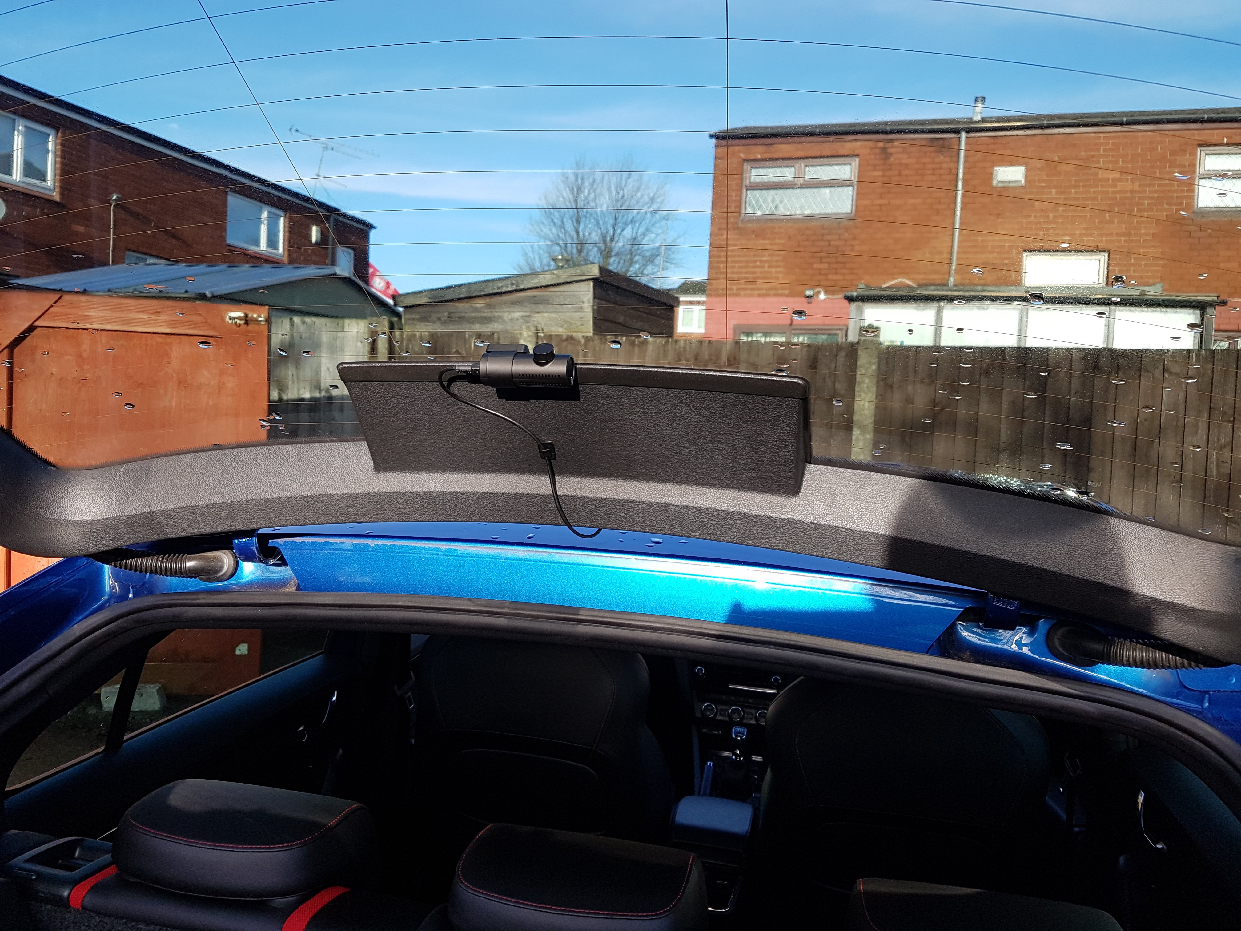

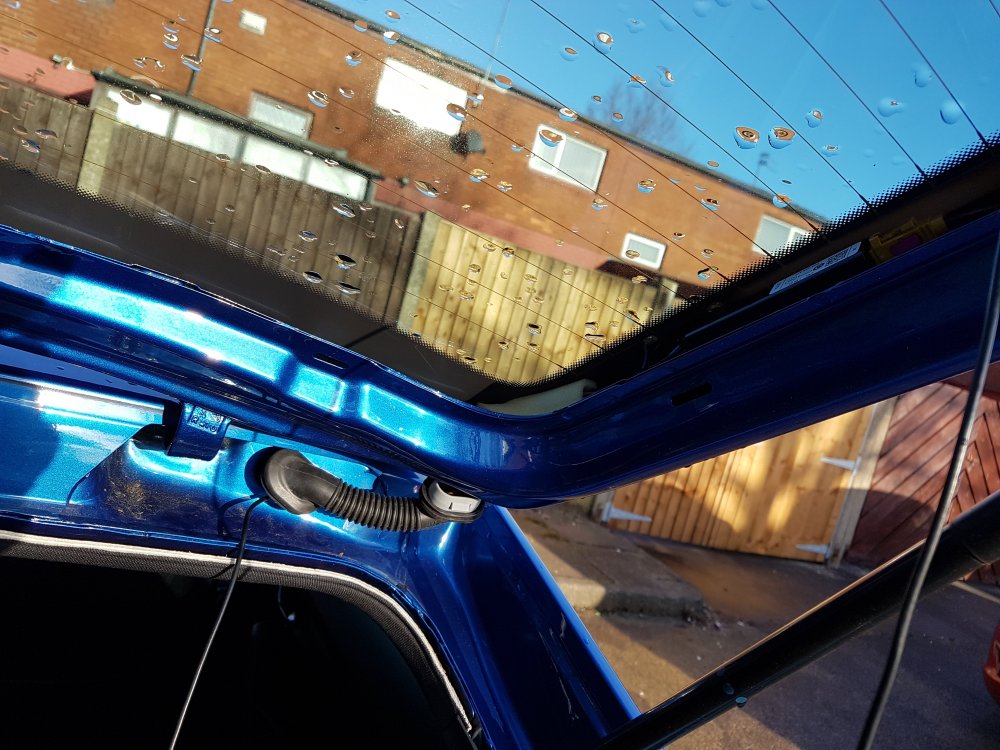

I took the boot seal off near the top and fed my wire into the hatch via the rubber cable duct. Then up into the drivers side of the hatch and out of the hole for the heated screen wire then back down to the top of the high level brake light. The only trims i removed were the hatch carpet trim and the black plastic trim that also covers high level brake light, i dont think you need to remove the carpet part though
@Mike97 did you have to drill a hole??
What you have done is exactly what I've had in mind! Through the rubber cable duct and through the black plastic but did you just jam the cable under the plastic instead of drilling a hole then and then run the cable over the top of the plastic?
How easy to remove was that long black piece of trim that goes all the way round the hatch at the top?
The black trim is a tight fit on the clips but pulls off I used the plastic trim tool that came with the dash cam to start it off then got fingers behind it. I tucked the wire along the inside of the rooflining with the boot seal pulled off at top then pulled the rubber duct off. Used a bit of stiff wire taped to dash cam wire to first feed it through duct then up the drivers side of the boot with the heated screen wire. The reason I used drivers side is the wire hole was not as far up the boot as the passenger side there was no holes I could use in the top of the boot so wire fed back round to brake light. For the trim I just used a round file to notch it out so the cable fits into the notch as the panel is clipped back on. And dab reception has been fine no problems.

Went ahead and fitted my blackvue cameras today (2 channel) - managed to get the power magic pro hooked up quite easily using a couple of piggy back fuses. Was surprised how easy it was to get everything set up and running through the car to the rear camera as well! Only problems were that bloody glovebox going back in (surprisingly fiddly for me haha) and there was originally no power getting to the rear camera but reset the system and now everything is running perfectly!
Did as you suggested @Mike97 and pulled that black trim off and etched a notch in the plastic (much better than drilling a hole larger than needed!) - was tough to get it off as mentioned but got there in the end :biggrin:
