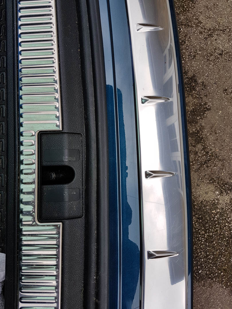

I fitted mine (Purchased from TPS, no instructions supplied, just in a bag) using just the supplied tape.  As seen in the image, its fairly lousy around the edges and the corners lift slightly - There's curvature on the outside edge of the bumper that probably doesnt help.  The edges are also razor sharp.  Having not seen the instructions, I presume the tape is there just to hold it while the general adhesive sets and provides a total seal?   As it is, its just going to let water pool underneath?   Overall its decorative but fairly useless in totally protecting the lip.  There's 12mm exposed on the outer edge and from the rubber to the strip there's a 30mm (at the ends) to 36mm gap (centre).  I think having a brushed finish would have been more suitable in not highlighting every minor scratch, after all, that's what its there to take...
