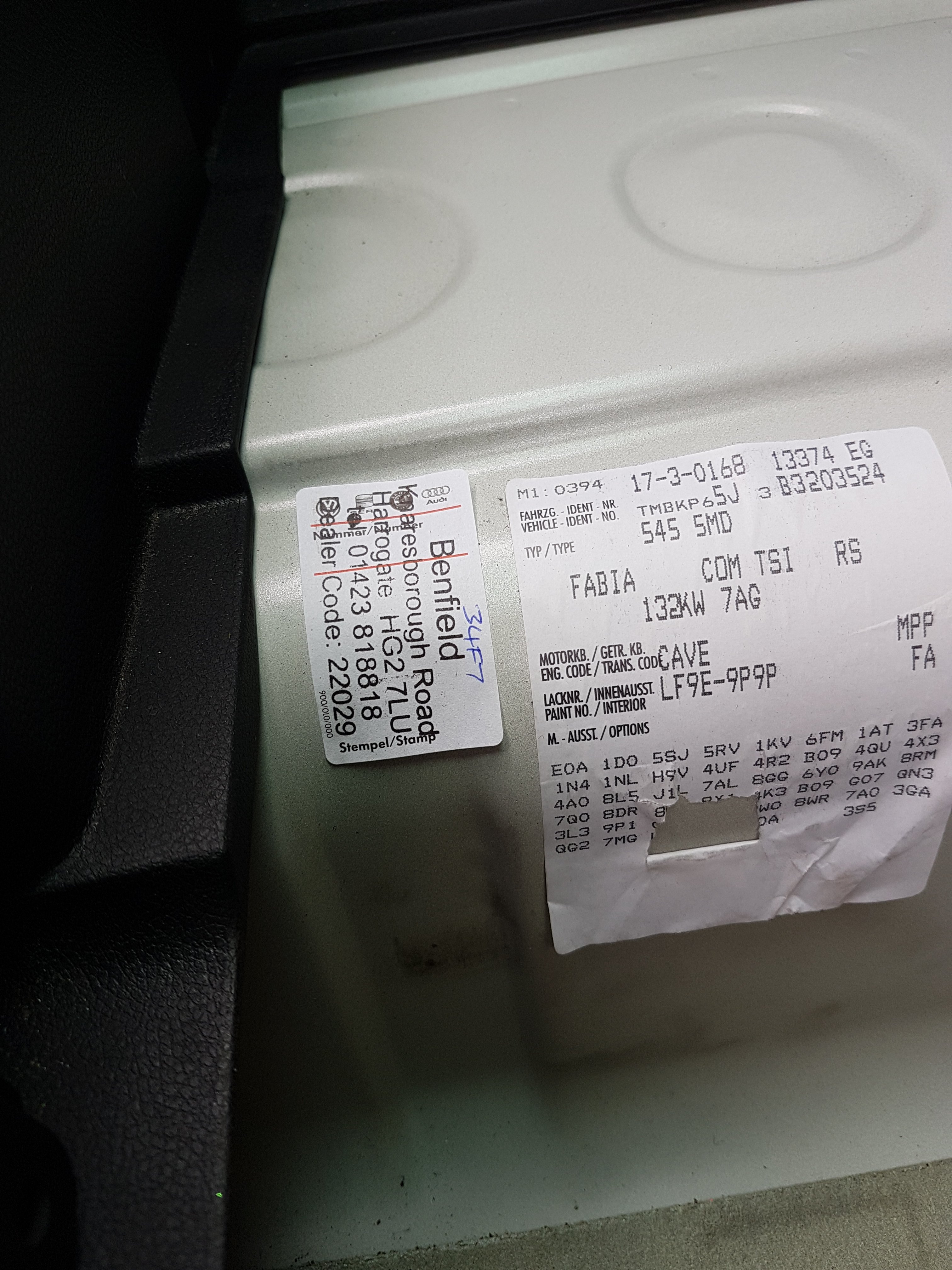

these are the stickers in the boot.  anyone shed any light on them?
That is the DSG service campaign carried out, so it now has Synthetic Oil in the DSG and had a dsg software update.
There was a sticker that should have been used, but that is OK as shows done.
All fine with the car?

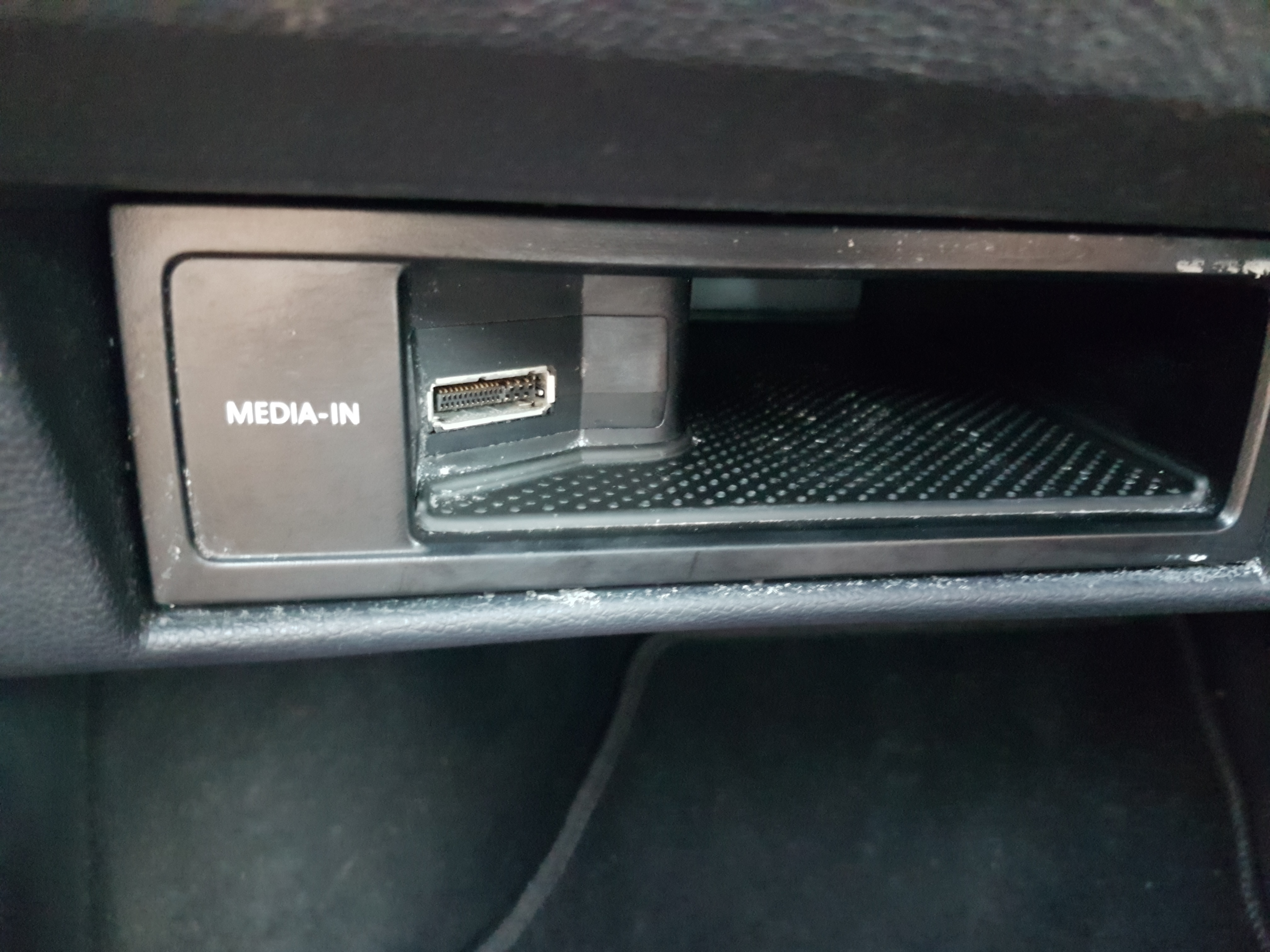

also whats this lol?
As Offski has said the smaller sticker indicates that the DSG campaign has been carried out on your car,so that's one potential query resolved.
The larger sticker is present in all our cars and matches the sticker inside the service schedule booklet, it denotes the information relating to your specific vehicle eg yours is clearly a CAVE engine with the paint code(s) immediately below.

See, Bottom left of your Build Sticker in the boot.
Is that QG2
Possibly VW504 00 has been used for the past 7 years, but now VW502 00 might be worth using. Up to you.
