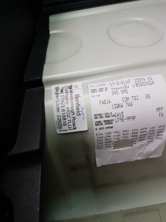

See if the Service Campaign '34F7' was done on the DSG.
