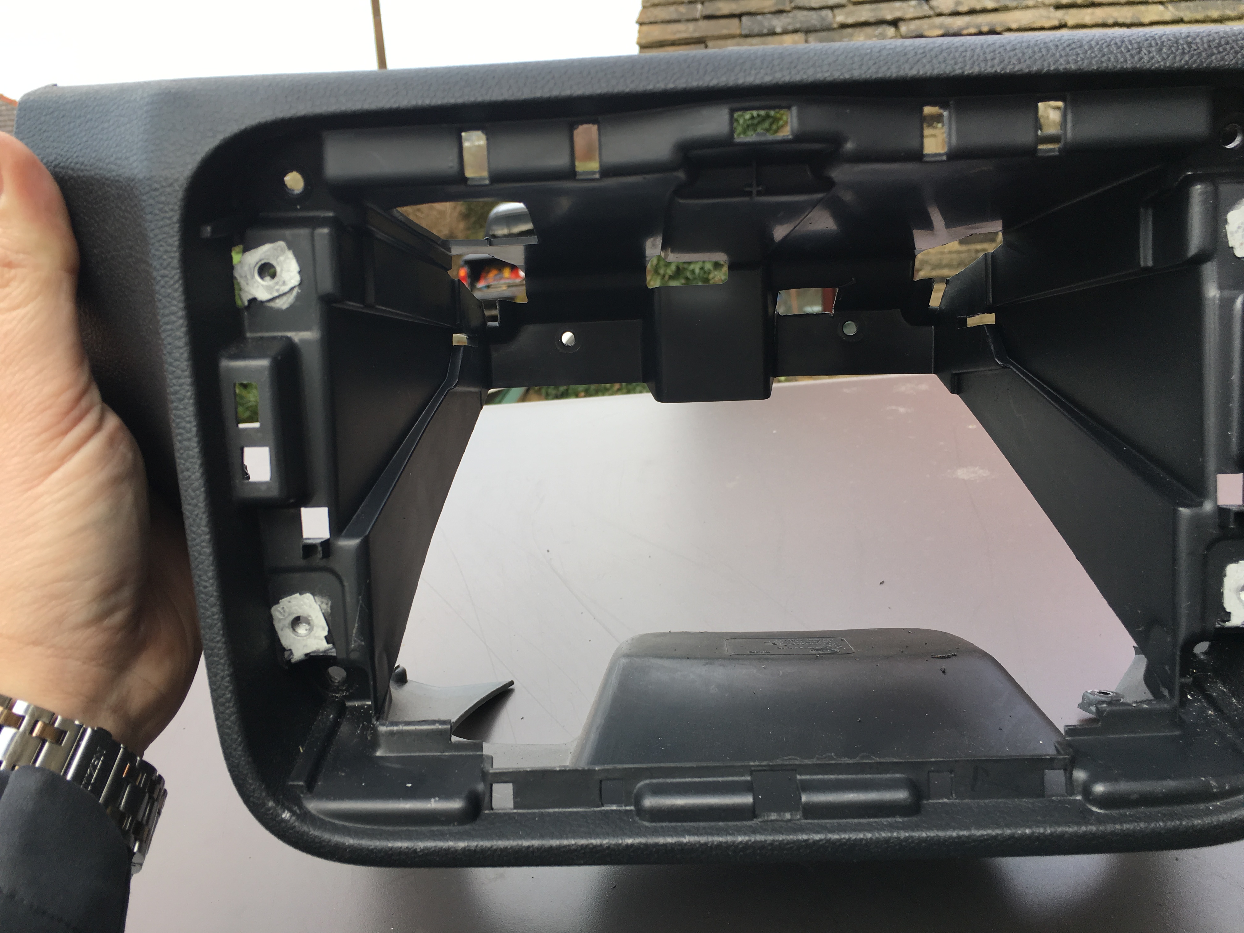

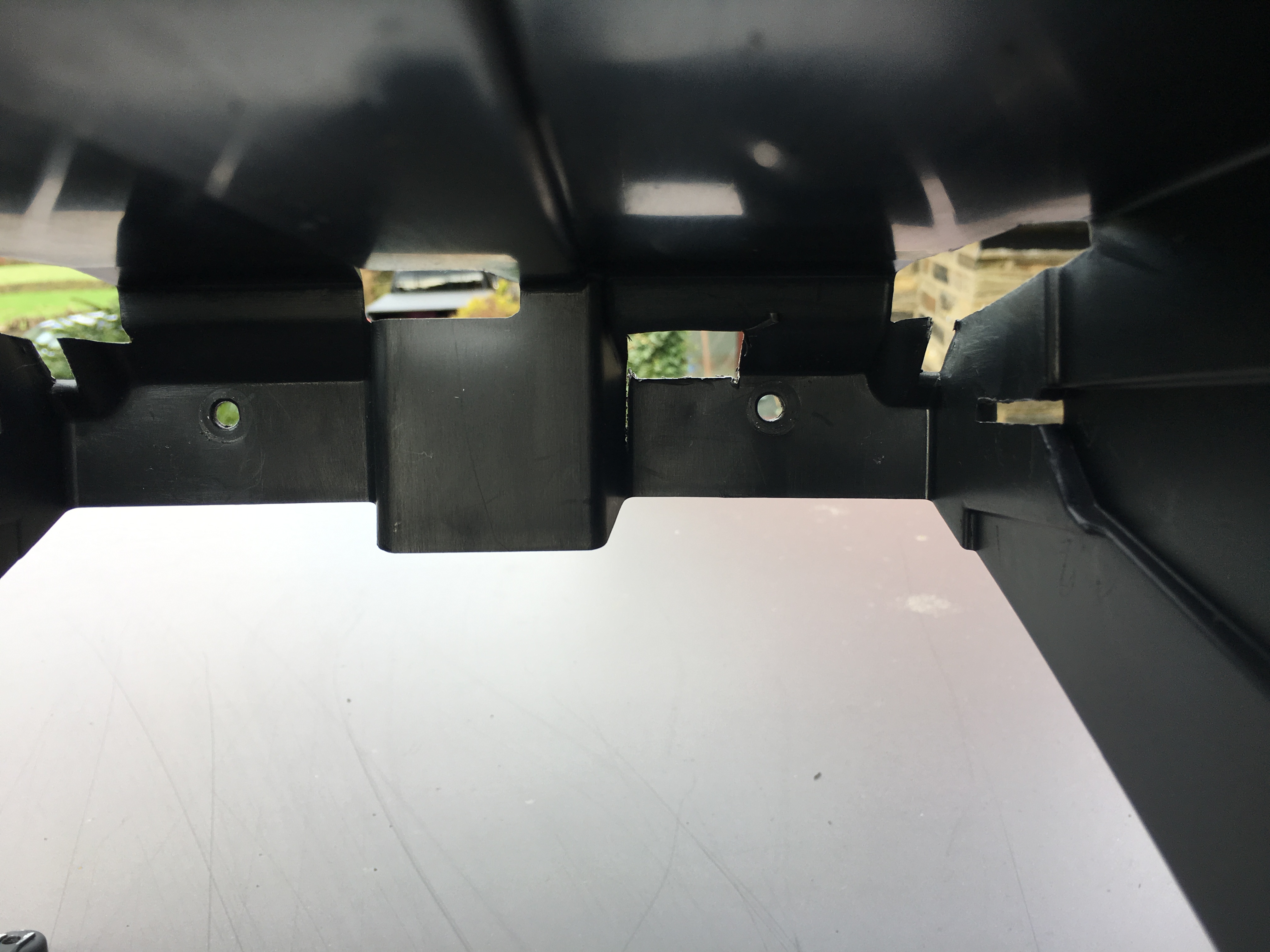

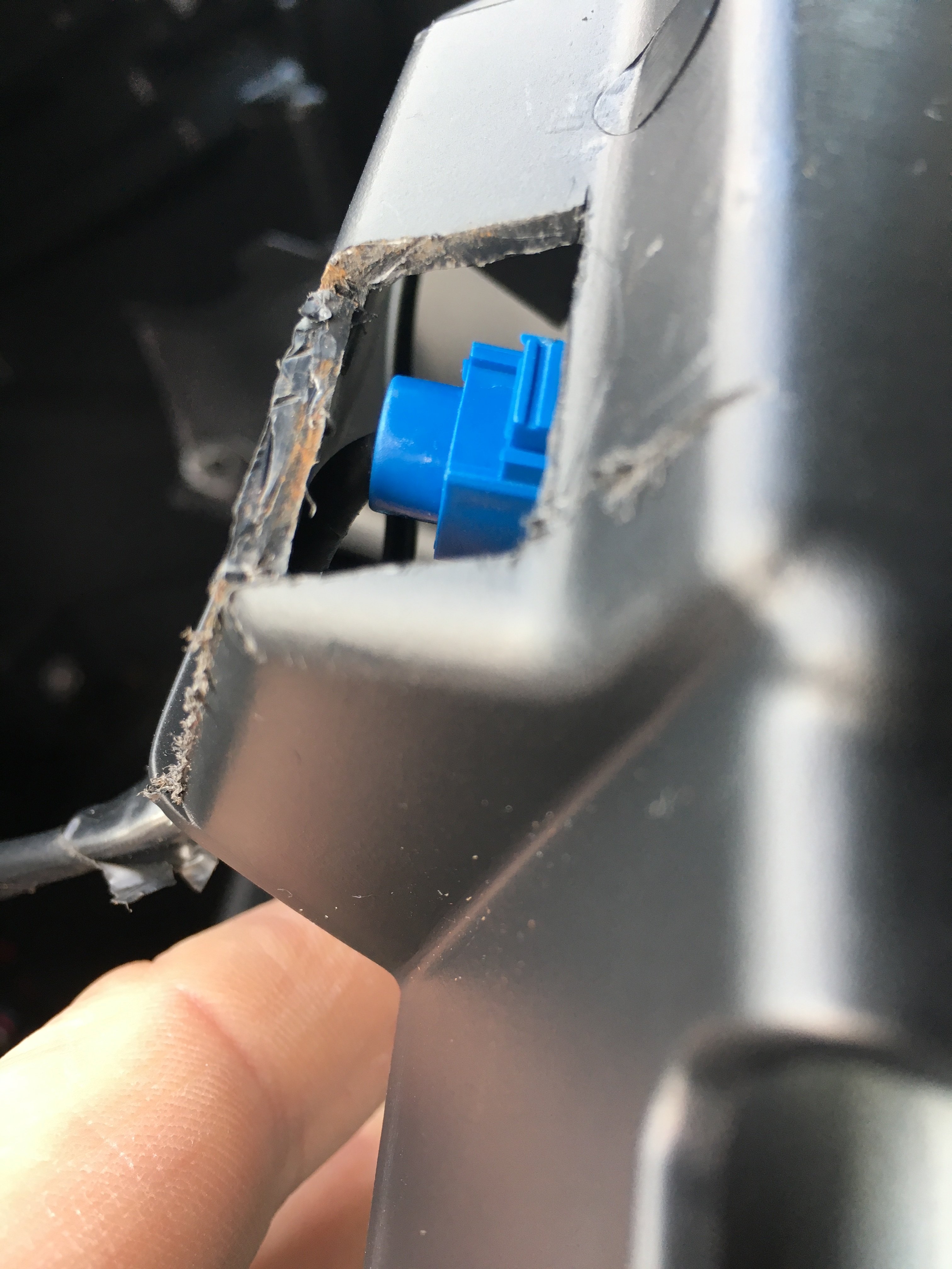

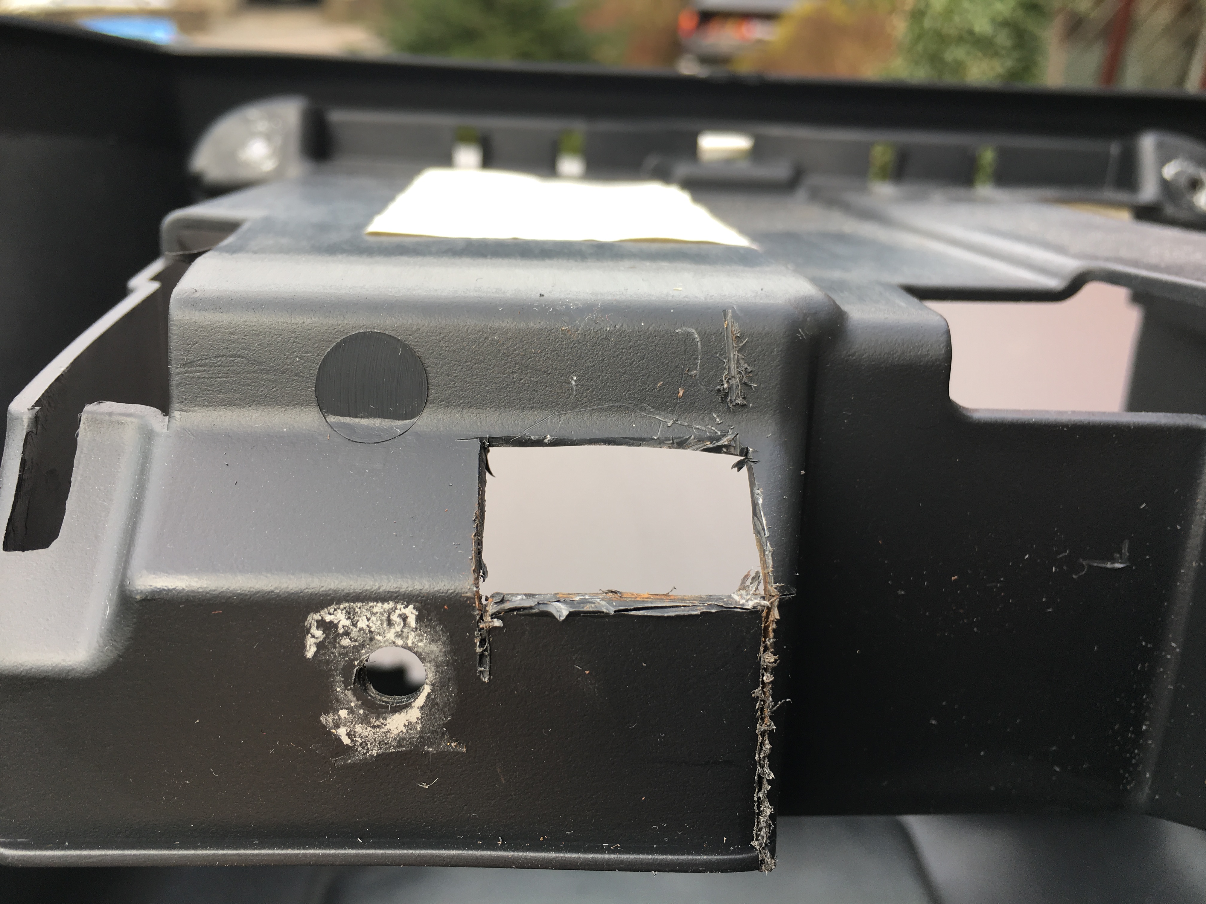

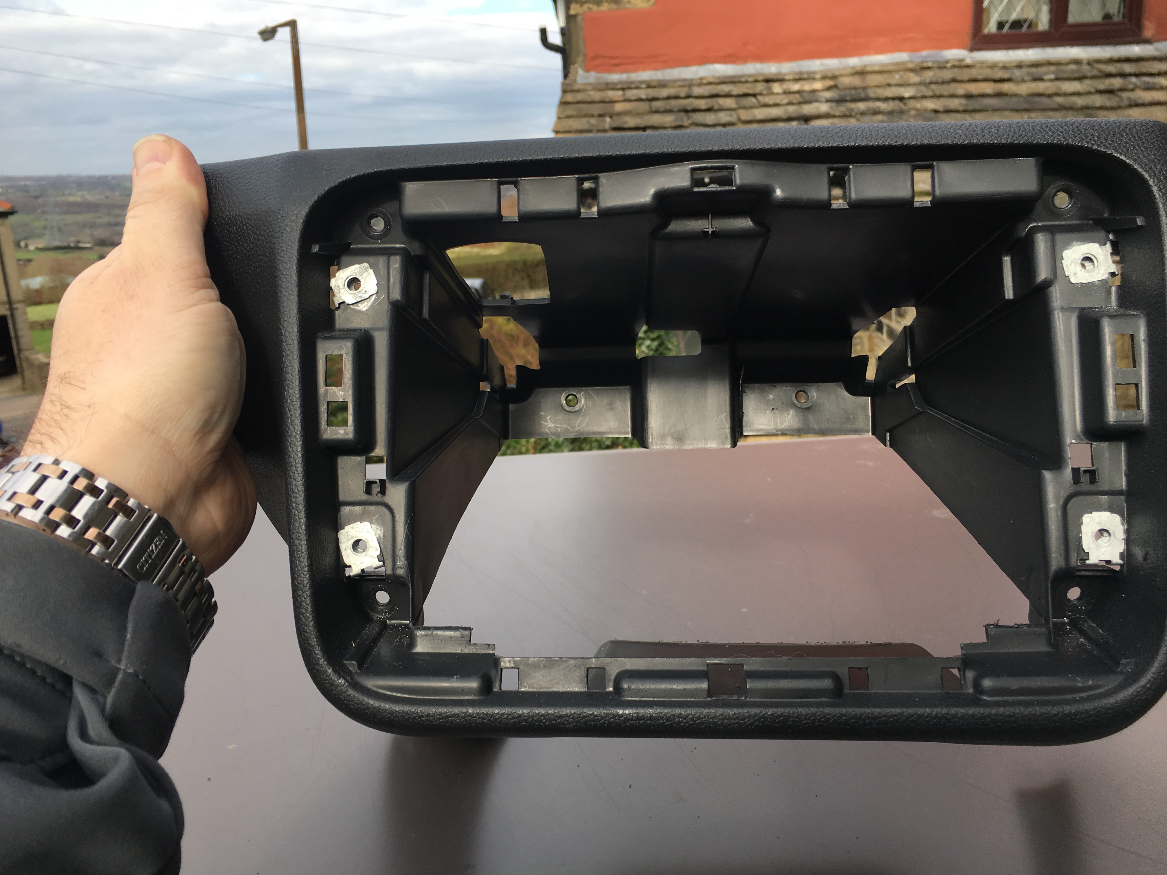

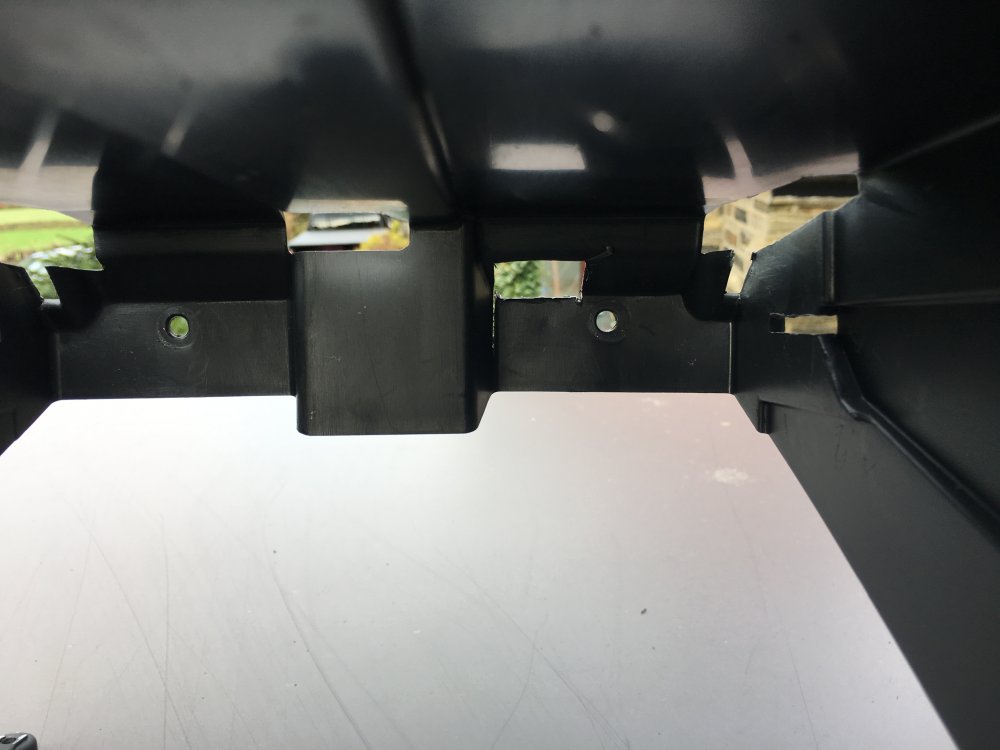

Been almost a year but I have finally removed the Columbus head unit and the plastic surround and made a modification to allow the dab lead more space. Hope it works. It only took me about half an hour total and I’m posting some photos to assist anyone wishing to do the same. Only 8 screws to remove the plastic surround and could see where the dab aerial had been rubbing.
Thats really good to know. Thanks for that.
