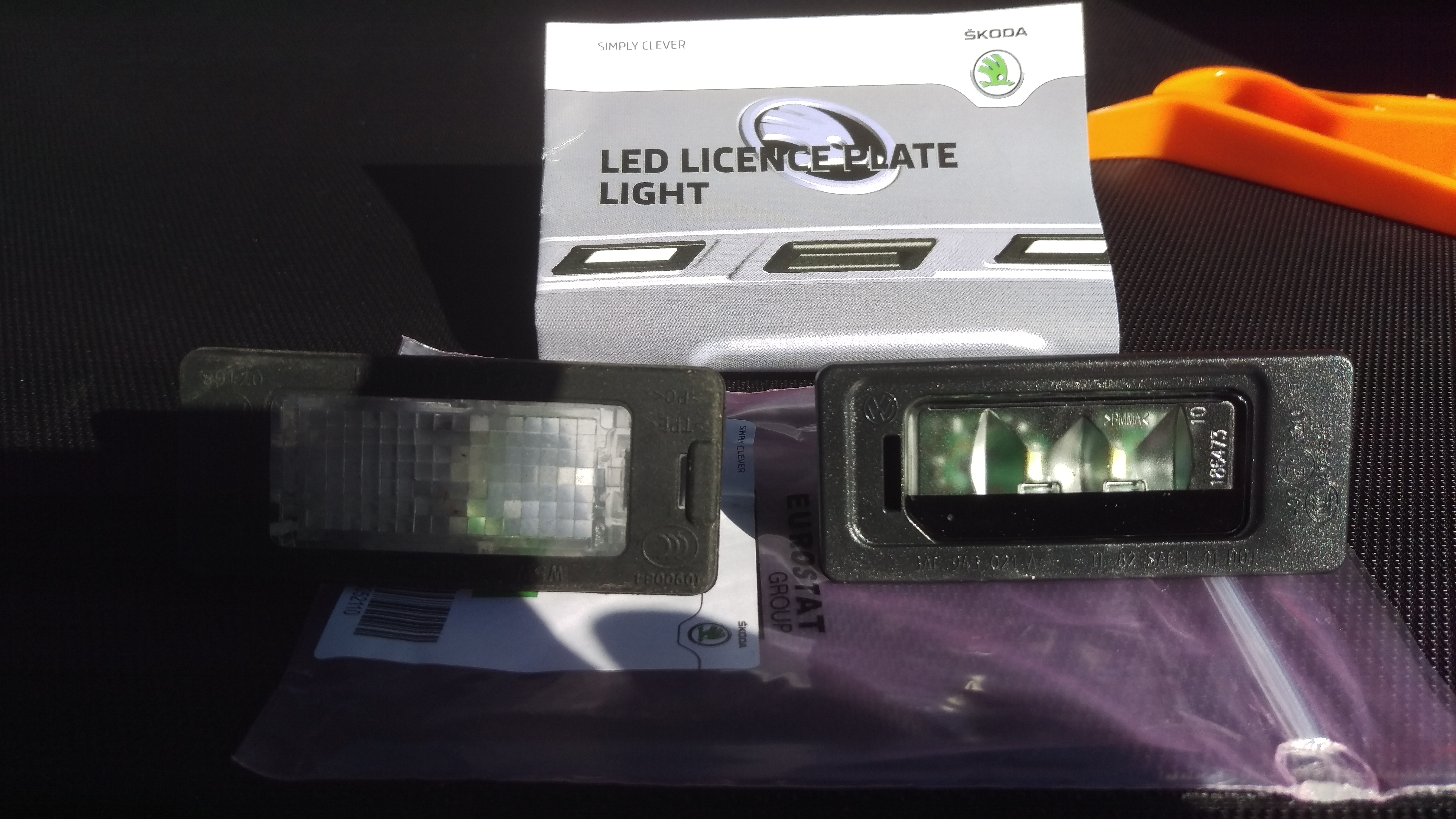

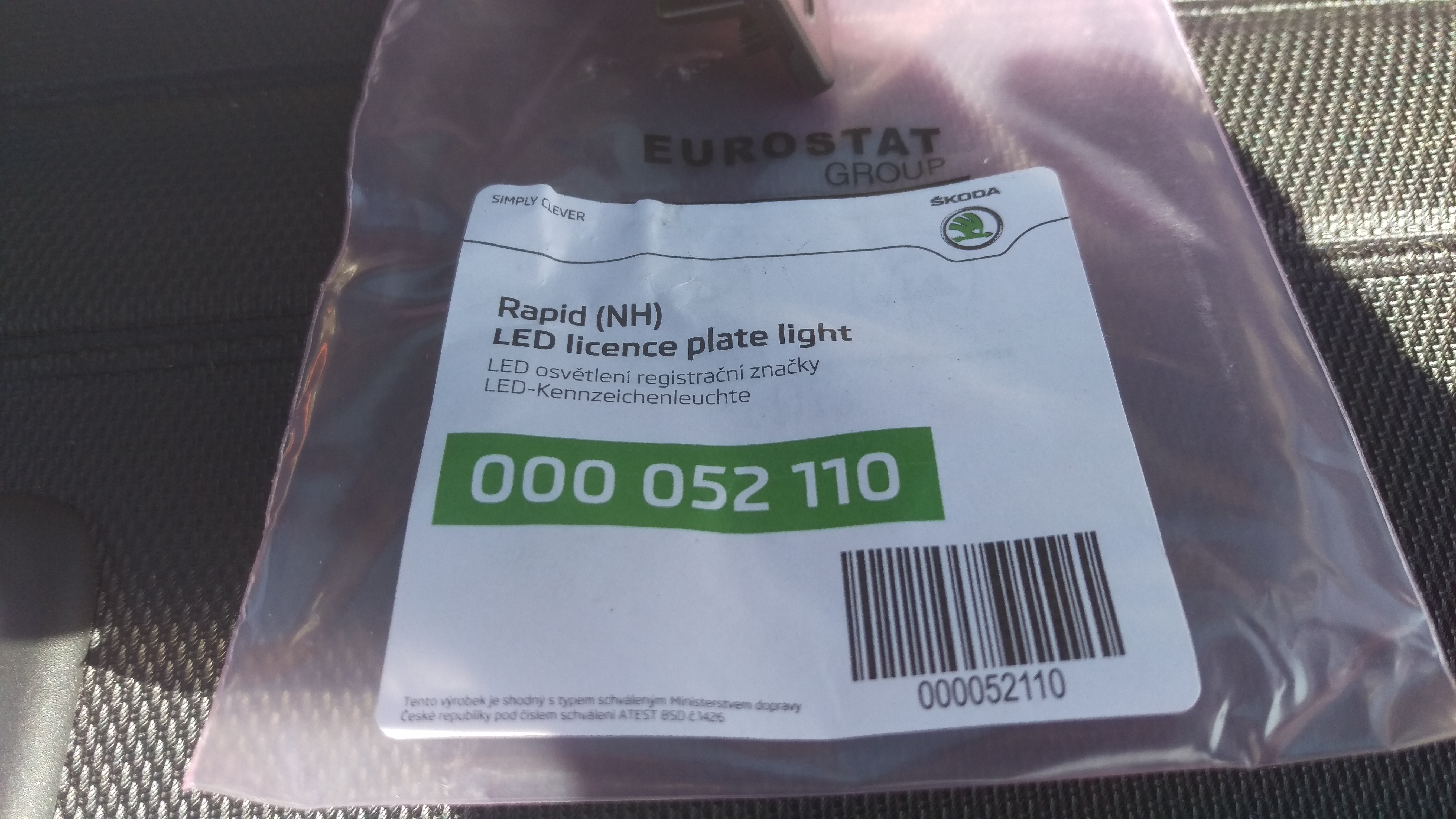

I installed LED number plate lights on my 2015 FL combi.
Part numbers as per attached pics.
Coded using VCDS :thumbup:

I bought the same kit as Jonny5ive. I didn't have a picture of the original package so I read the part number on the light. I guess Skoda put their own part number on the VW light?

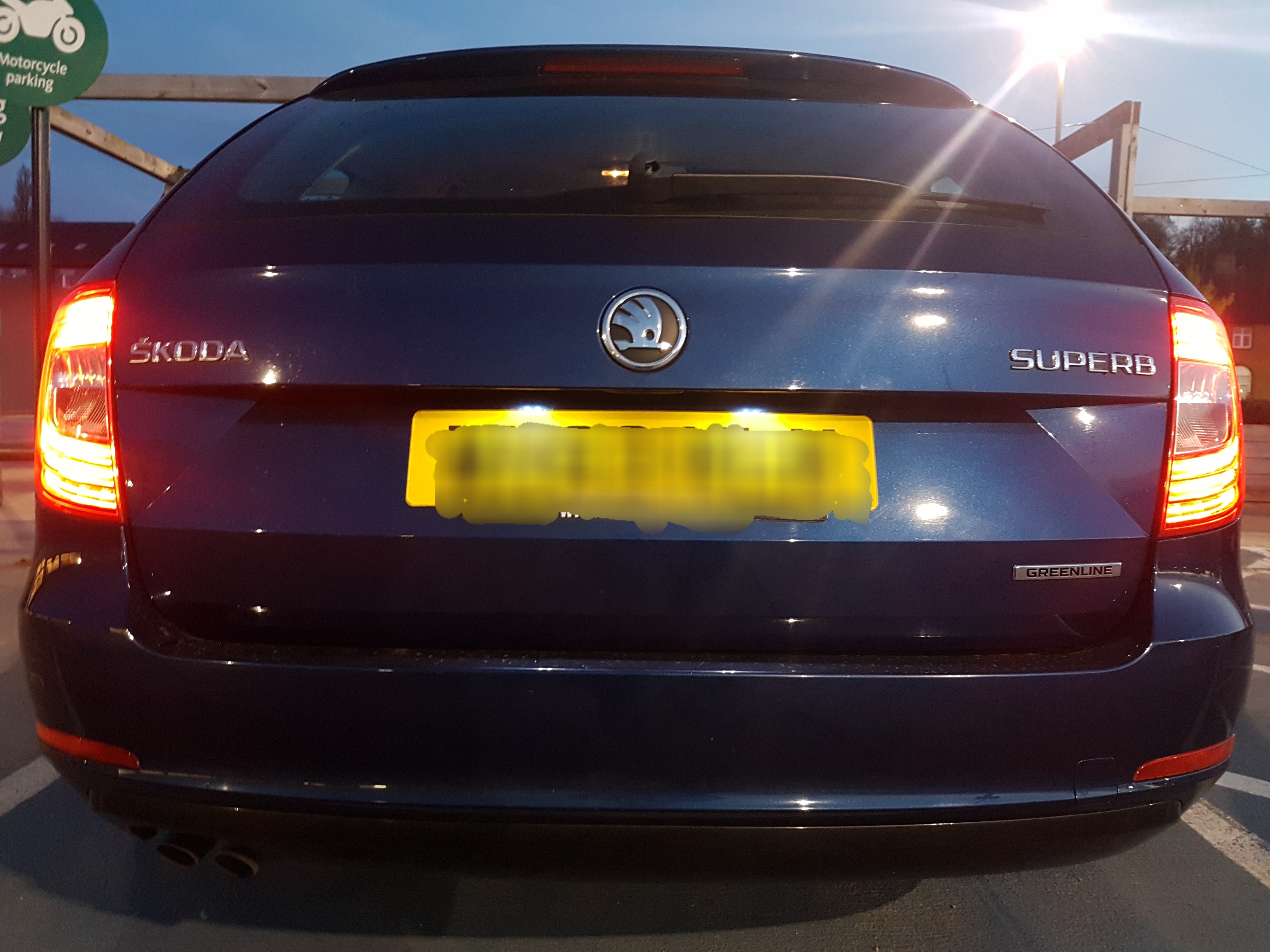

Coded and fitted today, working with no fault codes so I'm a happy boy!
One question, which orientation do you have them fitted? Is there a wrong way? I have them with the part number text the right way up when looking straight at them with the boot lid up.

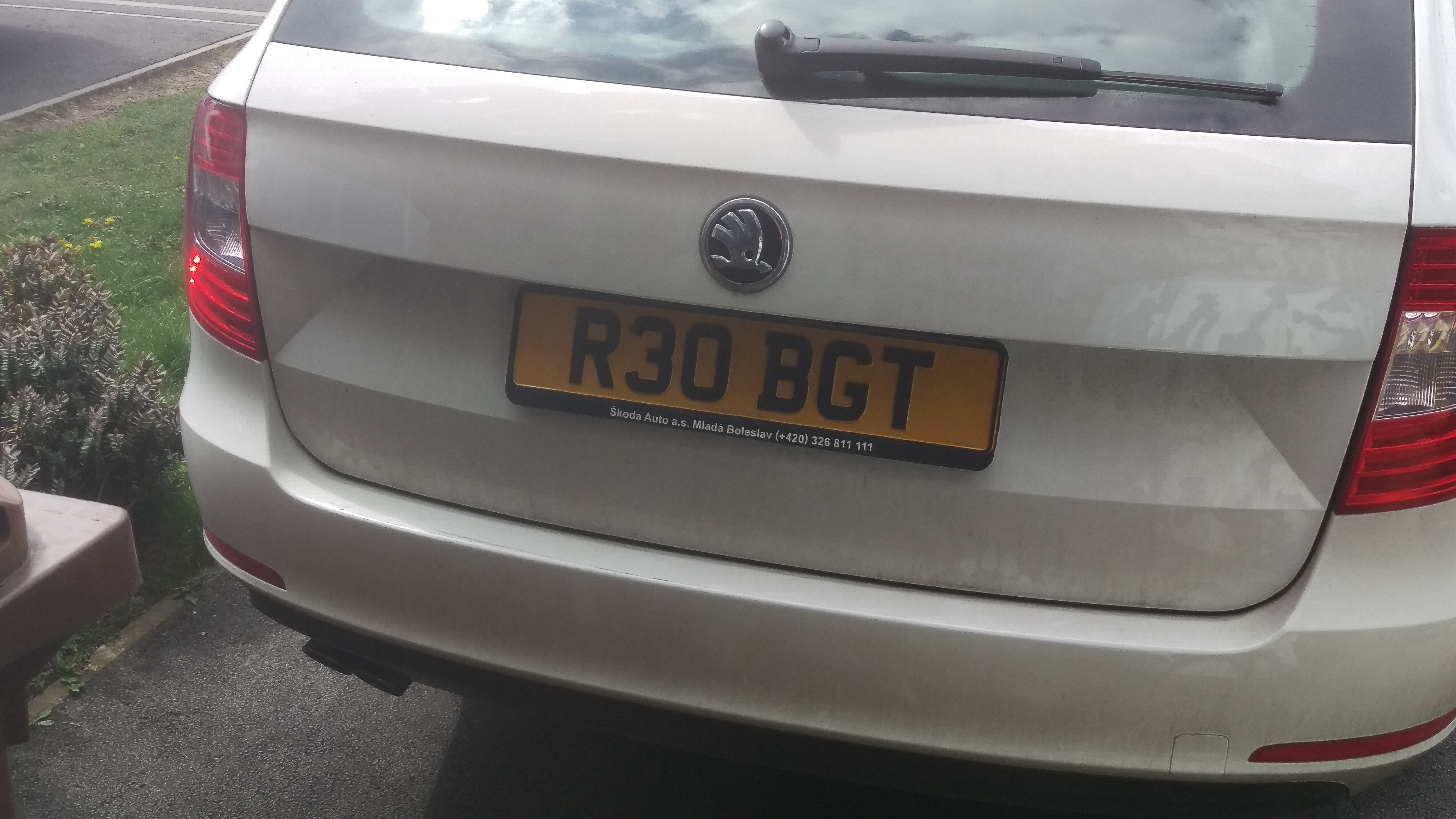

Looking good. A nice set of pressed plates and a de-badge to finish off nicely
I couldn't never debadge and even a pressed plate makes my 'oem ocd' go a bit funny :blink:
The LED lights were a big enough step :D.
The pressed plates are not completely out of the question though, they do look good.
