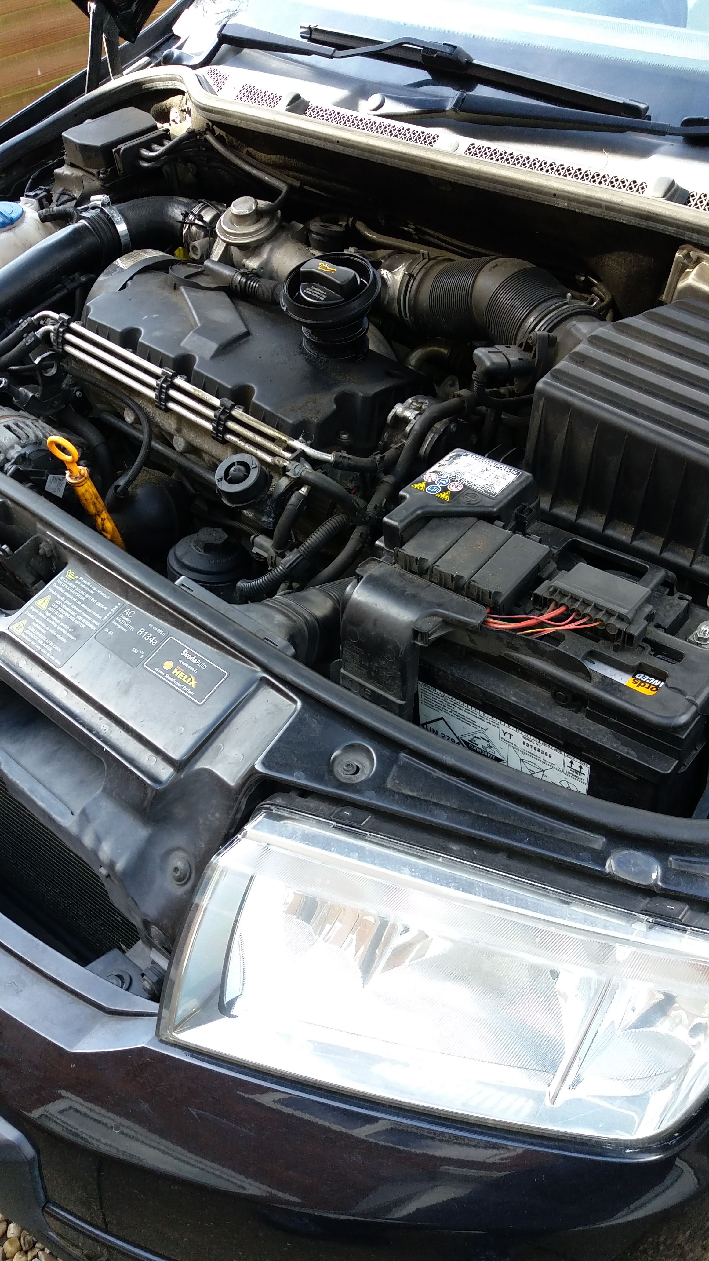

Have a slight leak on the coolant system traced back to when the heater is engaged.
It appears there is a leak when up to temperature, the unions that run from the block to heater matrix pipes in the bulk head located behind the egr, wrap.
Has anybody on here had the same issue and is it a relatively easy fix?

Access to these unions is really tricky, if you search this forum however you'll find various fixes detailed from enterprising individuals who successfully repaired the issue.
