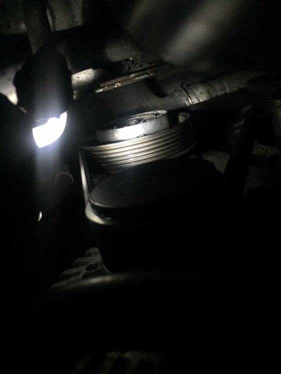

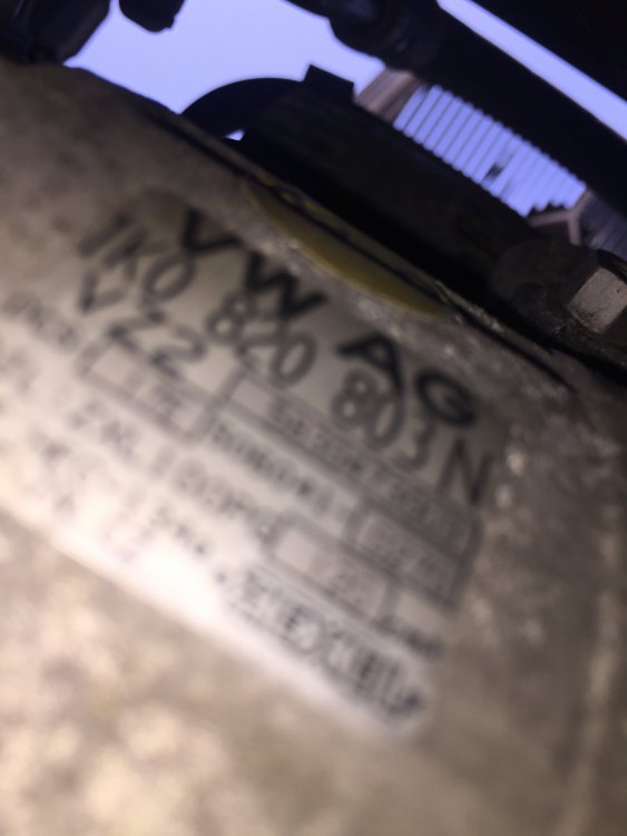

I had exactly the same on my VRS a couple of years ago.
It was the N280 valve on the compressor, it being a Valeo one I could not find a replacement valve , so I had to fit a new compressor, and it works fine now.
Had the shut off code as 0.0, so the compressor is working as far as the HVAC ECU is concerned, but In actual fact the air con in not working, not even the fans kicked in.
Hope this helps,
Trev
Hope this helps,
Trev
Thanks for the input Trev was your refrigerant pressure low too?
No mine was spot on with refrigerant pressure.
If the compressor has gone they recommend changing the condenser too, done mine this time, as I could not get the drier pack from the dealers.
Trev
